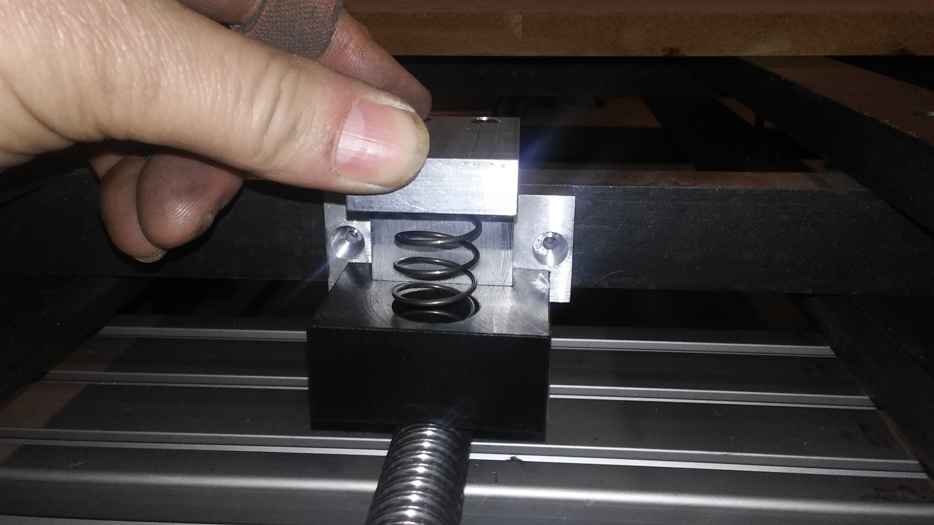

had a chance to put some power to this build and i was thinking the Z axis was going to be pretty slow with a direct drive but i was wrong there. the Z axis is down right fast for a stepper system. i was trying to get it to stall but it just kept giving? the cross axis did about as good as i was thinking but the long axis ran into some screw whip pretty quickly. so i have to see if i can find a solution to improve that axis.
driving the nut would be a solution if i had room but i think that's going to be difficult with how the frame is built. i do have another idea to would work good with how my frame is built so i have to play around with it a little bit to see if i can make it happen.
- machinedude
- Posts: 715
- Thank you received: 312
10 Mar 2020 19:41 - 10 Mar 2020 19:41 #159727
by machinedude
Replied by machinedude on topic just another plasma build

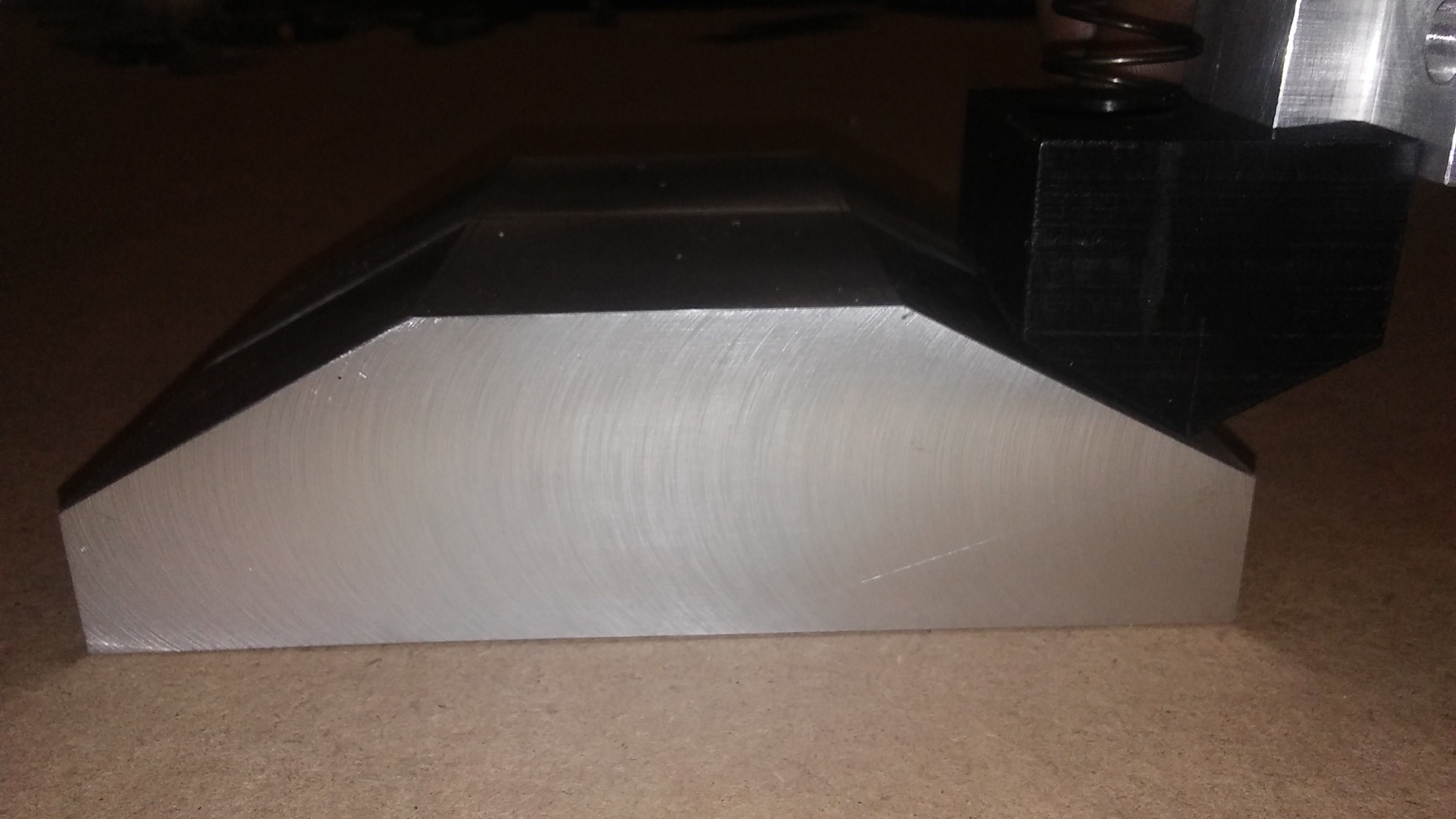

had some time to mess around with a way to control ball screw whip and this is the direction i am going with a solution. the plan is to come up with a way to support the screw and also allow the gantry drive beam to pass under it. the system i came up with should let me add as many as 6 guides but i know for sure i will need at least 2 of them if they work well?
what i have is a spring loaded guide that is located on a dove tail joint that locks the screw guide in on the side to side and the spring provides some tension on the top of the screw to act as a dampener for the screw. when the drive beam approaches it has a entry and exit ramp to push the guide up the dove tail to get it out of the way and the spring pushes it back down the exit ramp as it passes under the drive beam. the guide works well on the dove tail end so i think i am good there but i still have some work on the mounting part and clearance for the ball nut and ball nut housing still. I might loose a little travel on the long axis but if it works i don't mind the trade off for the gains.

Why don't you look at a rotating nut design? Its very easy if you make a hub containing a bearing that goes around the nut. That way the alignment can't change. There are a few examples on cnc zone. Here is one with a drawing
