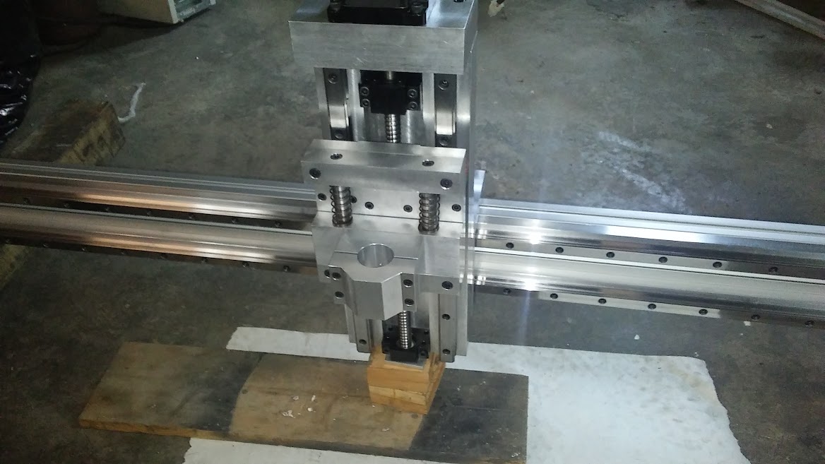

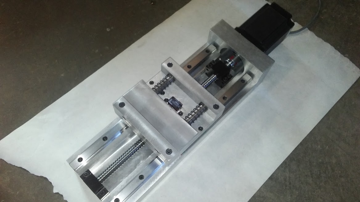

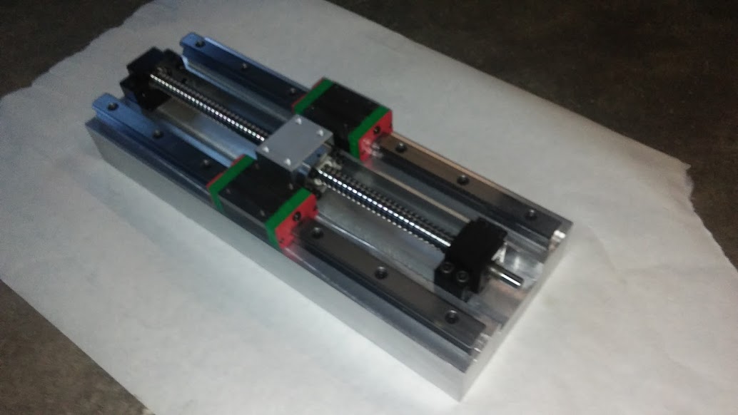

i just figured i would post some build log photo's over here since this looks like the way i'm going with controls at the moment

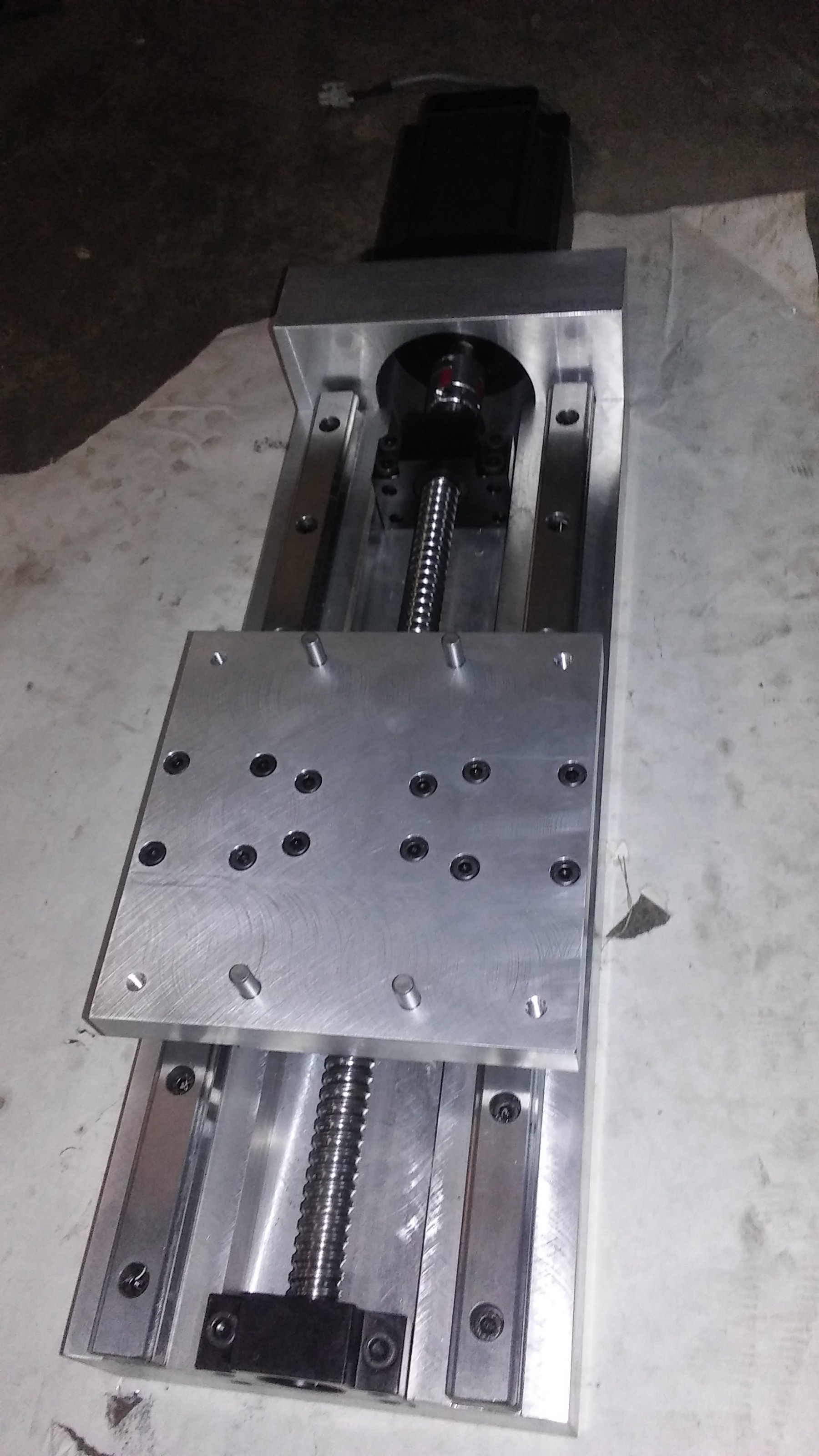

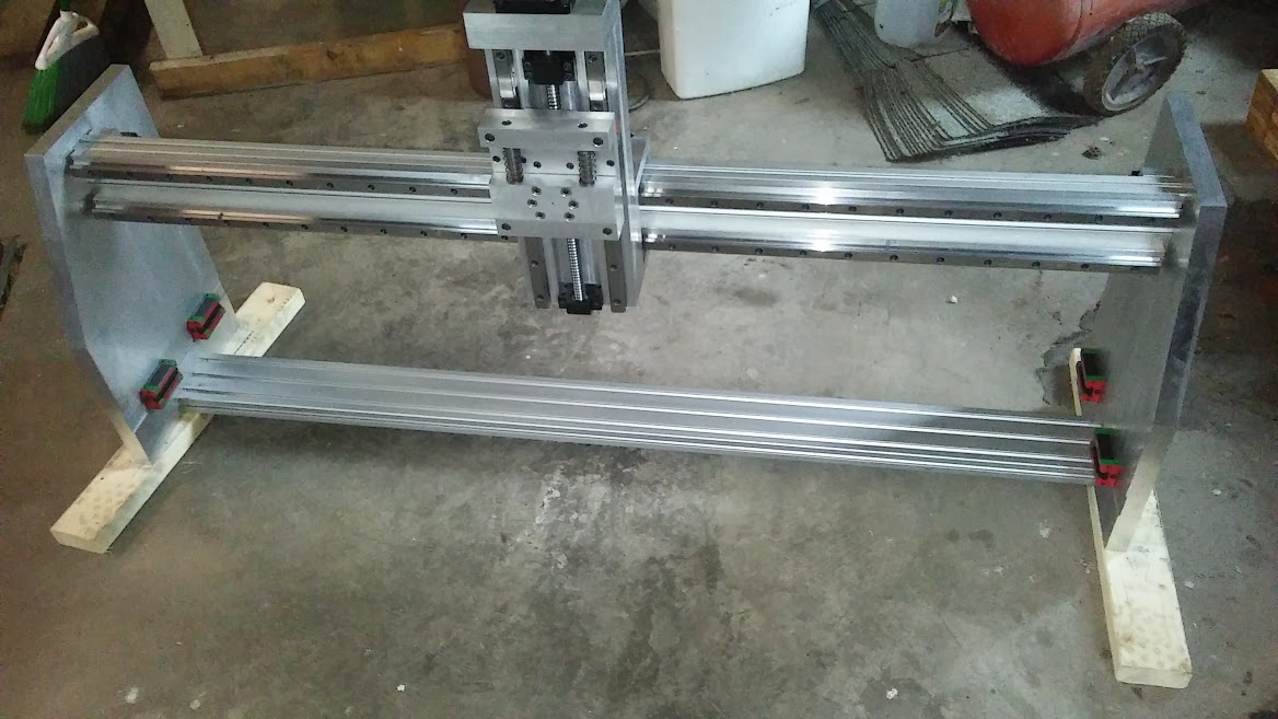

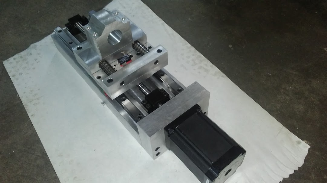

just some more pictures since everyone likes pictures
- thefabricator03
- Visitor
09 Sep 2019 02:28 #144567
by thefabricator03
Replied by thefabricator03 on topic just another plasma build
Thats a very well made Z axis, What thickness do you plan to cut? And how often?
I have really gummed up a Velox Z axis due to my water table spraying up water mixed with metal dust. It made a mess of my ballscrew and caused the axis to bind. I only solved the problem by enclosing the ball screw behind bellows.
- machinedude
- Posts: 715
- Thank you received: 312
09 Sep 2019 02:33 #144568
by machinedude
Replied by machinedude on topic just another plasma build
i am limited to a Hypertherm 45 xp so 1/2 is the limit on a pierce for that unit.
i plan on making bellows out of ballistic nylon to seal everything up and protect everything. the z axis i will cover up with a sheet metal cover to seal that up as much as possible. the long axis i will drive from the bottom and the water table will cover the ball screw on that axis and i will have to see what i can come up with to seal the rails on the side.

by thefabricator03
I had problems with water on the side rails as well. In the end I made the frame cover the bearings at the top and made sheet metal covers on both end to stop as much water as possible.
I also use double seals and a scraper kit on all of my bearings. Really helps.

i knew going into this build i would have to seal everything up as much as possible to protect the expensive parts. bellows are flat out expensive to buy out right so i came up with a plan to make them myself. will take some time but i have more time than money so that's how i ended up with that plan
this entire build has been about precision. so having said that my table will be bolted together and machined so i can keep it square from the start. the only way to make a welded table flat and square is to machine it back that way after welding. being a machinist for the last 30 years has taught me all about what happens to metal when you throw that much heat and stress into it

I brought my bellows for a manufacturer in china, I found them on Alibaba. Cost about $95 AUD shipped for the top and bottom bellows on my z axis. They made it custom to my dimensions.
It is made from flame proof nylon, I have not had any problem with it and I cut a lot of heavy plate so lots of sparks.

might end up being a duel purpose table. being able to add a router would be a plus so that was a factor in design. versatility is what i am after
