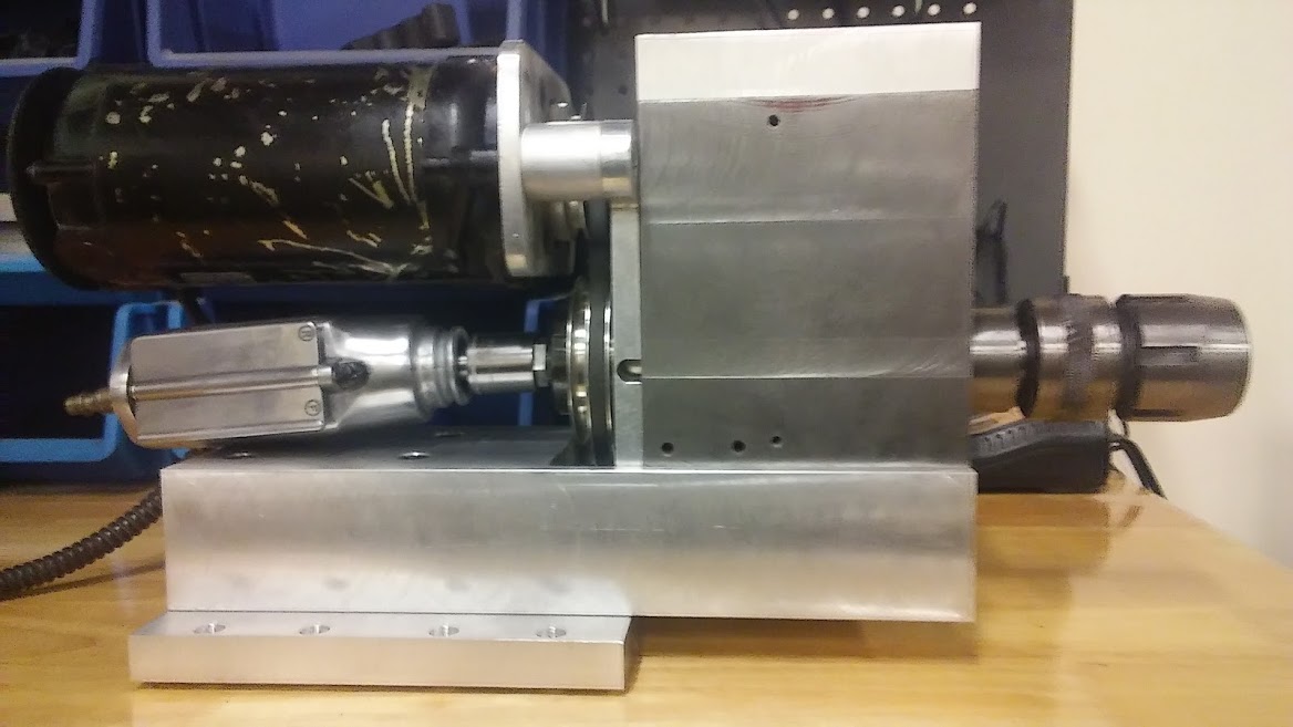

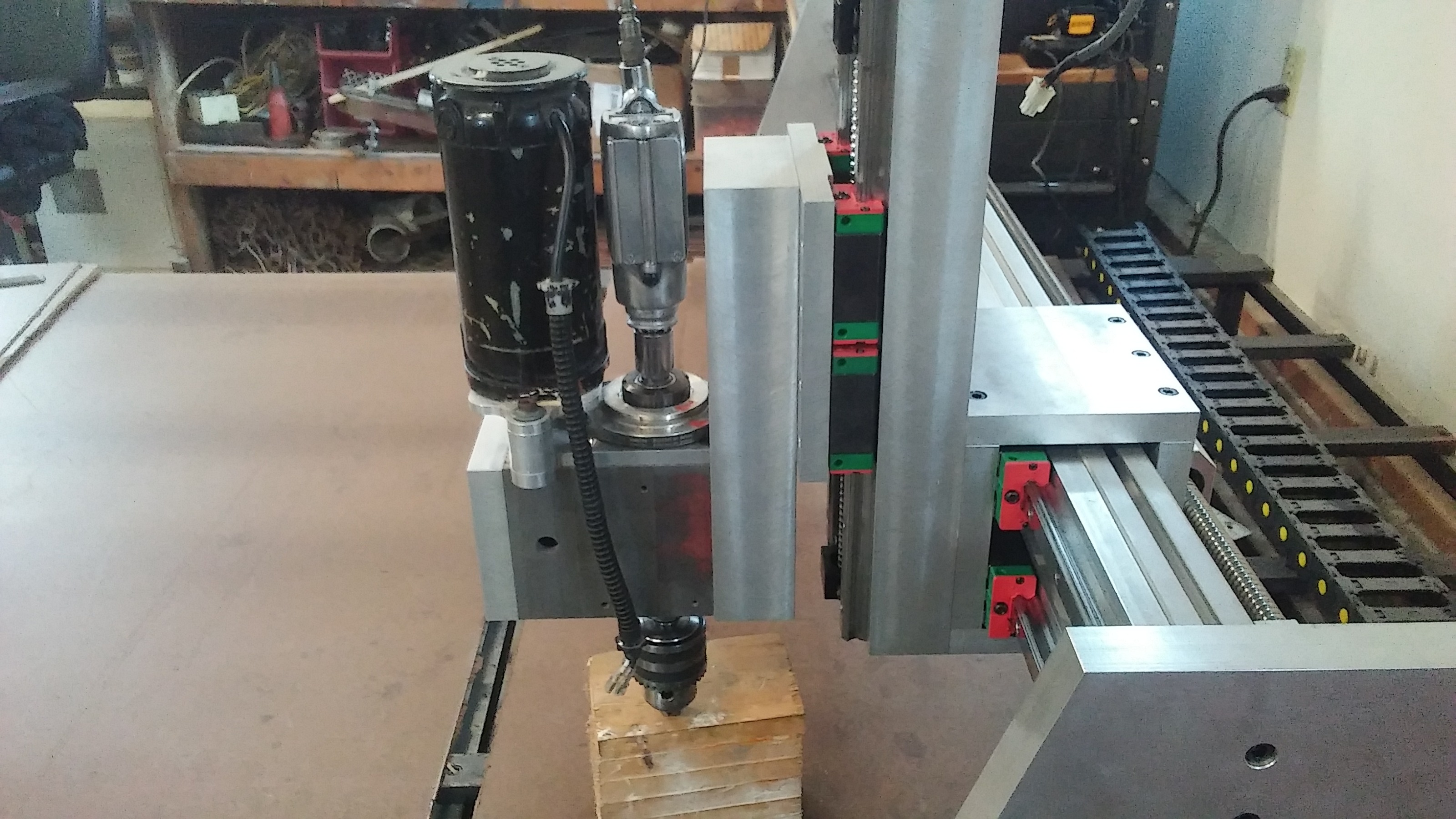

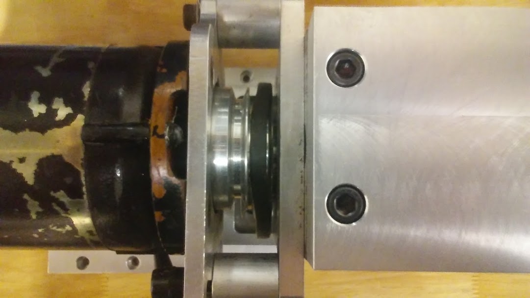

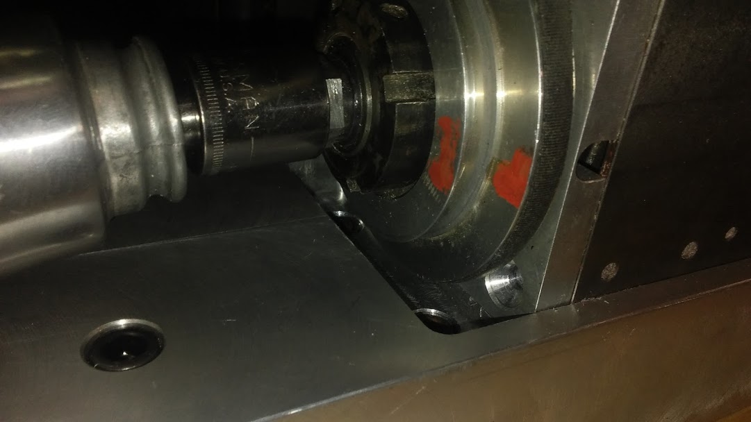

so you see people putting air drills on Plasma so i figured i would make gantry mill head to mount for large work from a mini mill spindle i had sitting around doing nothing
first stab at it was not that great since the spindle center line was to far off the Z axis so i got creative and spun the entire thing 180 degrees and cut that distance in half so it now sits about 4" off the bearing blocks for the Z axis.
not sure how well it will work but figured i would see if i could get it to work for something useful
i had this on a T slot fame machine and got it to cut around 28 IPM with about 1/16 step over in aluminum but was not happy with the light T slot frame.i think this spindle will do better on a decent frame with some weight to it.
it was free so might as well play around with it and see if i can make use of it.

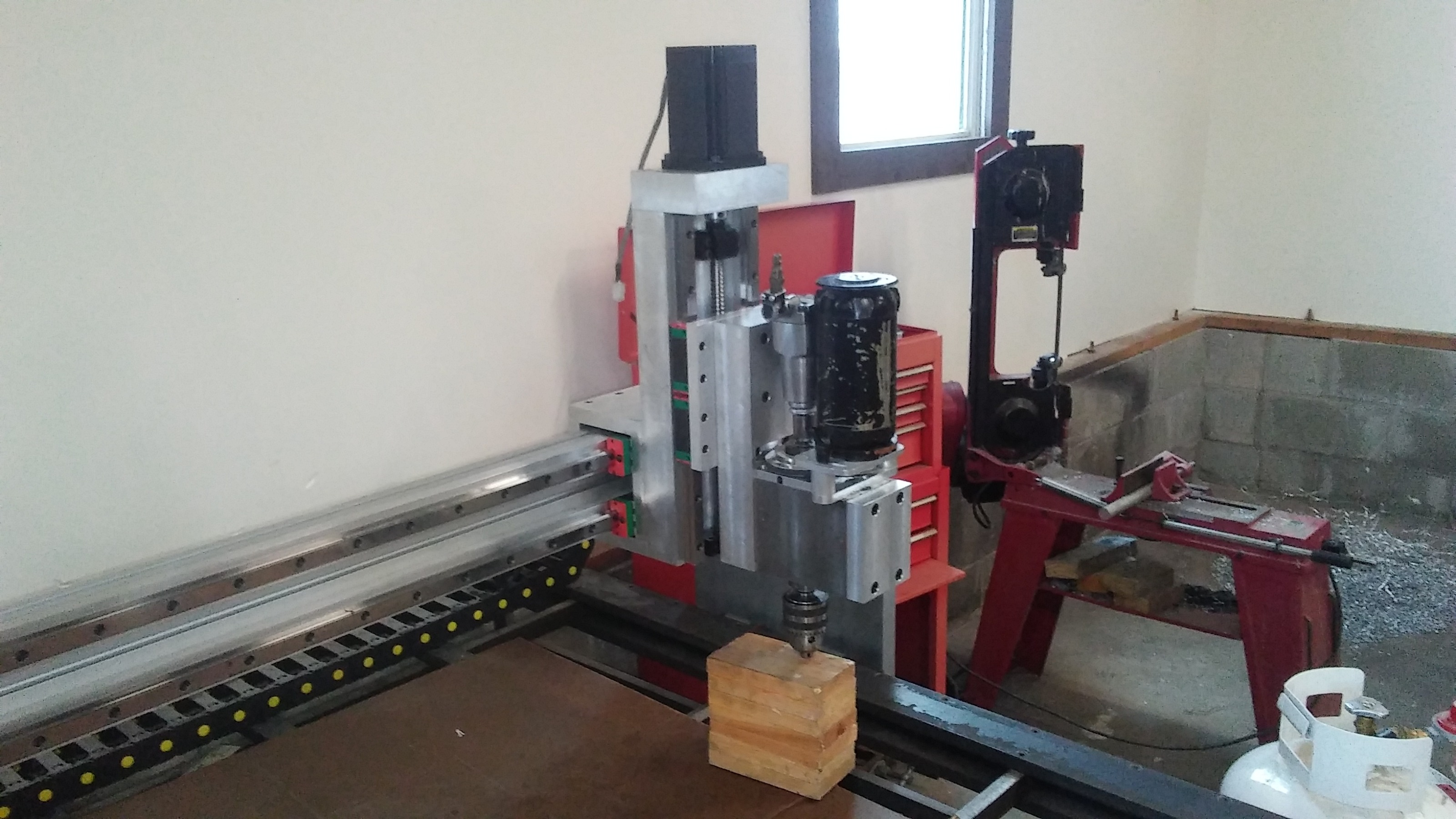

re worked a few things to see if i could give this thing the best chance of working well and after spending another day messing with it it's a little closer to being something useful but i think the weak link is the T slot extrusion beam across the table. i had the Z axis completely off the machine and had it in a vise on the bridgeport and that end is solid. i get some deflection once everything is on the cross beam. i have one other thing i could try to make the cross beam more solid and i am sure it would help some. only down side is adding more weight to the gantry in the process.
weight is not an issue with the mini mill head i had it going up and down the axis with a cordless drill with the clutch on the lowest setting and it work fine here with no issues there.

the other thing i was thinking about was the fill the hollow voids in the T slot cross beam with epoxy granite. if this would be enough to fix the deflection it would have an added bonus of vibration dampening on top of that which would be a big plus for this kind of application. i know the T slot is going to resonate a lot as is. i doubt the little bit of cast iron on the spindle housing will dampen much.
i have played around with epoxy granite and it is pretty amazing how much it deadens resonance. the compression strength is about the same as concrete but the material only shrinks about a .001 (imperial) and .03 mm for you metric folks
