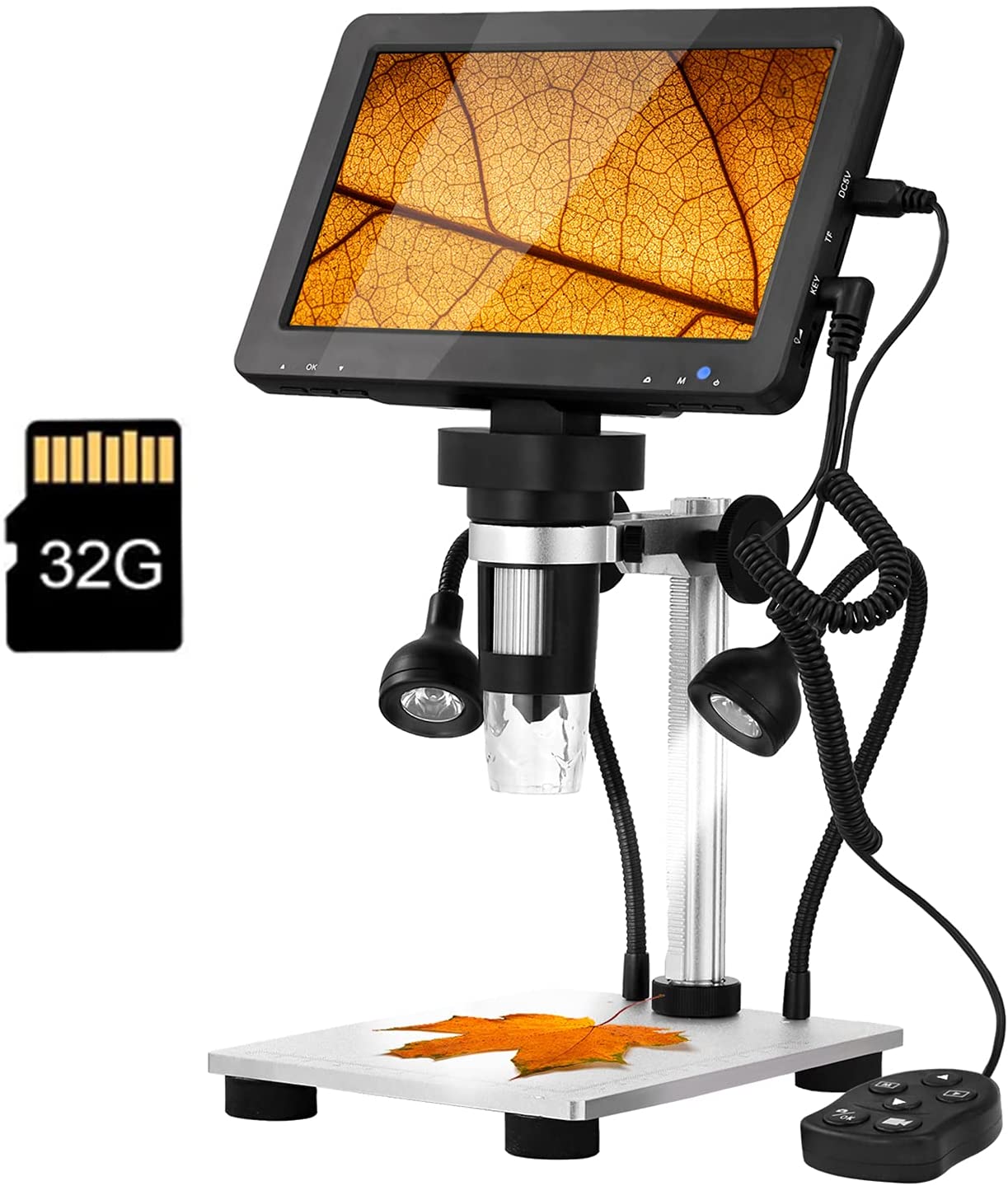

one of the other issues i was having is getting the rails set on the side of this build. that part got about as sideways as sideways can get when you are trying to get a machine bed flat. they sell expensive laser leveling systems for this sort of thing but they cost several thousand dollars so that was out of the question for me.
i did some digging and seen some people have used a wire method with the wire under tension to get a datum plane to work from and using a loupe to see things better. so i took that and made my own spin of the process.
i was going to use .009 music wire until i started to price it and ended up using Nylon upholstery thread instead since it is cheap and only about .007 in diameter. and rather than using a loupe for magnification i bought a digital Microscope with a 7" screen. the microscope was rechargeable and had better magnification. the contrast of the of the thread color plus the magnification worked well for dialing things in. the microscope was about $100 but worked well and did not break the bank in the process.
i was able to get things flat within about .003 per 30" with a straight edge and feeler gauges which is not to bad. 2900mm long rails basically suck to get straight when you loose your datum point but this got me back on track at least.

I have the exact same microscope. I am very impressed, and highly recommend them. Now I can read the print on SMD components again.

I have one here too. The price is quite crazy low for what it is.

actually using these for electronic board repair is a common use for these microscopes. some of these actually have software that will measure part features but i think the software drives the cost into the $300 to $400 price range? i did not play around with the software included with this one so i don't think it does this but other brands have this function from what i could tell.
