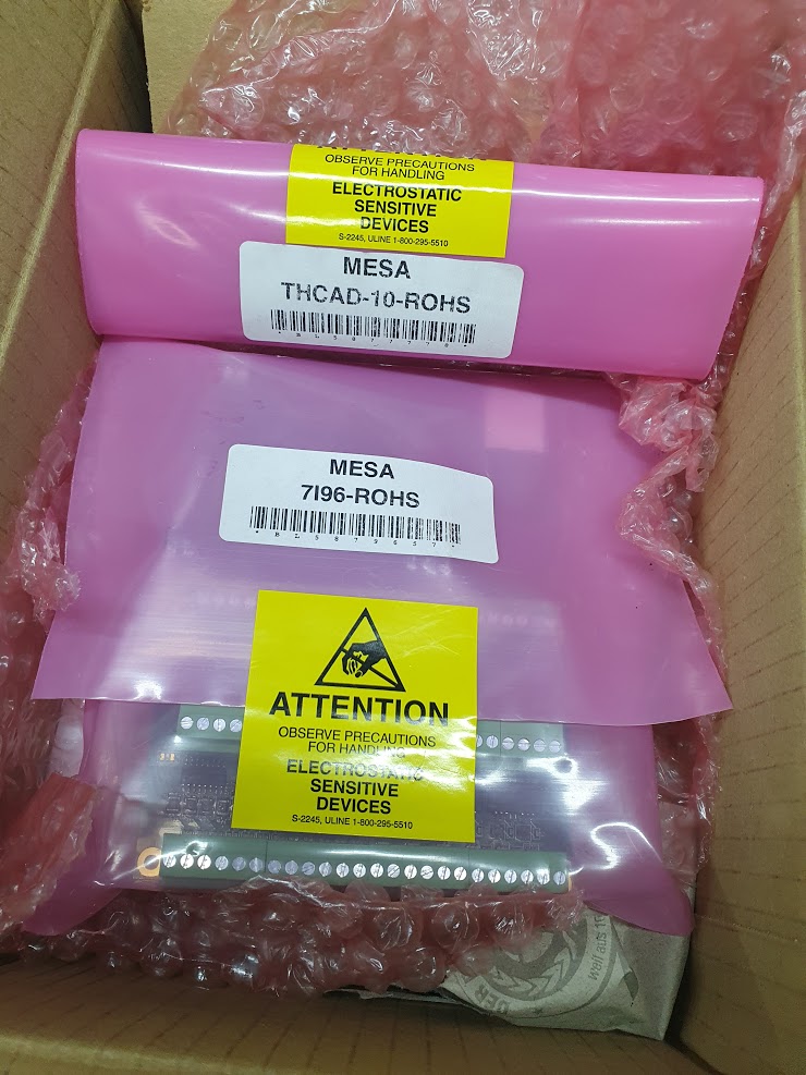

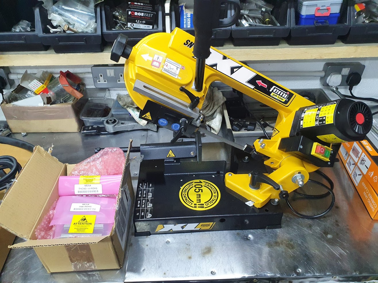

- WinstonTodge
- Posts: 37
- Thank you received: 11
24 Jun 2020 07:33 - 24 Jun 2020 07:34 #172536
by WinstonTodge
Replied by WinstonTodge on topic 1.2m x 0.6m plasma, <£2k questions!:
Got the first deliveries! Now waiting for the steel, rails, fixings, motors, drives and a bit of time!
Treated myself to a new bandsaw too. Small but well made and capable.
Update to follow soon, I hope.
Ta all so far!
Ta all so far!

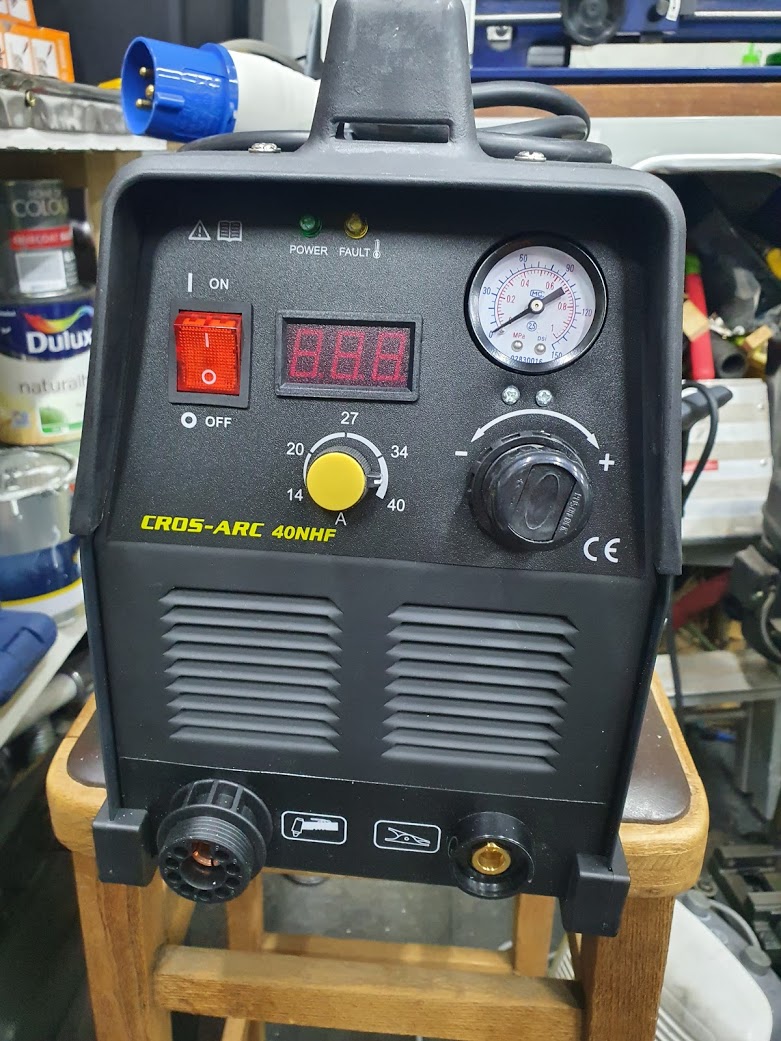

- Clive S
- Posts: 2204
- Thank you received: 486
24 Jun 2020 07:56 #172538
by Clive S
I have the Cross air 40 as well. It works well. I had to use a reed switch for the arc OK
Replied by Clive S on topic 1.2m x 0.6m plasma, <£2k questions!:
Ta all so far!
