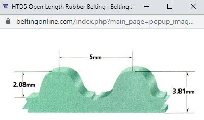

As a general rule, use "rounded" teeth belts/pulleys, the "sharp corner" ones vibrate a lot.

Thanks Tommy,
Just added some HTD5 14 tooth pulleys and belt to my basket... :)
