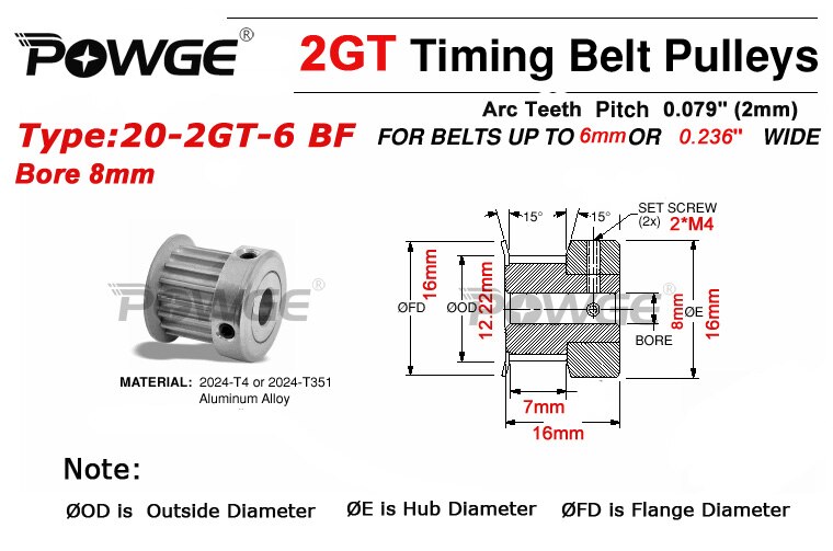

On pulleys the outer diameter is useless, the important part is the pitch that is 2mm for GT2 and 3mm for HTD3 and 5MM for HTD5 etc, and the number of teeth.
So a 20 tooth GT2 will move 40mm for one rotation, a 15 tooth HTD3 will move 45mm for one rotation etc.
Drives that do proper microstepping can work even with bigger pulleys, the resolution and repeatability will suffer a bit, but still good enough for hobby plasma cutting.

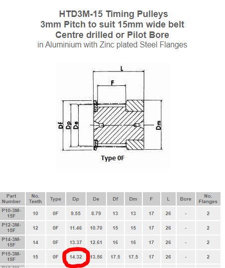

Thanks both! When I say OD, I mean pitch diameter.
Your examples make sense Tommy. 38.39mm for the GT2 and 44.98mm for the HTD.
News to me too, on the pilot bore rodw, thanks for that. Will use the lathe to sort to 10mm ID.
With a 30.6mm PD and 3:1 reduction, you'll have around 32mm per revolution. What microstepping, motor, torque, maximum velocity, etc variables did you use to settle on 32mm?

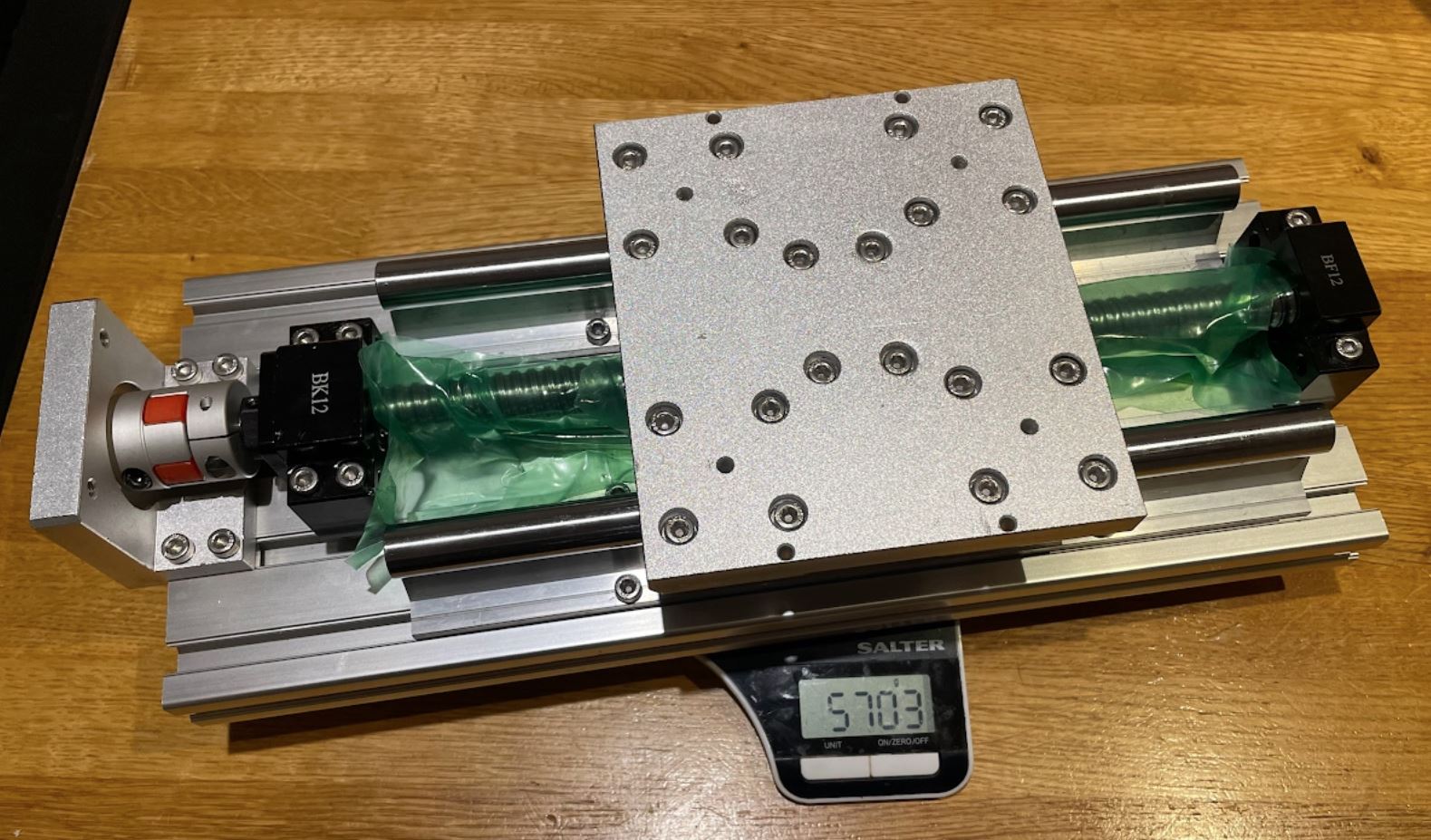

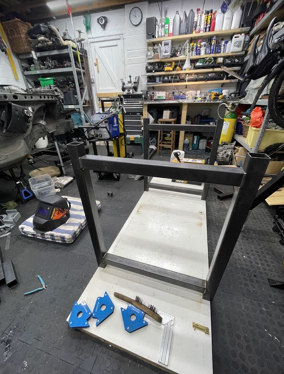

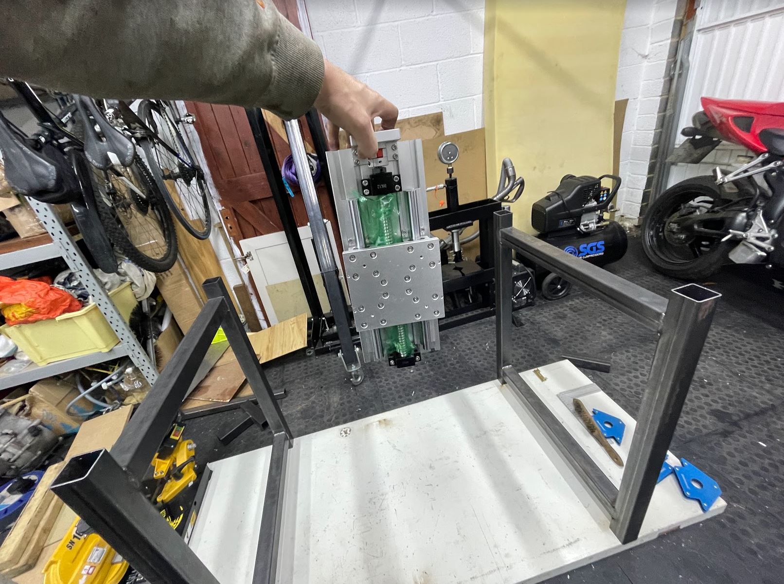

Well I'm back to it after such a long break... Real life getting in the way again.
I've started fabricating the frame tonight and am starting to think that my z axis linear stage at 300mm 1605 ball screw is a little over the top! It's 5.7kg! I've got some 425 ozin NEMA23 to drive the Y gantry. Will I need to put the stage on a diet?! Or just limit accelerations / decelerations? I'm not worried about ultimate speed of cut, just accuracy.
Still need to get some belts and pulleys...
Last edit: 12 Dec 2021 23:33 by WinstonTodge. Reason: Insert pics.

Replied by rodw on topic 1.2m x 0.6m plasma, <£2k questions!:
Yes, it will be fine with 48v power. They are surprisingly heavy.
Just watch the rubber insert in the coupler. I checked mine the other day and it was gone! Wasn't a cheap ebay one either!

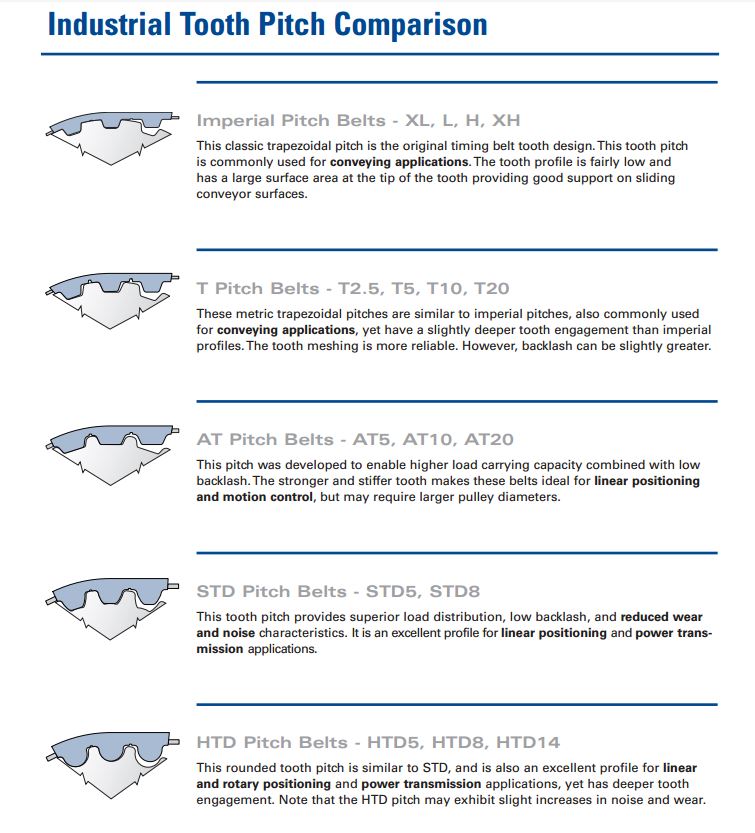

Just putting this here, as some really interesting tucked away in there...
file.lasersaur.com/docs-thirdparty/The_W..._of_Timing_Belts.pdf
And this was a nice top level summary...
