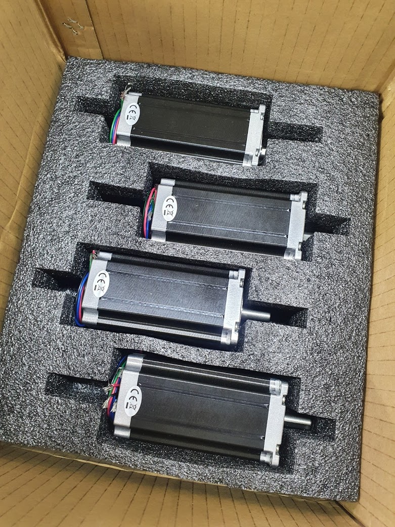

24 Jun 2020 20:21 - 24 Jun 2020 20:22 #172629
by WinstonTodge
Replied by WinstonTodge on topic 1.2m x 0.6m plasma, <£2k questions!:
Next delivery!
And a whole load of steel...
Last edit: 24 Jun 2020 20:22 by WinstonTodge.

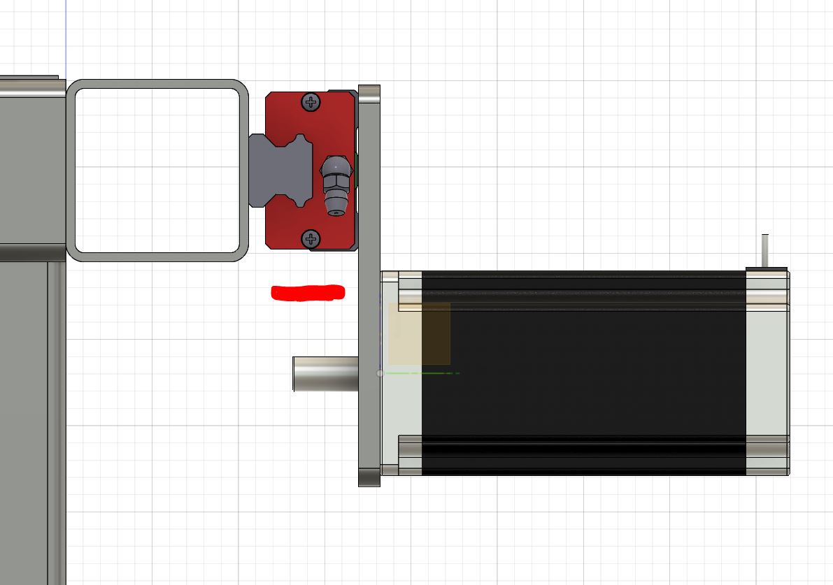

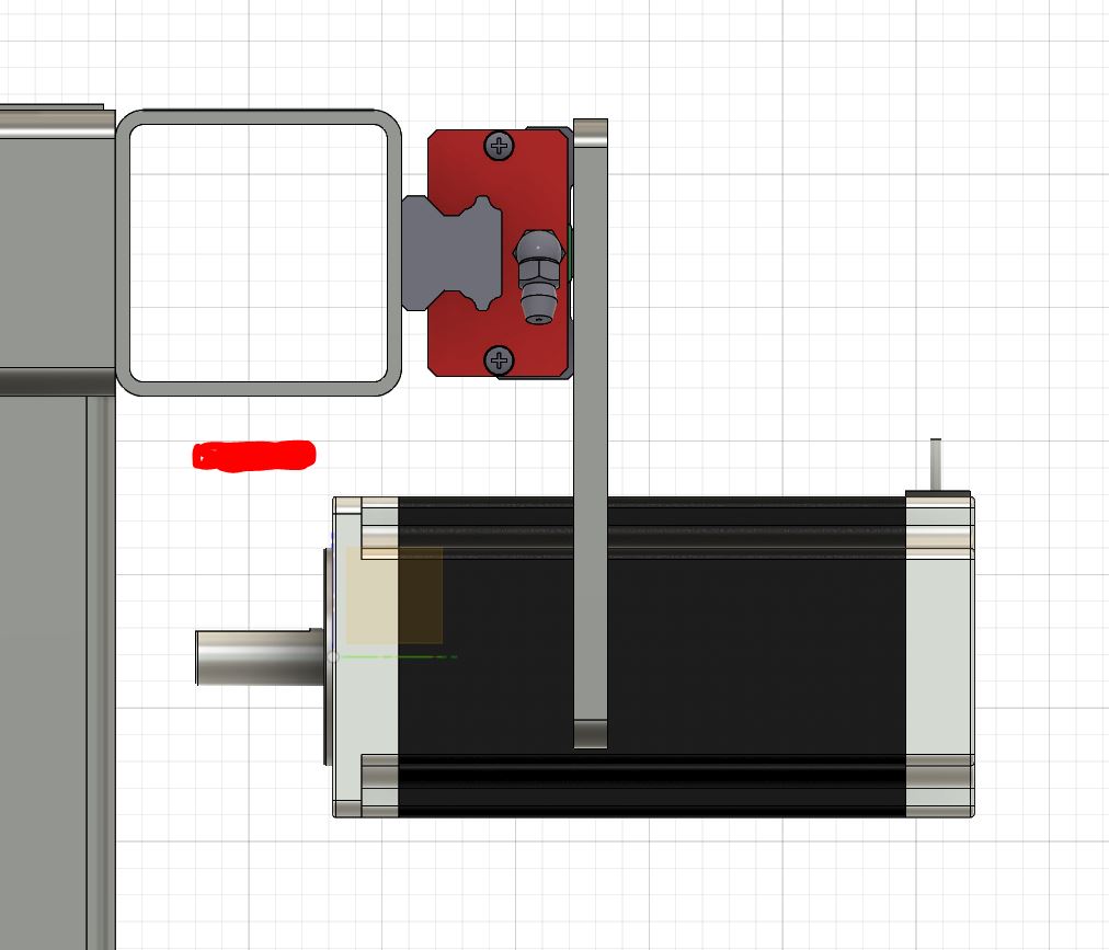

30 Jun 2020 22:30 #173222
by WinstonTodge
So belt position...?
I'm just playing with the CAD for giggles...
Do people think there would be a particularly large difference in performance / stiffness with either A or B belt location for the Y axis?
For simplicity, bolting the motor direct to the carriage plate and running the belt below the linear rail (image A below) would be easier, but can't help but think having the belt directly below the table tube seems a better bet (image B below). B would need an extra plate and mount though obvisously to move the motor inboard...
Thoughts? Or am I just being pedantic...?
Image A...
Image B...
Ta,
Chris.
Image A...
Image B...
Ta,
Chris.
