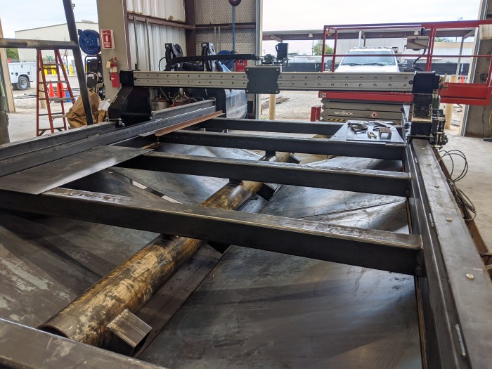

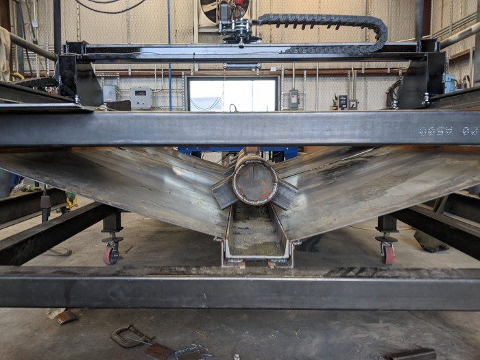

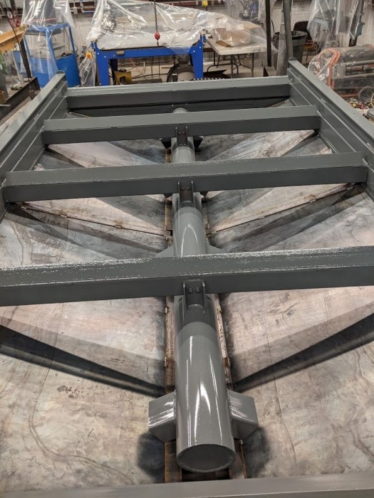

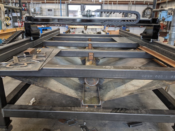

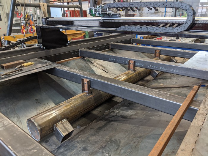

I am trying to find the best type and size fan to exhaust the smoke/fumes/dust from my table. The table is 6x12 and has a v-shaped basin. Suspended halfway between the basin bottom and the cutting surface is a 7" ID steel pipe with 8ea 4" square 'ports'. There is only one outlet on the table located at one end. The table will be situated in my shop in such a way that the outlet of this pipe is 8' from the exterior wall, at 90 degrees from where I need to vent.
I have read good things about backward incline blowers. Any input on what size and type fan as well as connection methods will be much appreciated.

That looks like a really nice design.
This article suggests 3200-3600 CFM for a 4' x 4' table
www.hypertherm.com/learn/spark-the-blog/fume-control/
So for a table that size you would need a LOT of air. 16000 cfm.
Most commercial tables are zoned
Assuming you are going to use Linuxcnc's Plasmac, I would suggest you add an air activated shutter on each of the 8 outlets that is triggered based on the position of the x & y axis. You don't need seperate compartments to contain the air. Better that you don't
so by using 8 zones, you would reduce the air flow requirement to a much more reasonable 2000 CFM
Here is a bit of a rough demo of mine showing how this can be done
You could use two lincurve components with axis.x.pos-cmd and axis.y.pos-cmd as respective inputs but you would need a bit of hal trickery to merge these into a zone. I think it would be a lot easier to write a custom component which is the path I took for the demo.
