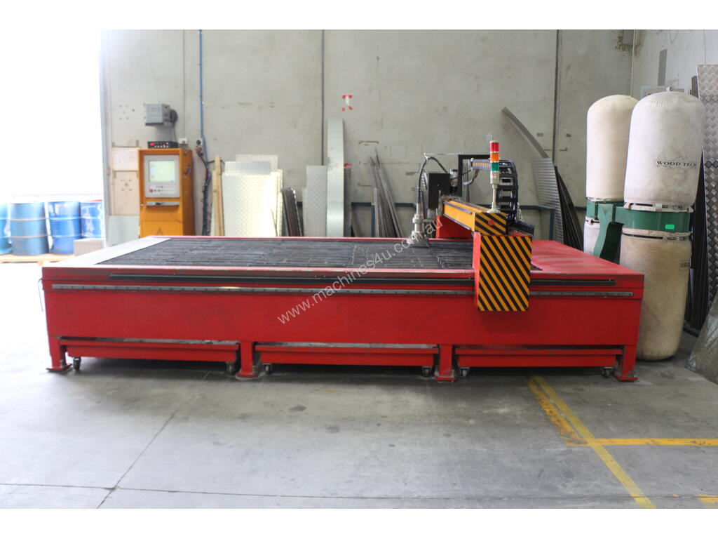

I know your ducting is done but I saw this pic on a machinery sale ad.
I think I'd use a 1 micron pleated filter.
And you can get spark arresters which are cool
www.nordfab.com/en/products/qf-ducting/s...b-in-line-spark-trap

Interesting. Almost all of the duct I bought is Nordfab brand.

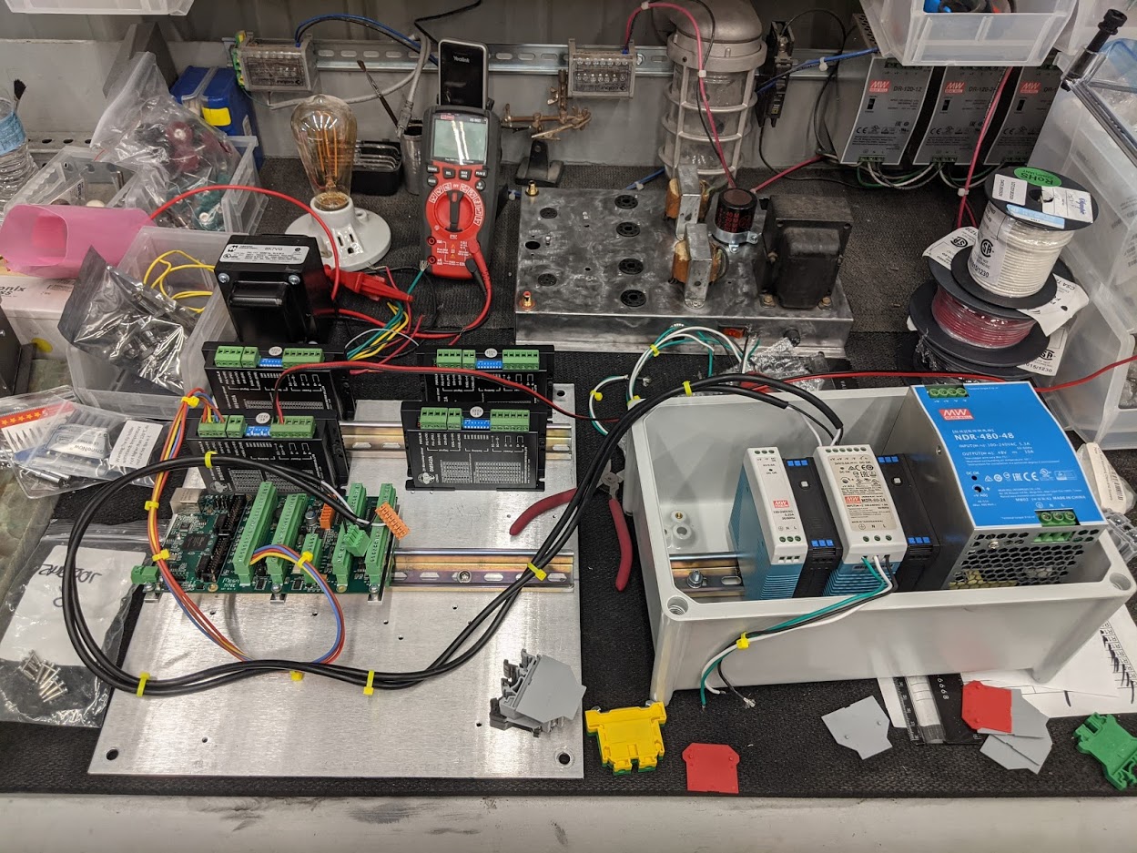

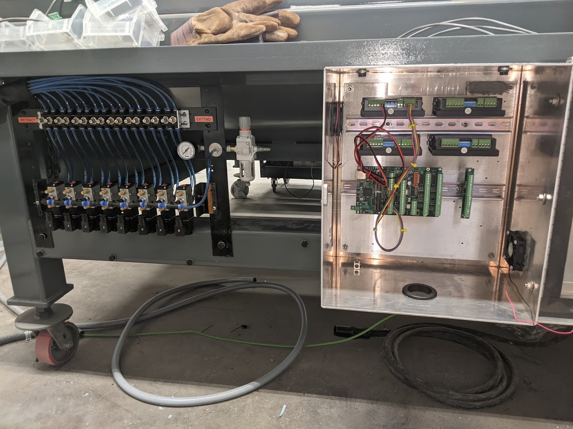

With the blower connected to the duct, and half of the blast gates open, it is pretty amazing how much air is moving through each gate. I am really excited to see how much goes through only one gate!
So the blower, duct work, and solenoids are installed and plumbed. The only thing left is to connect the solenoids to the Mesa card... of course that needs to be installed first.
As you can see my hobbies sort of collided on my workbench.
I did manage to get the power supplies, Mesa card, drivers, etc mounted up on Friday, and some wiring today, which I forgot to photograph. Tomorrow, if all goes well, I will connect the wires from the limit/home switches and motors and probably spend the rest of the day reading the documents on how to configure everything.

Those meanwell power supplies are great, I use them on my machine.
