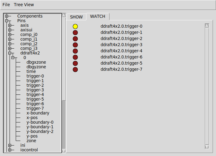

Ok, unzip this folder into your config folder. it will create a folder called gantry which is a basic sim I've edited to be your 6' x 12' table.
Navigate to that folder in a terminal window. typeCheck for errors and resolve or report back
turn on, home all. Load the ddraft.ngc file in the gantry folder.
From the machine menu, select show hal configuration. Select the watch tab.
in the tree for pins, find the ddraft4x2.0 component and click on all 8 triggers (numbered 0 to 7) to watch each pin.
run the ngc file and watch the magic happen!
Next step is to connect each trigger pin to a real output pin. (Remember what I said about diodes). I generally would do it like this:
So if you wish to change the zone boundaries you can edit ddraft4x2.hal file to change them
To go live, copy ddraft4x2.hal to your config folder and edit your ini file in a text editor (I use Geany!) and add it to the [HAL] section
Good luck!

sudo halcompile --install ddraft4x2.compturn on, home all. Load the ddraft.ngc file in the gantry folder.
net zone0 <= ddraft4x2.0.trigger-0
net zone0 => hm2_7i76e.0.7i76.0.0.output-00So if you wish to change the zone boundaries you can edit ddraft4x2.hal file to change them
[HAL]
HALFILE = ddraft4x2.halGood luck!
