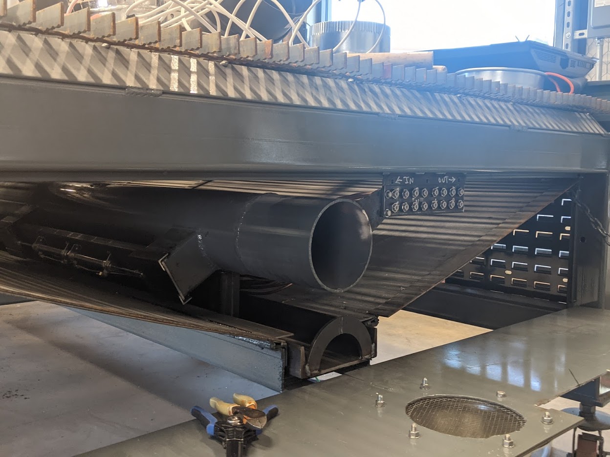

29 Nov 2020 21:11 - 29 Nov 2020 21:14 #190628
by txtrone
Replied by txtrone on topic Downdraft design questions
I saw the one from amazon when I was looking for parts... but figured it would be easier/cheaper to add the gates onto the square tube ports than adapt these. Home Depot sells these for $20 online.
This one is available locally for $15USD ... I almost went with it.
If I was building the duct from scratch (again) I would definitely use circular tube for the ports... there are tons of items for sale to fit the circular duct. We had the square left over and so we used it... sometimes that comes back around to bite!
Most of my searches led to woodworking cyclone dust collectors, but eventually I landed on Donaldson Torit's website for high temp, high load, dust separators. These are out of my price range but they gave me a lot of ideas.
In the end I bought my solenoids, copper tube, and most of the fittings on Amazon. The actuators and some harder to find fittings came from Allied Electronics.
I ordered a Teco Westinghouse 5HP 3 phase VFD on ebay, should be here by Tuesday or Wednesday, for half price... it must have fell of a truck somewhere in New Jersey. I am going to use that for the motor 'starter' ... I wont use most of the features on the VFD, but it will be easy to interface with LinuxCNC and also gives the ability to soft start the motor.
I have been reading the the setup guide for pncconf today. My goal for tomorrow is to get the motors all spinning properly on the old 4x4 table. At that point I may switch over the LinuxCNC setup to the big table aka 'The Mark I' ... gotta take the leap of faith at some point!

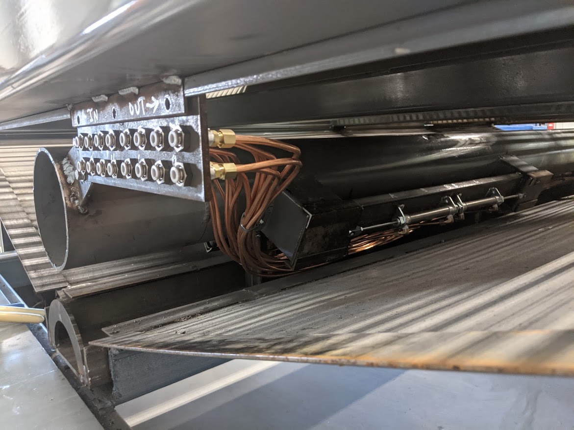

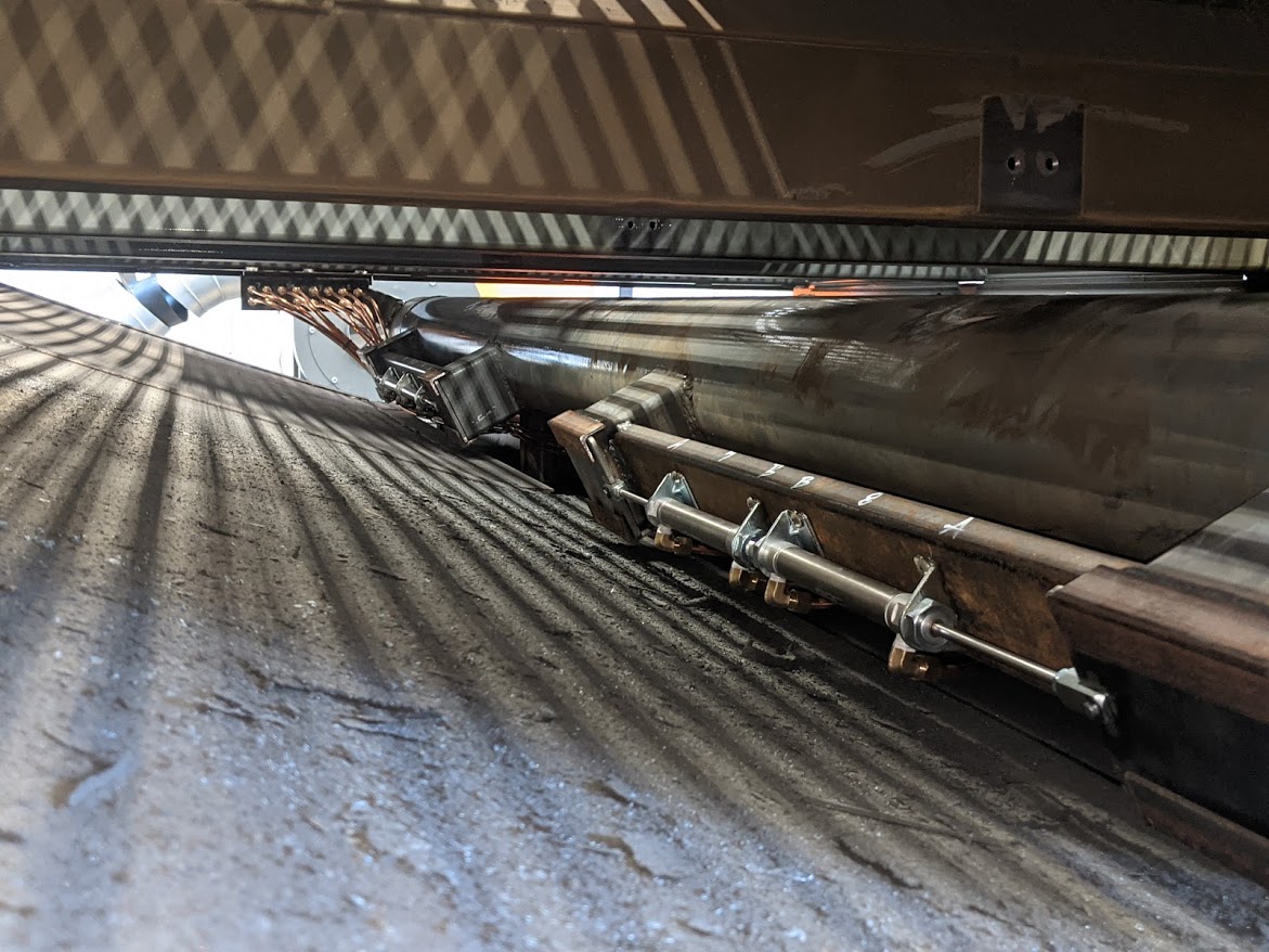

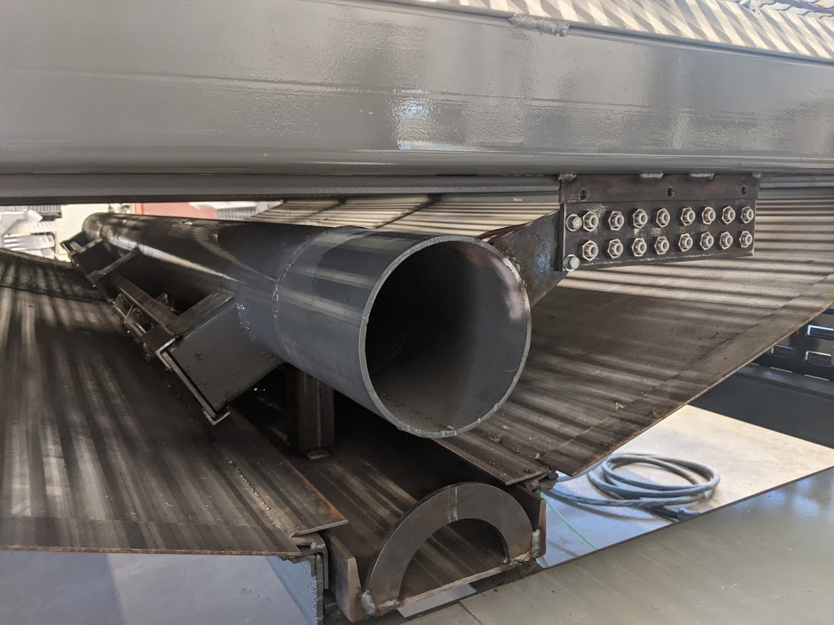

02 Dec 2020 03:10 #190831
by txtrone
- txtrone
- Posts: 384
- Thank you received: 106

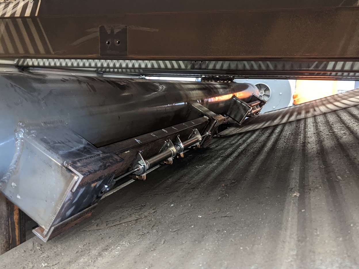

05 Dec 2020 01:28 #191090
by txtrone
- Posts: 12142
- Thank you received: 4141
05 Dec 2020 01:50 #191093
Replied by rodw on topic Downdraft design questions
Looks fantastic. Can't wait to see how it works.I was given a DXF file for a 8" blast gate yesterday. I'm still pondering how to put mine together. How much space do you have from the bottom of the slats to the bottom of the tray?
Should the air rams be covered to protect from falling sparks do you think?

05 Dec 2020 02:26 #191099
by txtrone
I will have to measure from the slats to the bottom of the tray and get back to you. Making a reminder to myself now.
I read through your thread (on another forum) where you documented the entire spaceship build. You are a madman, but you have a really cool spaceship!
Would you mind sharing?Looks fantastic. Can't wait to see how it works.I was given a DXF file for a 8" blast gate yesterday. I'm still pondering how to put mine together. How much space do you have from the bottom of the slats to the bottom of the tray?
That's a good question. You are likely to have your exhaust table running before me, I still have to get LinuxCNC to move the gantry around! I went ahead and removed the electronics and computer that I had been using. Hopefully that will force me to get this one running with LinuxCNC. I got some motors turning on the bench, but that is not the same.Should the air rams be covered to protect from falling sparks do you think?
