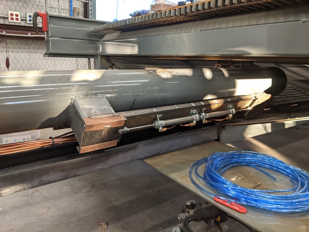

I found this pic
See: safe-welding.com/extraction-table-7-fact...cted-during-cutting/
I kinda like how there are no sliding shutters to get stuck and how the air ram uses the hatch it opens to shield itself against sparks. I think I might use a dual rod air ram if I go this way.

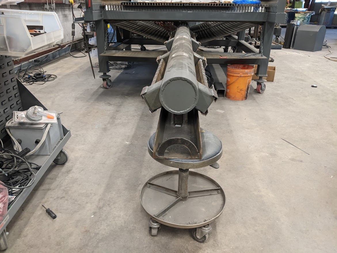

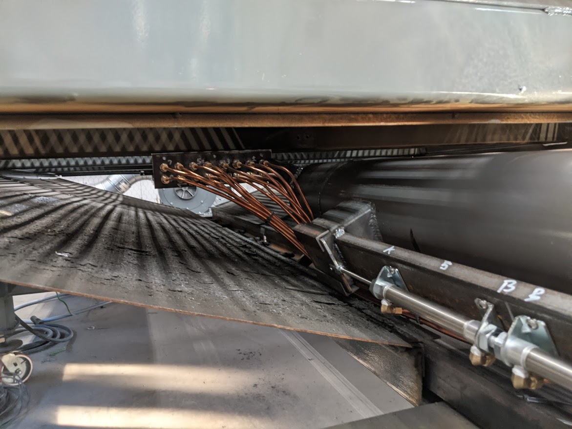

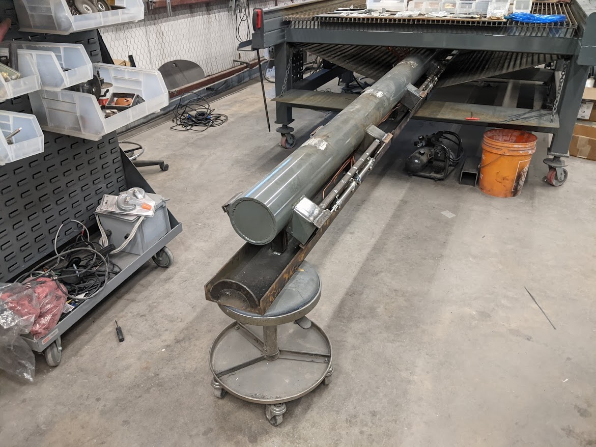

I think your only problem with your design will be the plasma dust building up on your rams and being abrasive. I know first hand how destructive the plasma dust can be.
A simple cover over the top should keep them safe, apart from that its taking shape nicely.

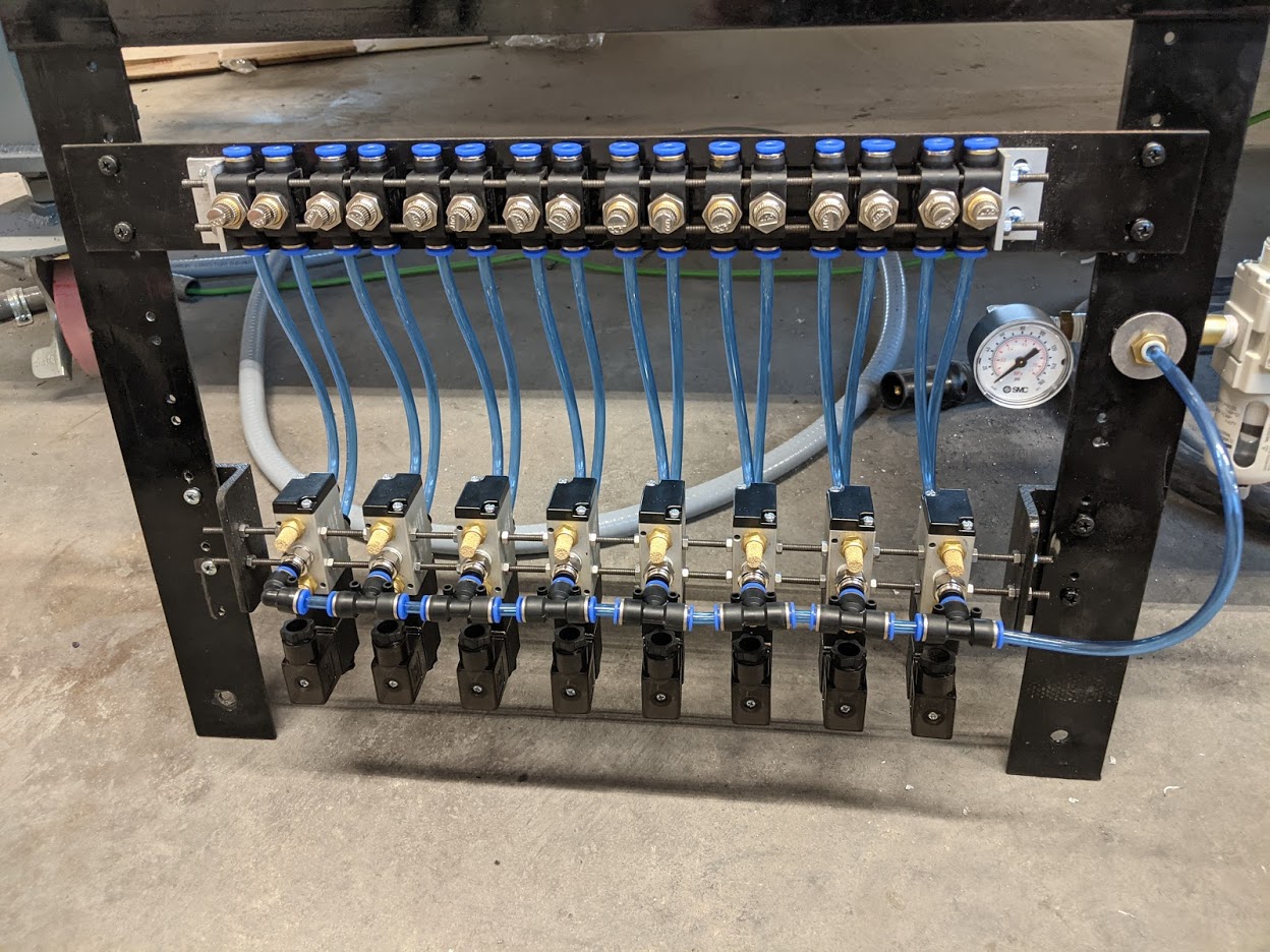

09 Dec 2020 01:37 #191455
by txtrone
Replied by txtrone on topic Downdraft design questions
The following user(s) said Thank You: tommylight, thefabricator03
- Posts: 12142
- Thank you received: 4141
09 Dec 2020 01:43 #191456
Replied by rodw on topic Downdraft design questions

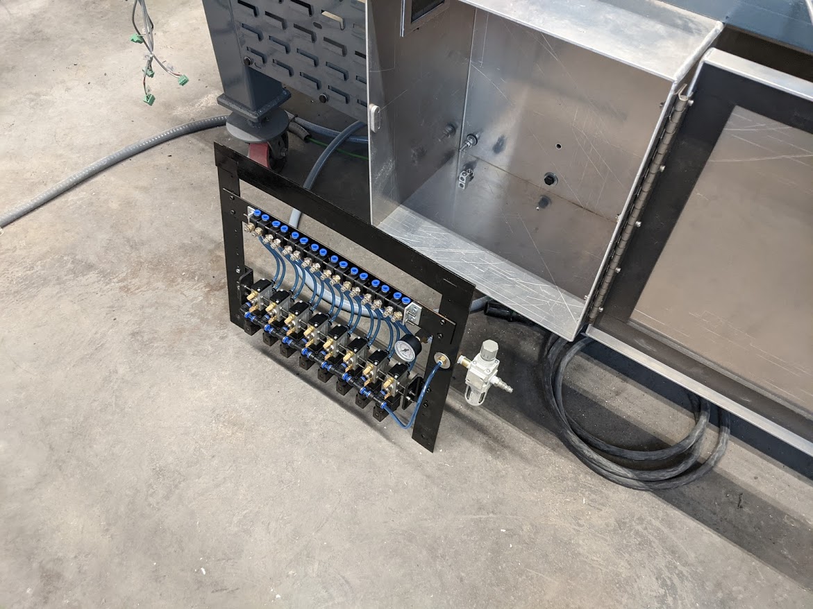

Man, that sure is a fancy air install! Is the top row to adjust the ram speed?
The following user(s) said Thank You: txtrone
- txtrone
- Posts: 384
- Thank you received: 106
09 Dec 2020 02:01 #191460
by txtrone
Yes. it's probably overkill but I saw no reason to stop at this point.
I started mounting the electronics onto the back plate, the one that goes in that small aluminum cabinet, today as well. My plan is to get the table going, working with the air gates, and hold off on DTHC for now. What do you think?
