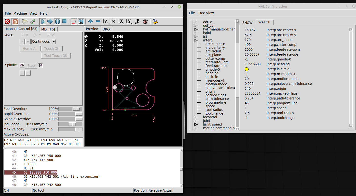

Yes as you know I have one in progress but its failing a test. Andy thought I should just submit it as is. But I've decided to send an email to the gatekeeper first
There is some real cool stuff here for plasma and then some. This is all in hal in real time
original feedrate, Arc radius, if the arc is a hole or not, kerf width and another 23 status bits I have not even dug through yet.
Plus Andy suggested that I include a directional heading that could be used to orient a tangential knife or saw blade. I can see a use for that too.
Anyway, I'm a bit worried about the dev team's response to some of R&D's future proposals. I just want Plasma to work without bothering about any special G code commands... or listening to complaints about more work....
Replied by rodw on topic RS485 For Hypertherms
I guess we will find out when the PR's appear.
