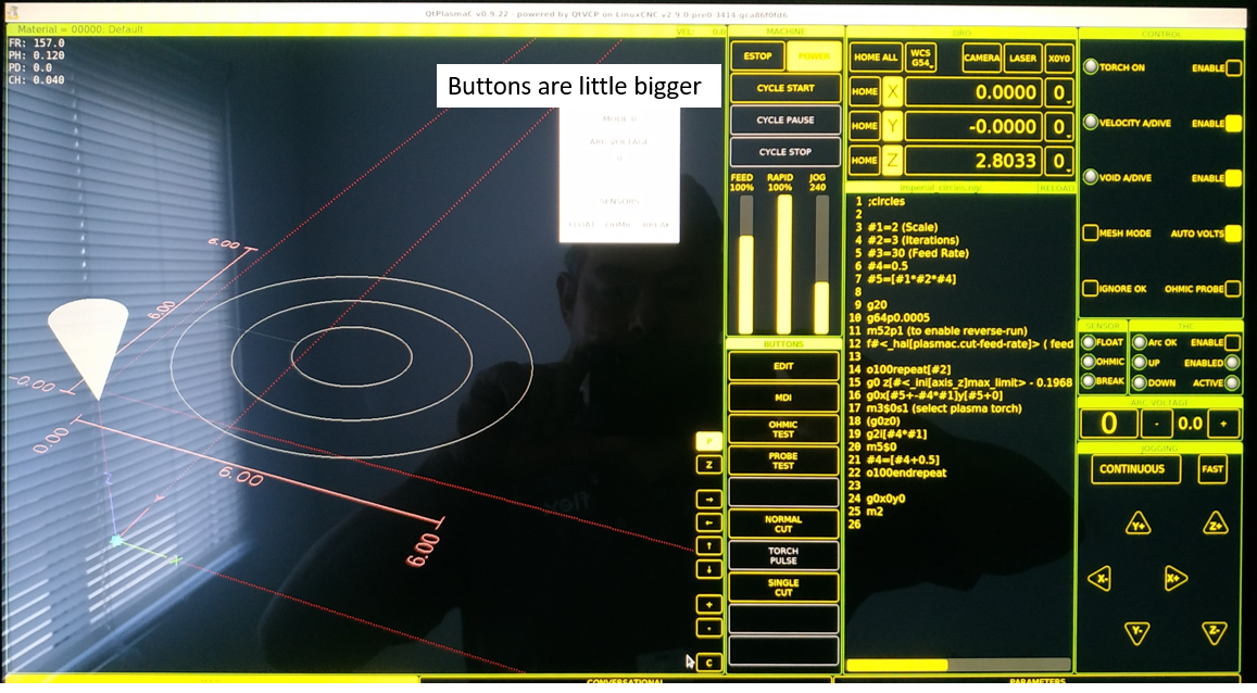

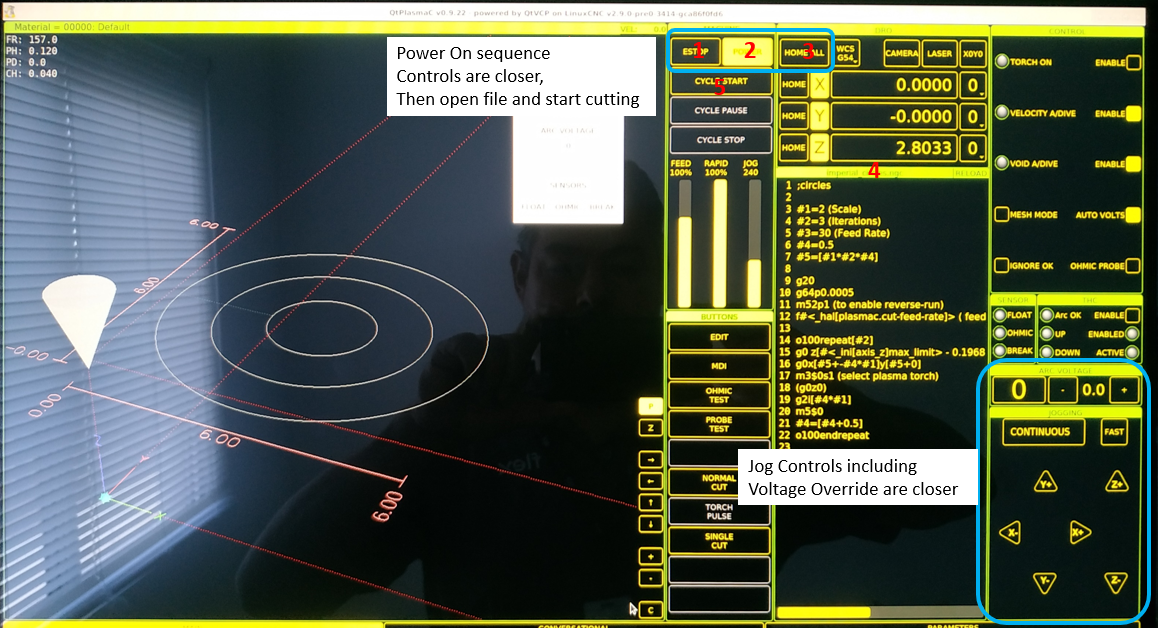

Hi
First of all thanks for the interest in the comment, understand no everybody like and is ok, in other hand I insist that the work phill has done is a great effort, and please don't take me wrong mi intention is that if something is helpful for me maybe it can be helpful for other people.
as you can see in the attached pictures, changing the lay out in QT is not rocket science (not like the great work Phill is doing), so I changed the layout a little bit to fit my ideas and see how it looks, the screen is working nice in the simulator

25 Jan 2021 15:45 #196564
Replied by tommylight on topic GUI for PlasmaC - QtPlasmac
Nicely done!
We have one more GUI developer now!

25 Jan 2021 16:06 #196572
by phillc54
Replied by phillc54 on topic GUI for PlasmaC - QtPlasmac
That looks good Pedro, nice layout.

25 Jan 2021 16:17 #196576
Replied by rodw on topic GUI for PlasmaC - QtPlasmac
Tommy, you caught me while I was swapping tabs to compare the photo of my layout with Pedro's. I do like his better grouping of controls. I'm not sure why Autovolts for you makes the torch lower, it does not have anything to do with torch height. All I can think of is you are not waiting for the pierce voltage to subside before enabling the THC. But that should see the torch lift...
So I have a question for you guys. Do you ever use the preview in other than Z axis (plan view)?
Surely the perspective view Pedro has used by way of a demo is never used when cutting on a 2D machine.
The reason why I ask is that if you both have full sized rectangular tables but Pedro's preview (and mine) results in a square preview.
It would be possible to add an extra zone between the gremlin preview and the rest of the controls without altering the preview scale on a rectangular table as its just removing unwanted white space.
Tommy, this could possibly be used to move forward the controls you want from the other tab.
I'm not sure how this helps me when I have a square table!

25 Jan 2021 16:43 #196580
by phillc54
And it is even better as a picture instead of words, I am much better at understanding pics
I'll have to see how this fits in with the standard 16x9 screen.

25 Jan 2021 18:39 #196586
Oh to hell with it, i kept my mouth shut enough !
I want bigger LED's, much bigger,
I want bigger buttons,
I want buttons much more separated, just in case i get a touch screen,
I want the actual voltage much, much bigger so i can see it from across the shop
I want a 2 meter tall blonde,
I want popcorn ......
Oh wait i have popcorn, back in 4 minutes ..
ALL of the above is a joke, so cool down, well except popcorn ... and the blonde
Rod,
I do use it quite often,
Rod,
I do not want more stuff there, just voltage instead of overrides, but i got used to overrides so i am good.
Rod,
It has everything to do with torch height, autovolts is based on the torch height (Phill, correct me if i am wrong here), it is sampled at whatever the cut height is set to and used as a reference, comes to think of it, i might have had it to low, wait i'll go facepalm myself and come back after the red has subsided from said face.....although i did try the THC delay from 0 to 1.5 sec and it was always to low at under half a mm above the plate.
With that said, Phill did a great job at figuring out the relations between voltage and height and arranged it absolutely perfect, hence i keep repeating i can live with overrides.
