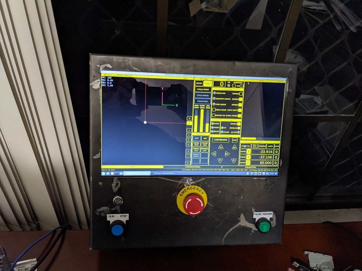

25 Jan 2021 11:49 #196523
Replied by rodw on topic GUI for PlasmaC - QtPlasmac
Still very early days yet but I have a HMI enclosure for Plasmac as of 5:30 pm today!
The circuit board for my 7i73/Odroid/Estop/Wireless pendant shield arrived today but I'm still waiting for some components to arrive.
Anyway, I thought I'd post here becasue a brand new GUI deserves a brand new enclosure to live in!
