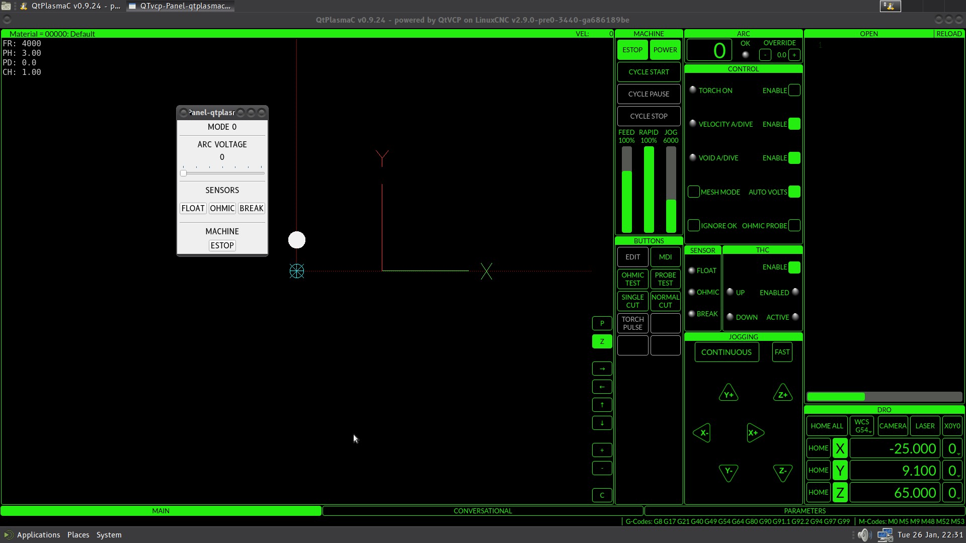

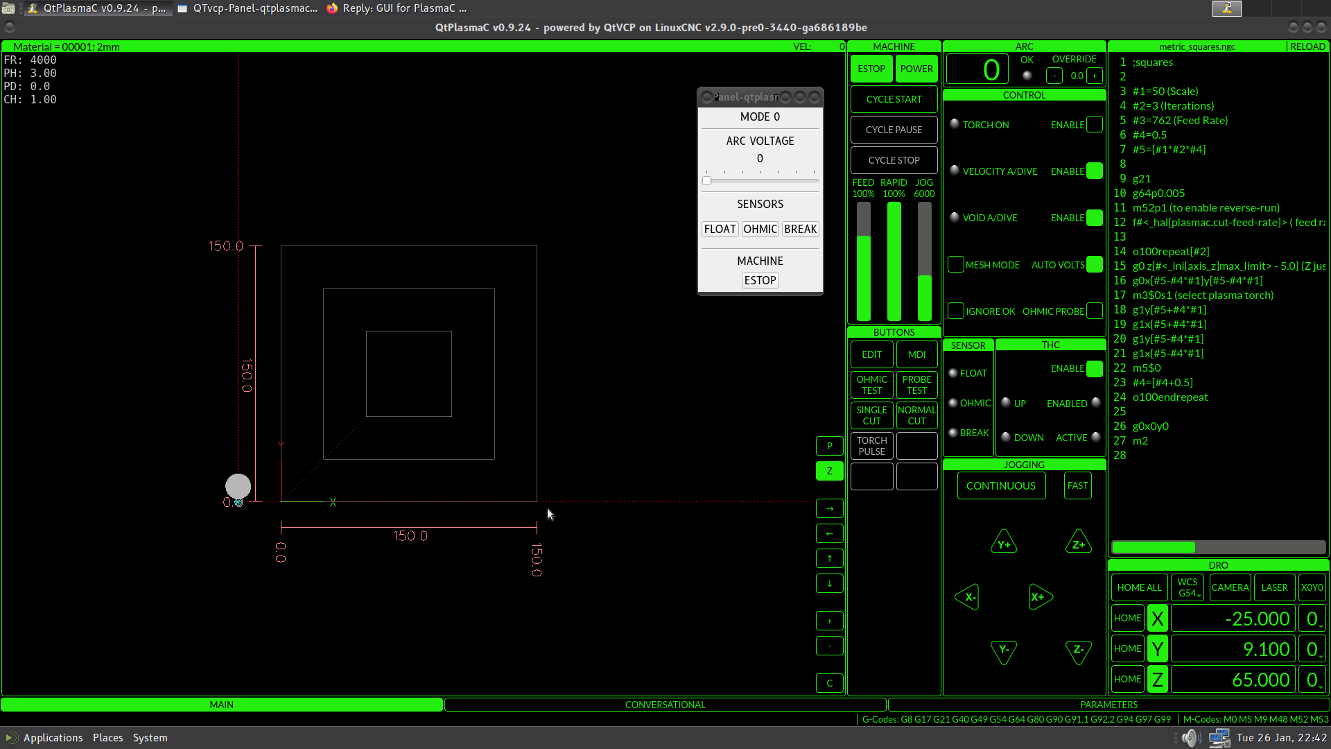

26 Jan 2021 16:49 #196672 by robertspark
Replied by robertspark on topic GUI for PlasmaC - QtPlasmac
nice, 23" capacitive touchscreen, 1920x1080
tiny suggestion(s) maybe consider increasing the size of the tabs at the bottom of the page + material selection and gcode preview (open)
I agree with tommylight regarding the LED sizes + voltage {and the voltage offset / override +/- buttons) {given thats the important info you need from across the room / quick glance and quick adjustment)
Just wondering if there is a way to make the elements a proportional percentage to allow for automatic scaling (??)
I'm "playing" with a copy of the screenset as I really like the clean / flat look of it for a lathe.

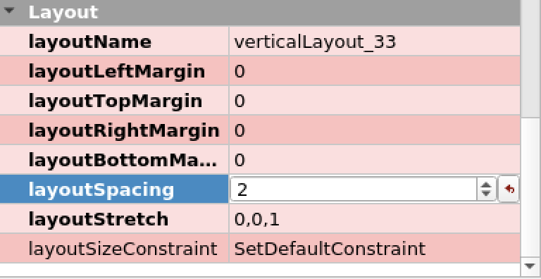

26 Jan 2021 16:58 #196676 by phillc54
Replied by phillc54 on topic GUI for PlasmaC - QtPlasmac
To a degree, you can set the layout stretch for the different elements in the layout. You also need to specify min and max sizes if you want to restrict anything.
In the following you could make the layout stretch say 3,5,1
Warning: Spoiler!
I had intended to begin this after I get the functionality and docs finished but If someone else wants to take it up then great.
