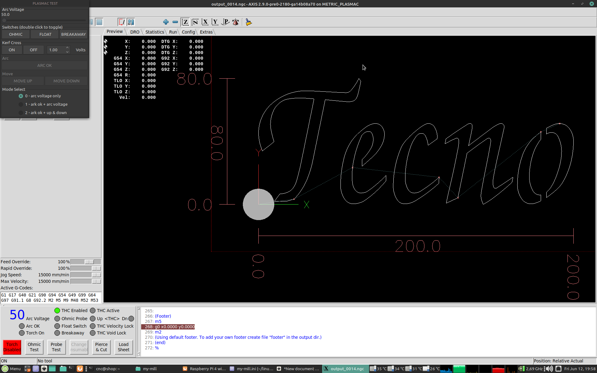

Where can I find some gcode test files that have 0,0,0 in left down corner?
- Posts: 21985
- Thank you received: 7484
12 Jun 2020 17:47 #171281
Replied by tommylight on topic Raspberry Pi 4 with PlasmaC
How big ?

Time for me now to add plasmaC aseverything looks to be working OK.
Need to fix some mechanics, was a bit over optimistic re stepper motor fasteners.
But the concept works that i scrambled together and I am happy about that!
Big thanks to all cheering on my long way here.

Hmmmm
Did run the configurator, obviously with not all correct so I then did run configurator and tried reconfigure = here it stopped. So I can not get my errors correct. Bug?
- Posts: 21985
12 Jun 2020 19:23 #171295
Make a new config with the configurator and delete the old one.
