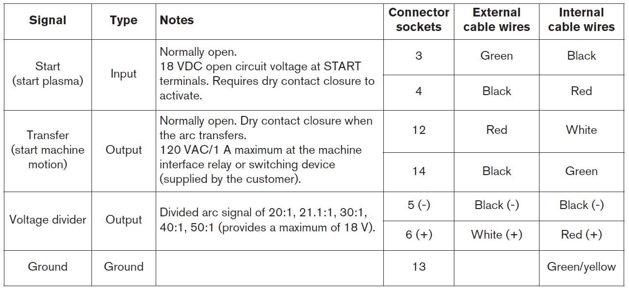

08 Dec 2020 09:06 #191398 by snowgoer540
Replied by snowgoer540 on topic Arc OK intermitent issues on torch fire
Also got word back that its a dry contact.
Your arc ok is a dry contact relay inside the plasma cutter, yes.
I’m saying some machines are sensitive to using a solid state switch to control “torch on”.
This would not work for me, I had to change the torch on to a dry contact mechanical relay. In my case, it’s specifically what Hypertherm calls for. When I get to work I’ll link a video (if I still have one) of what my torch used to do. It’s exactly like your first video.

08 Dec 2020 10:36 #191408 by snowgoer540
that would be great cheers.
Here you go:
You'll have to take my word for it that there is in fact a tiny arc there. Also, I did have another video after I changed to a dry contact relay, but it legit just shows the torch pulsing as it should and I don't have enough service where I am to upload it currently. At any rate, when my ground cable was near the table, the arc would be stronger. I would often lose valid arc ok at the beginning of a cut, or a second or so into a cut, etc. I was really pulling out my hair until I went to a manual torch to cut something else and the ground clamp wasn't hooked to anything and it all worked fine. Switched it over and it's been find since.
I would look at it like this: It doesn't work right now. The worst thing that can happen is you switch the output and use a mechanical relay, and it still doesn't work. Then you switch it back if you want. Otherwise it solves the problem, Bob's your uncle, and you go on happily cutting.
Below is an excerpt from the hypertherm manual which shows requiring dry contact closure to activate:
It seems some people get away with using a SSR. It was a problem for me.
The following user(s) said Thank You: luftlupus
