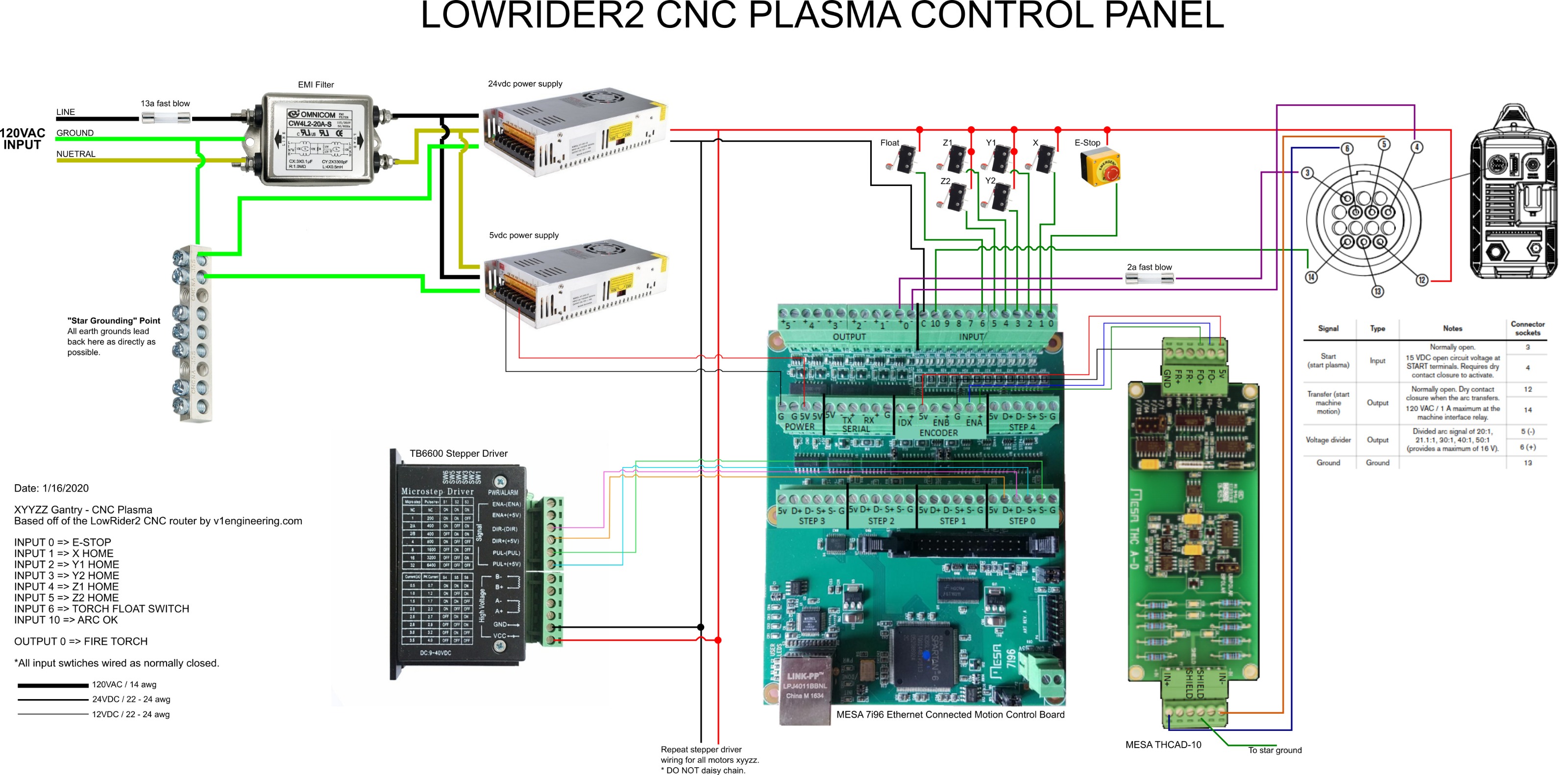

17 Feb 2021 04:50 - 17 Feb 2021 05:04 #199131 by Nick7251
Replied by Nick7251 on topic Powermax 45xp lost arc delay
The hard thing is that I could get it to work by moving the ground clamp closer to the cutting location for a while then the problem would pop back up. So I'd turn off the cutter and back on and that would sometimes allow it to cut again and sometimes not. Then I'd hit the pulse button and that seemed to get it to cut sometimes and sometimes not.
So I suspect none of those things actually effected anything and it was just intermittent and tricking me. Also the fact it is intermittent makes it hard to duplicate for serious testing and fixing.
Seems a lot similar to:
"It may be of importance to note: When this was all going on, with the SSR, I noticed that if i had the ground clamp near the torch I had a MUCH higher chance (but not always and the length of time the pilot arc was stable varied) of getting a reliable pilot arc. If I took the ground clamp off the table, it would never fire."
From this post
Yes, agreed. I sense a mechanical relay in my future but still want to try some hal scoping to ensure I have proper delay set for the THC.
Also the polarity theory is interesting that Rod just mentioned. I have mine wired like in the attached picture.
Last edit: 17 Feb 2021 05:04 by Nick7251. Reason: Typo
17 Feb 2021 05:38 - 17 Feb 2021 05:38 #199132 by rodw
Replied by rodw on topic Powermax 45xp lost arc delay
Its not a theory. Its fact!
Interesting that you have the polarity marked on your 7i96 but the Plasma cutters are silent on polarity. (probably becasue it does not matter on a mechanical relay which was probably what was widely in use when the docs were written years ago...)
For my Thermal Dynamics A120 plasma cutter
pin 3 = spindle ENA -
pin4 = spindle ENA+
On your diagram you have the polarity reversed. I wonder if all these issues can be traced back to the one circuit diagram as this is not the first time I've seen your schematic?
Last edit: 17 Feb 2021 05:38 by rodw.
17 Feb 2021 06:35 - 17 Feb 2021 07:00 #199134 by Nick7251
pin4 = spindle ENA+
Sorry Rod. "Theory" was the wrong word to use.
Maybe that is it then for me too. Polarity backwards. Too bad Hypertherm doesn't list it in their manual like TD does. I'll try swapping the wires before I do anything else. That way we are only testing one variable at a time to ensure we know what exactly fixed it. Hope to get a chance to go freeze tomorrow.
Unless you think that is a bad idea. I read over in another post that switching the polarity will start the torch in the on position.
forum.linuxcnc.org/27-driver-boards/3659...96-and-thcad?start=0
Second post.
Last edit: 17 Feb 2021 07:00 by Nick7251.
17 Feb 2021 10:43 - 17 Feb 2021 10:50 #199143 by snowgoer540
Replied by snowgoer540 on topic Powermax 45xp lost arc delay
Second post.
(just as a who's who in case you're curious) PCW is the guy who designed and sells all of the MESA hardware. Having the polarity reversed will just cause the torch to stick on (I did see that with the MOSFET type SSR I used) so be careful there. Since your torch is not stuck on on powerup, you have it correct currently.
I do find it interesting that you described the exact same thing I described regarding the ground clamp proximity to the torch. 99.95% chance it will go away with a mechanical relay.
You don't even have to get a mechanical relay to test whether or not it will fix your problem. Move the ground clamp off the table so it's not contacting any nearby metal (or just disconnect it from the front of the Hypertherm) so that it's not firing correctly by pulsing the torch in the GUI. Disconnect the two torch on wires from the output of the 7i96. Touch them together, if it fires perfectly, you have your answer.
Just my $0.02 but HALScoping your THC delay is definitely a prudent step in calibrating your table, that said I think it comes after getting a torch/cut start issue fixed. If you can't start a cut reliably, you aren't likely to get reliable data regarding when to allow the THC to be in charge.
Hopefully you get cutting reliably soon! I feel you on the cold thing, been really chilly lately over here in PA as well.
Last edit: 17 Feb 2021 10:50 by snowgoer540.
