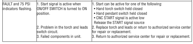

I did a search for "diode" on each page of the thread after the above was mentioned but nothing came up so I assume the following has not been mentioned.
Components like MOSFET transistors, which is what MAY be used as the "contact" in a SSR relay, or the outputs on Mesa boards, often have an internal diode across them. It's polarity is reversed so that it does not conduct when the MOSFET is wired the correct way. However, when it's wired backwards, it's effectively a conducting diode (i.e. a short circuit or closed switch) across the SSR output. If that is what is causing it then polarity is everything in some SSRs. I won't go as far as saying all SSRs because I simply don't know, but if the output is polarised make sure it's connected correctly.
Keith
Replied by beefy on topic Powermax 45xp lost arc delay
I decided to try using my Mesa 7i76e spindle relay while we are exploring this thread but I will post on another thread about that as I had some errors...
Actually I resolved my error and its possibly relevant so I will post here.
I changed my torch on relay to be the 7i76e spindle enable relay. Removed the plasma cutter wires from my relay and connected to TB4-5 and tb4-6. Once I powered up the 7i76e, the torch came on unexpectedly so I switched off the plasma cutter. Then started up in a more orderly fashion and got a startup error from the plasma cutter which is described in the manual
Active Low seemed interesting and I was aware these digital relays are polarised so I swapped the wires around on the 7i76e and it is working perfect.
So I wonder if problems some people have been having using digital relays is becasue they have the wrong polarity?
I'm going to leave it this way and see how it goes...

- Posts: 12153
- Thank you received: 4144
22 Apr 2021 22:09 #206838
Replied by rodw on topic Powermax 45xp lost arc delay (Solved)
Beefy, could you share the map of connections to the Mesa pins and the CPC now you have the correct polarity? It would be good to have a definitive mapping for a Hypertherm machine.
