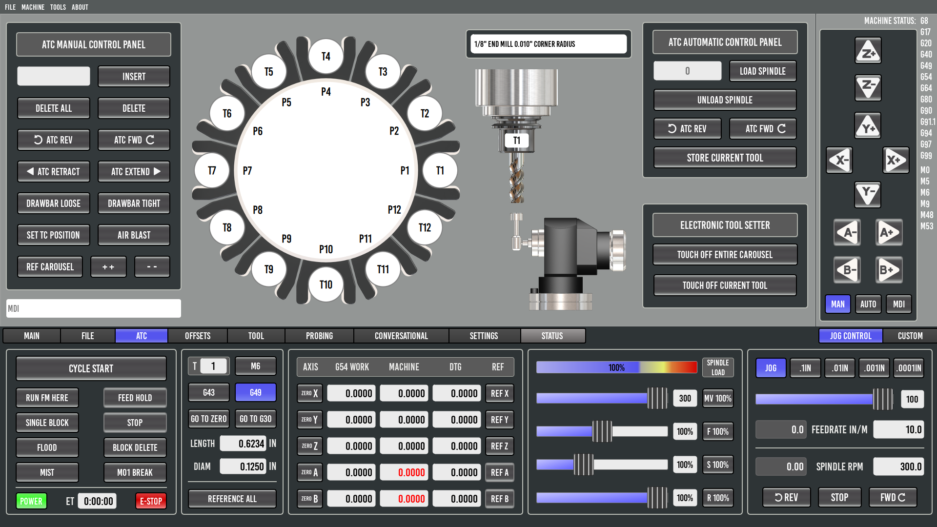

A very big thank you to Turboss for his continued efforts on the ATC QML coding. he is killing it!! I am learning a ton about it by trying to help him..lol but here is the latest update, starting to really come together now!
Thanks for looking in!!
