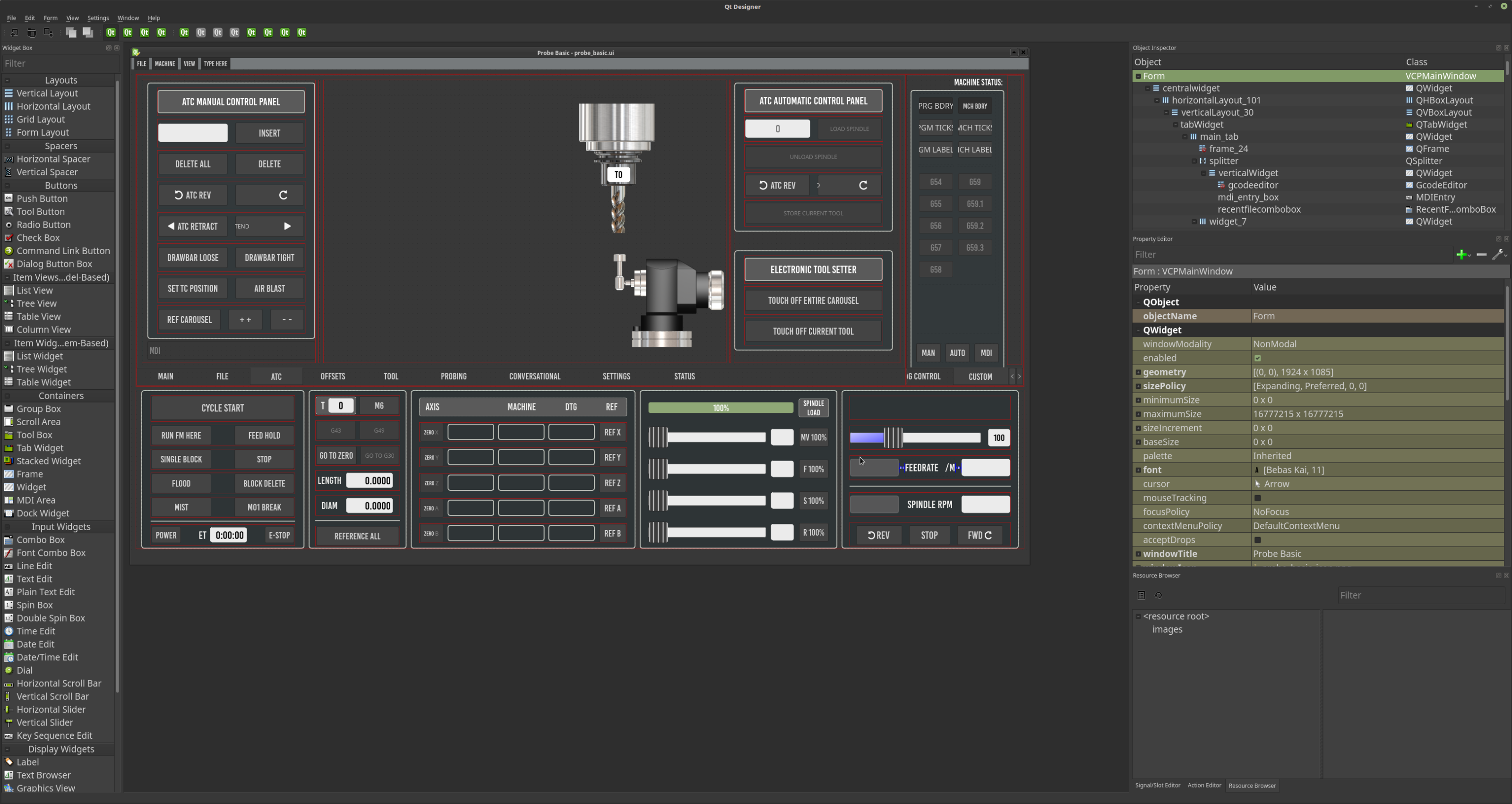

23 Mar 2019 06:26 #129329
by Lcvette
Looks like your missing something still, allot of funny looking button text going on in there, not sure what's up with that. Are you about to open the GUI? Or just the designer?
Replied by Lcvette on topic Another GUI project underway
I fixed something!!!

23 Mar 2019 07:23 #129335
Replied by tommylight on topic Another GUI project underway
That is just the designer working to a certain extent, as you pointed out there are a lot of things missing, or not uploaded yet maybe ???

23 Mar 2019 08:55 - 23 Mar 2019 08:56 #129342
by Leon82
Replied by Leon82 on topic Another GUI project underway
When I update qtpyvcp it doesn't seem to update probe screen. Mine says not set for some status labels.
Also if you open the UI by double clicking them they don't open with all the icons. I have always has to open it via editvcp in the terminal
Last edit: 23 Mar 2019 08:56 by Leon82.

23 Mar 2019 15:33 #129365
by KCJ
Replied by KCJ on topic Another GUI project underway
Updating qtpyvcp should update ProbeBasic. What status labels say not set?
You have to use the editvcp command edit a VCP in designer. The editvcp command does a lot more then just open the UI file, it also reads in the YAML config file to load custom plugins, themes, style sheets etc. and then sets up the environment and adds hooks to designer.

23 Mar 2019 16:06 #129374
by Leon82
I opened it as a Sim ant they seem ok but if it's opened in the editor it's not. Maybe I'm looking in the wrong spot.

23 Mar 2019 16:11 #129375
by KCJ
Ah, if LCNC is not running when you edit the VCP some data is not available, so some labels will say N/A or Not Set.
