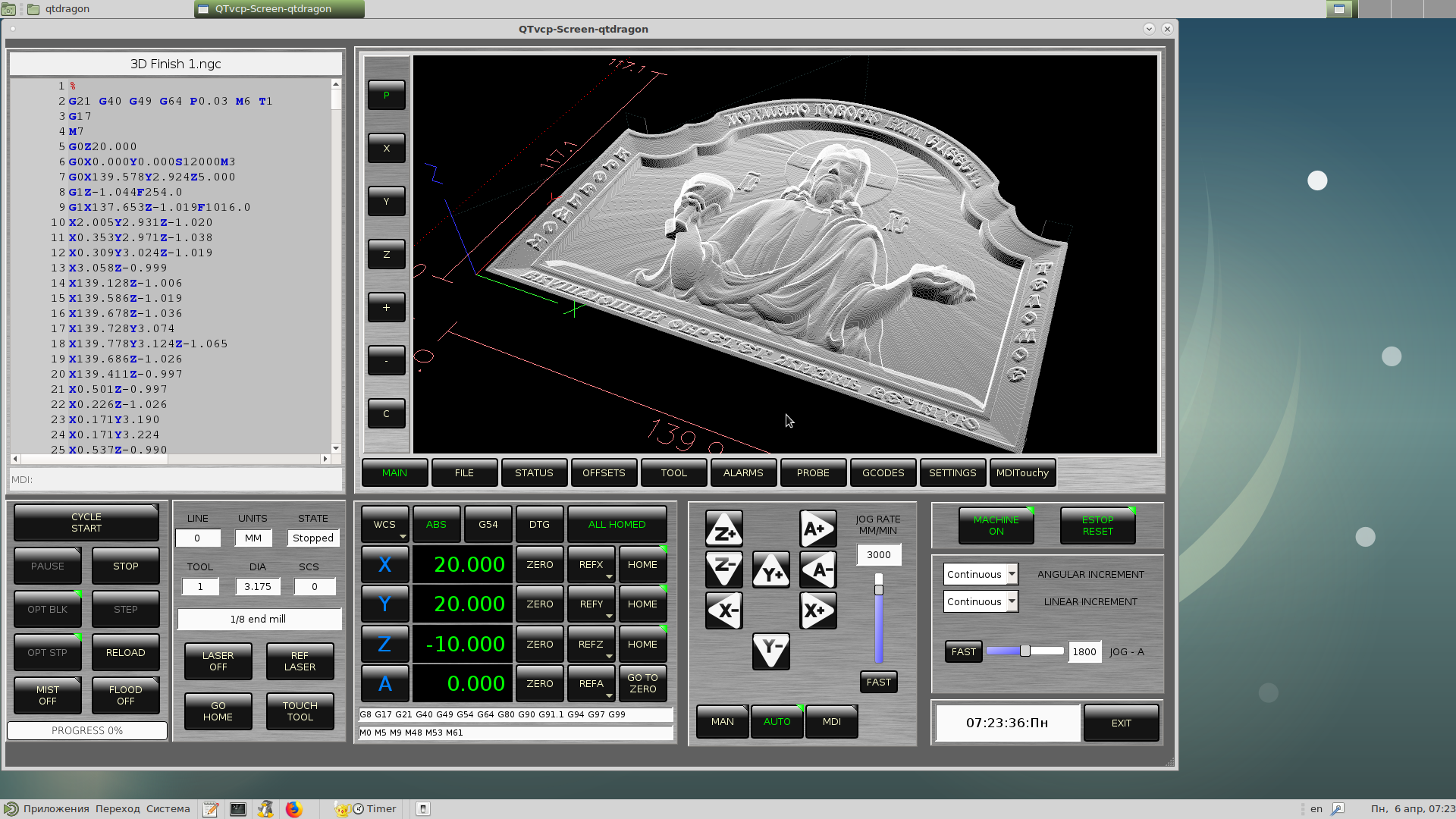

If you use the QtDragon interface, I suggest trying this option for your monitor.
Sitting in quarantine, I changed the qtdragon interface a little, maybe someone will be interested.
Download the files and put in home / linuxcnc / configs / sim.qtdragon, if you don’t like it just delete it and nothing will be broken. Size 1600x1000. A QtPyvcp mix of several 4-axis interfaces is available.

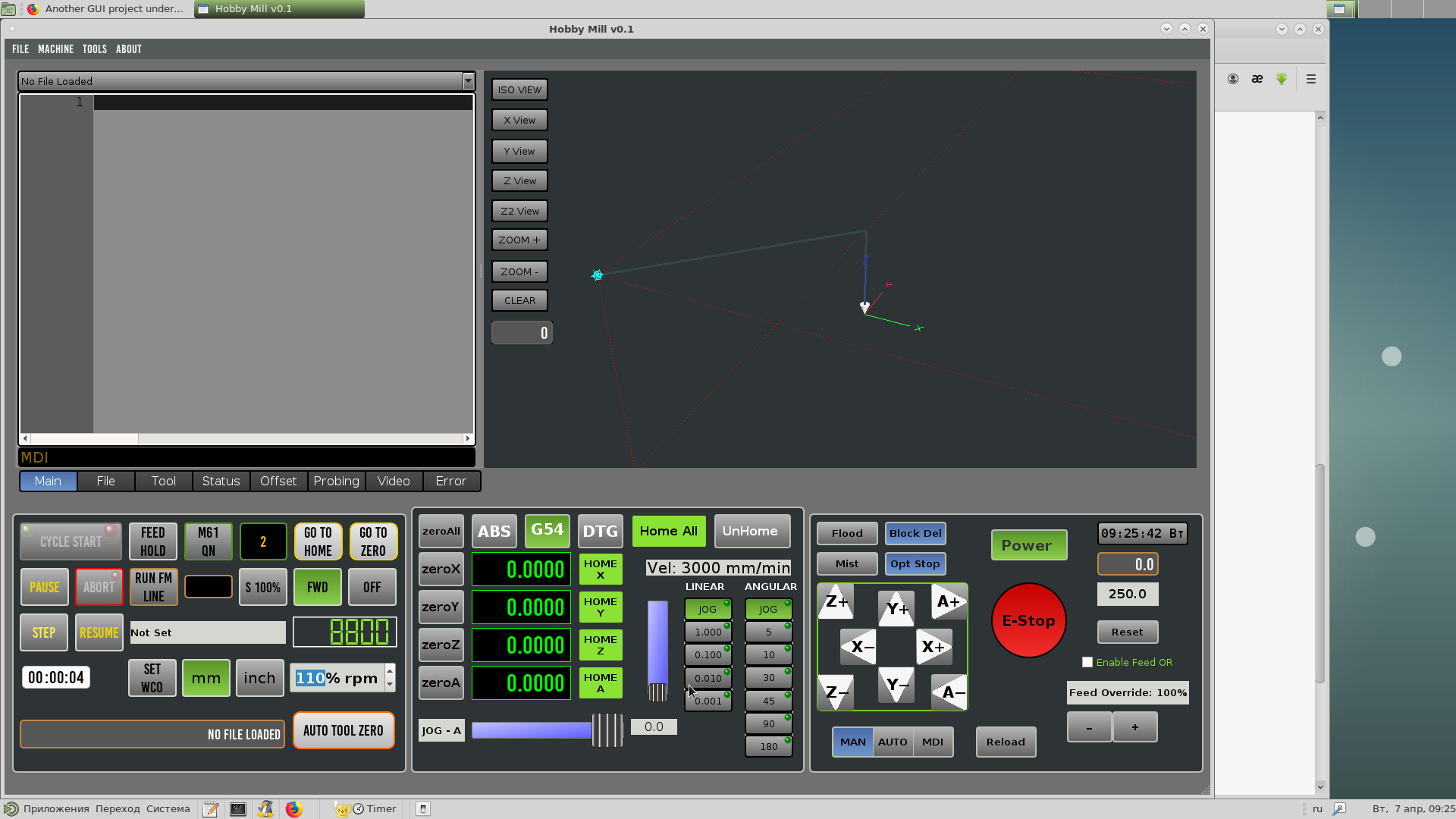

Probe Basic size 1920x1080 does not change. I have linuxcnc 2.8-pre- installed
-5585 and qtdragon works both the original and the boards. I like QtPyvcp more, but jogIncrement doesn’t work well and with VTC Plot is not suitable for large files. Good luck.
