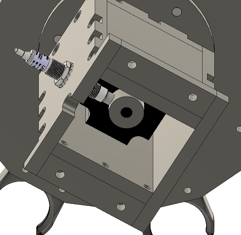

Hello now i have a mesa 7i76e...
i see 2 options for me....
7i76e + 7i76 or 7i76e with Arduino
the second option is low cost. the first option will open more doors
i´ve seen the 7i76e is available now.
but for this prototype we can try it to do with arduino.

Ok, arduino it is.
I have no idea how to program or control an arduino, so you're on your own with that.
The stock PB control scheme is a little complicated, but the basic platter/carousel motion works like this:
If you want to use an arduino and still use the stock PB control scheme then you may need to duplicate the motion of a geneva wheel. That is, the arduino receives a 'ON/FWD' command and then:
I suggest you get your prototype set up:
Make sense?
- a microswitch or proximity sensor and install a flag (screw, bent sheetmetal, whatever) on each pocket.
- A momentary switch for ON/FWD and another for ON/REV
- Arduino
- Programmed to move the correct number of steps between pockets
- example: 8 pockets, 1.8 degree stepper, no gearbox (for testing), 10x microsteps
- 200 x 10 = 2000 steps/rev
- 2000/8 pockets = 250 steps/pocket
- Programmed to dwell a second after each pocket even if the ON switch is held down
- Stepper drive
Make sense?

ok im thinking about that for one night....
so i think i will order a second Mesacard....
what do you say is the best doughtercard for my mesa 7i76e?
7i76 or 7i85s or 7i78
7i78 only have 4 more STEP/DIR Ports and 1 rs422
7i85s does have 4 More Axis, 1x Smartserial, 4x Encoder
or 7i76 for 4 more axis, 32inputs, 16 outputs, 1x rs422, 1x encoder
i think i will order the 7i76
7i76E+7i76
a homing sensor is already placed on my TC prototyp
7i76E+7i76
