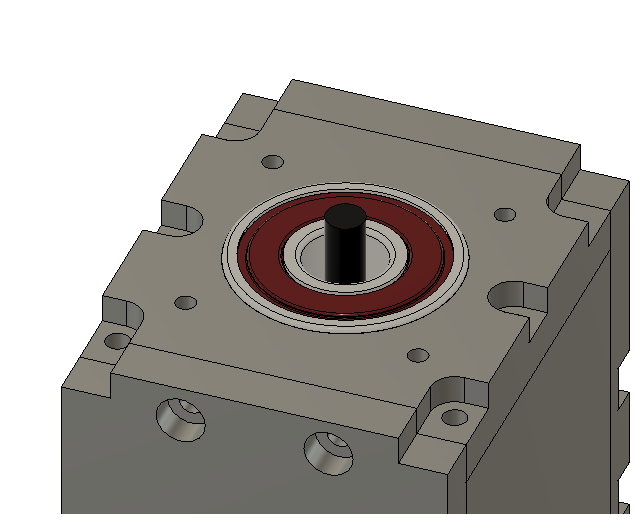

a homing sensor is already placed on my TC prototyp
The homing sensor you've shown is not likely to work well.  You have it pointed at a small diameter shaft, and I'm inferring that you have a hole or some other flag to trigger the sensor.  Proxys are remarkably accurate, but the further away from the axis of rotation you move the proxy & flag, the more accurate the final position will be.  As drawn, the proxy will trigger (and thus your home position) with perhaps +/- half a degree of rotation depending on speed, flag shape, etc.  and that will result in a significant deviation at the outer radius of the platter.
I suggest you mount the sensor to the outside of the carrier housing on a bracket, and use one of the pocket mounting screws as a flag.  If you mount two sensors on a single bracket (one above the other), one of the pocket screw flags can be longer than the rest and act as a home flag.
Make the sensor bracket adjustable so you can fine-tune the home rotational position and sensor-to-flag distance.

02 Apr 2023 15:39 - 02 Apr 2023 15:42 #268083 by CNC_ANDI
Replied by CNC_ANDI on topic Probe_basic Toolchanger
ok so you mean i need two another sensors on the outside?
one with a longer screw to say pocket in place
and the second sensor to say holder in or not in pocket
i think my homing sensor works very well...
i don´t have any reducer, geneva wheel or something else like this.
i´m hoping it will work how i think it but i don´t now...
ok i was thinking the toolchanger project is much easier.
looks so easy but it´s very difficult....
is a rack-toolchanger much easier? that´s another option for me two...
hope you understand my broken german english.... sorry

Regarding the mechanical assembly, I don't think its a good idea to mount the carousel directly to the stepper shaft.  The entire weight of the assembly will bear on the stepper bearings, and those aren't designed to take significant axial loads.  It's ok for a little testing, but you need to plan on making some sort of bracket & shaft assembly that takes the weight of the platter and then drive that shaft with the stepper (with belts or a shaft coupler).  Your stepper will thank you.
And just as important... what happens if your stepper loses steps?  You (will) have pocket sensor flags, but you'll need to account for lost steps in the ATC logic sequence.

02 Apr 2023 17:15 #268091 by CNC_ANDI
ok i will order a mesacard like the 7i78.
and then i will test the changer with full load of my biggest tools...
at my prototyp i´ve included a bearing. see the picture, i´m hopefully that works.
i don´t need much speed on the changer.
As I said, it's a prototype. if everything works great then I can optimize the changer.
