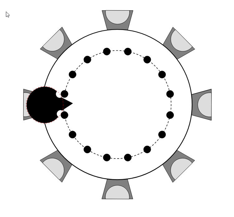

@Spumco,
No locking ?
See the gif, it locks in place.
No locking ?

Tommy,
It locks. The driving wheel outer rim is tangent to the inner OD of the driven wheel pins. Since they are two different diameters the outer pins get captured just as the main indexing pin exits the slot.
The two issues with geneva mechanisms (that I've read about, no expert here) are friction and a wonky accel/decel profile. There are two versions I found online (and copied) which eliminate the friction problem if you use rolling elements instead of pins.
Same channel has another, similar one that's even simpler... but that one is strange as it moves two pins per driving wheel rotation.

Need to clean glasses, or get new eyes as i could not see how it locks!

I have found that it is better to utilize a small pin for smoother motion. if you want to add a bearing, add it to the rotor body and use a press fit pin that rotates inside the bearing rather than fitting a bearing to an existing pin which increases the diameter. I have built a few of these over the years and initially tried the proposed methods but it had a jerky motion that was eliminated with a smaller drive pin. Just some food for thought.

It's a little fussy to model, but that's likely due to my lack of CAD and math skills. I did get it working in F360.
Could still use small-diameter needle roller bearings on the pins to achieve what Lcvette suggests. I suspect that relatively large-diameter bearings in typical geneva slots may have the effect of changing moment arm lengths significantly - maybe leading to the jerky motion.
Replied by spumco on topic Probe_basic Toolchanger
2nd basic design I mentioned. Two indexing pins per pocket, no sliding motion. Same concept in that the drive wheel is tangent to the driven wheel pins and locks them in place (red dashed line to help visualize).Need to clean glasses, or get new eyes as i could not see how it locks!

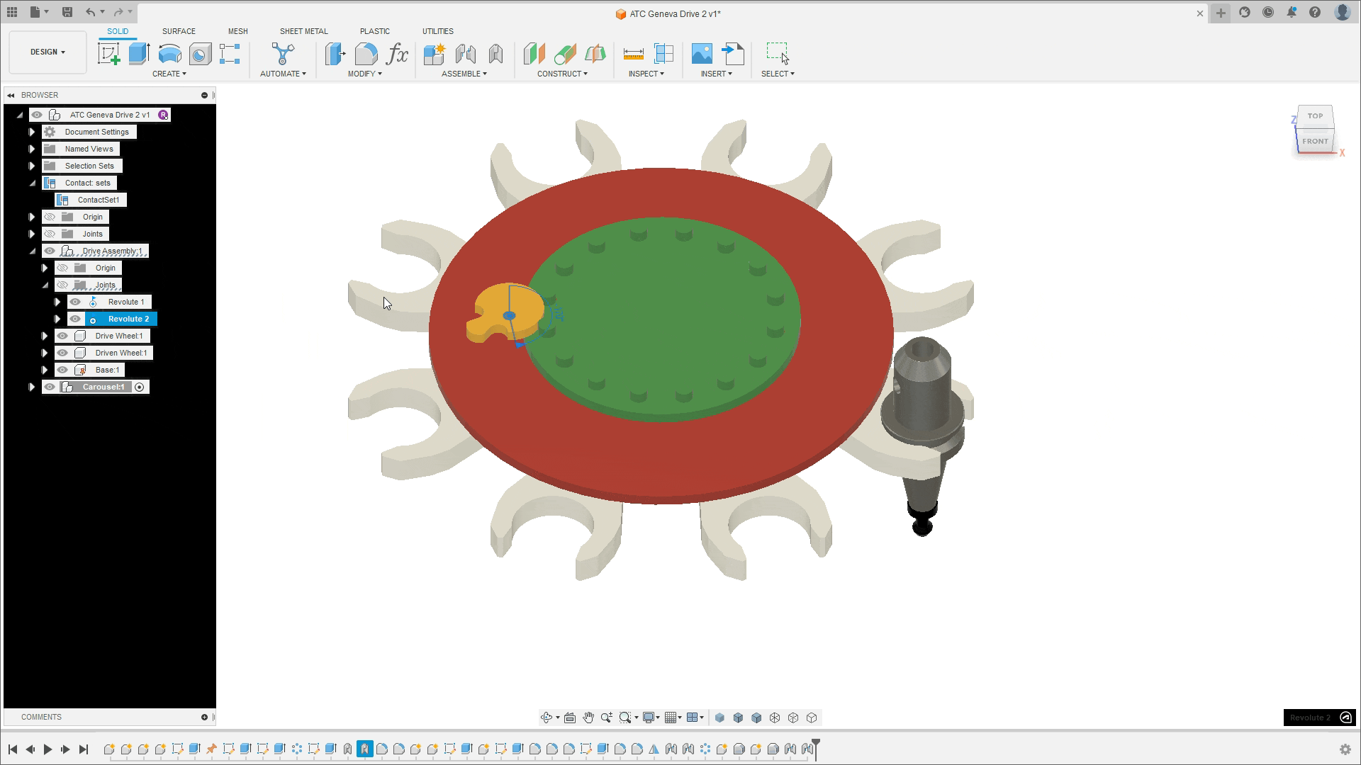

Internal drive model attached as requested.
Keep in mind that it's basically an electronic napkin sketch and not a ready-to-manufacture assembly. I'll probably keep working on it and maybe print a prototype to see if my theory about rolling elements makes this a better option than traditional geneva configs.

Very nice, indeed.
