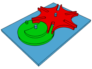

Here's a CAD model of a geneva wheel:
grabcad.com/library/geneva-mechanism-mkii-1
It could use some improvements for use on an ATC, but it's parametric and should get you going.
Things to consider:
  • slots wide enough to use a roller or needle bearing on the drive pin
  • Mount the drive wheel above with the pin pointing down
  • Print the driven gear wheel with a continuous diameter for a few layers (i.e. make a solid circle for it to 'sit' on) to help support the gear teeth/tabs
  • Add a bunch of screw holes to the driven gear so it can be screwed tight to the main carousel platter

05 Apr 2023 11:07 #268328 by tommylight
Replied by tommylight on topic Probe_basic Toolchanger
This is the best representation, some are just plain unusable for real life
en.wikipedia.org/wiki/File:Geneva_mechan...6spoke_animation.gif

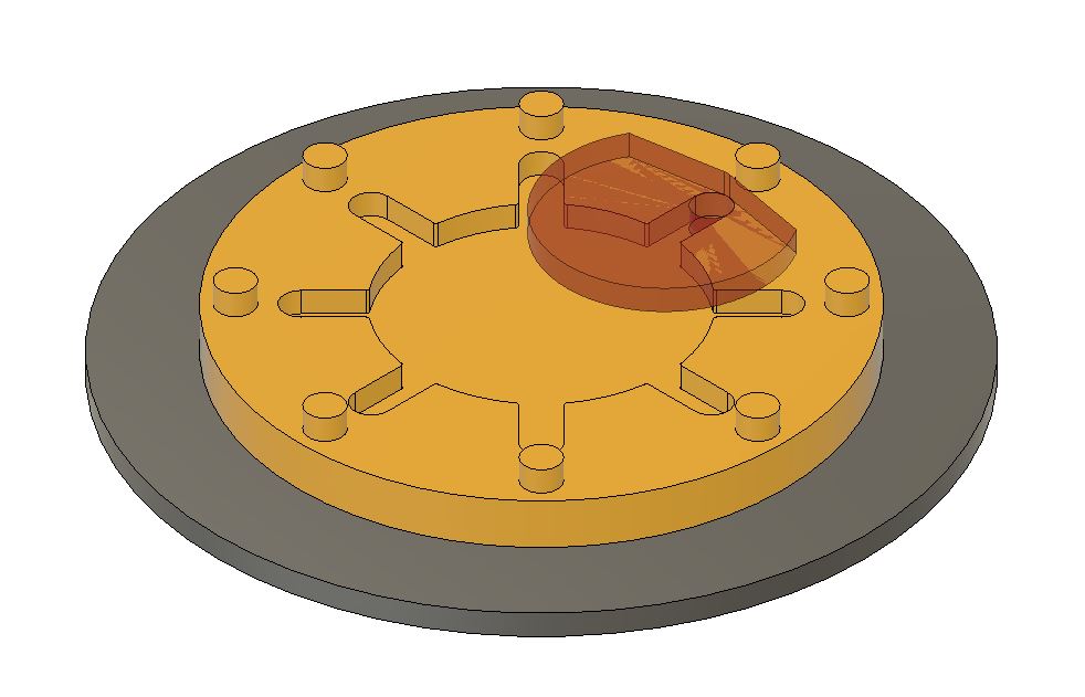

06 Apr 2023 03:38 #268374 by spumco
Replied by spumco on topic Probe_basic Toolchanger
I've got a present for you...
Internal geneva drive, obviously not detailed out... but works in F360.
  • All contact is through rolling elements (bearings), so no plastic wearing out or requiring lubricant.  The drive wheel pin is a 10mm needle bearing on a 6mm shoulder screw, and the outer anti-rotation pins are the same.
  • Driven wheel should be easy to print
  • Drive wheel should be easy to print, but should really use a metal flange to attach to the Nema 23 (?) motor.
  • Yellow driven wheel will get mounted to the tool carousel from below using slotted holes to permit slight alignment adjustment to the spindle.
  • Outer pins can also double as pocket sensor flags, and one can be longer for a home flag.
  • Everything in the model is in 'Murican units, but I've got the constraints and relationships sorted out.  For reference, the driven wheel is about 150mm.
If you want this now let me know and you can work out the details (size, mounting, motor, etc.).  My intention was to model a sliding pneumatic mount to move it in and out of position so you don't have to move the gantry and lose some cutting area.
In addtion, I plan to (or suggest you) add a spring-loaded hinge on the carousel mount.  BT/ISO30 spindles will push the tool down as the drawbar grabs it and you need some compliance in the system.  You also want a little compliance in the rotational position and the clearance between the driving wheel and lock pins will set that.
