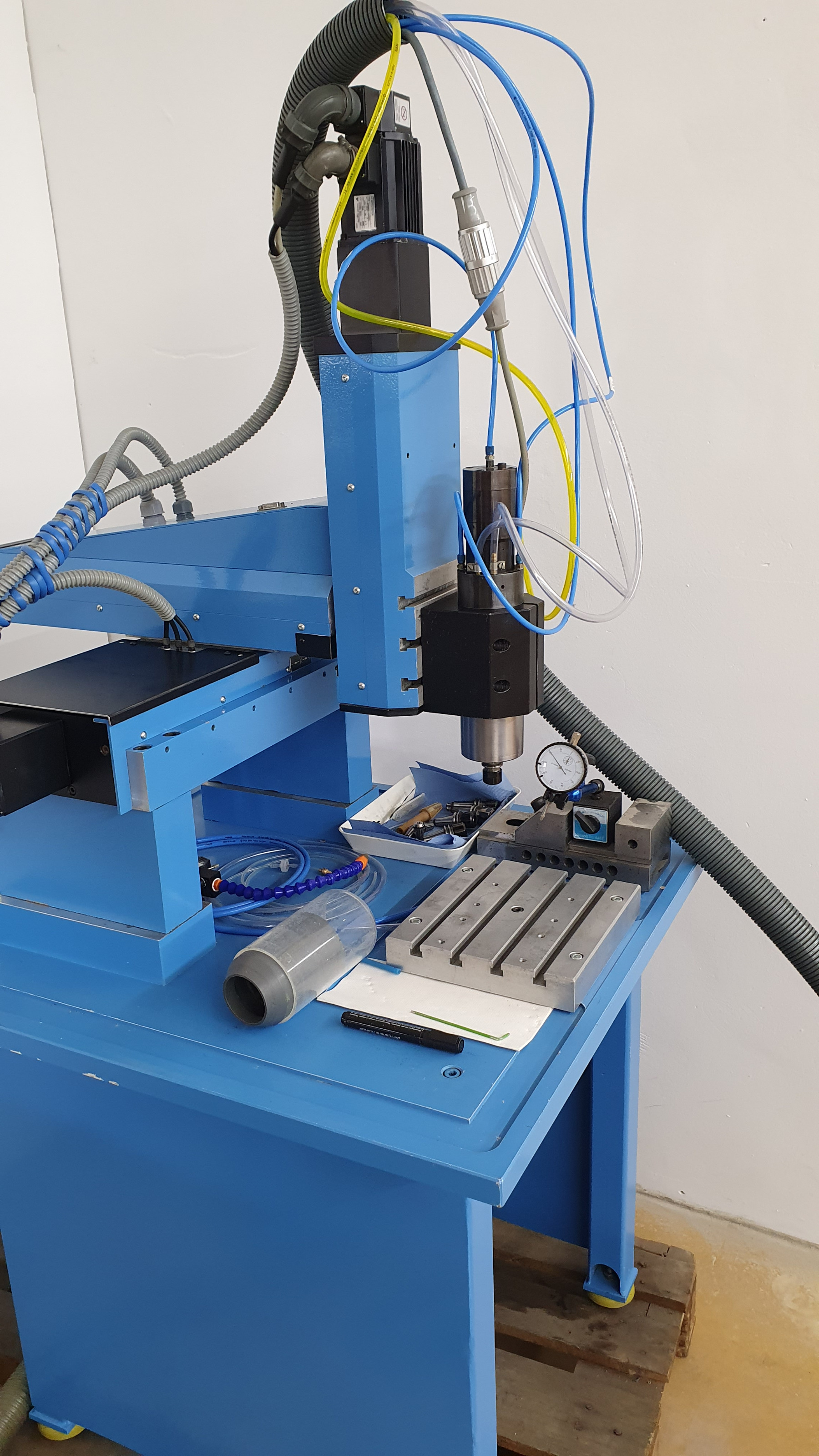

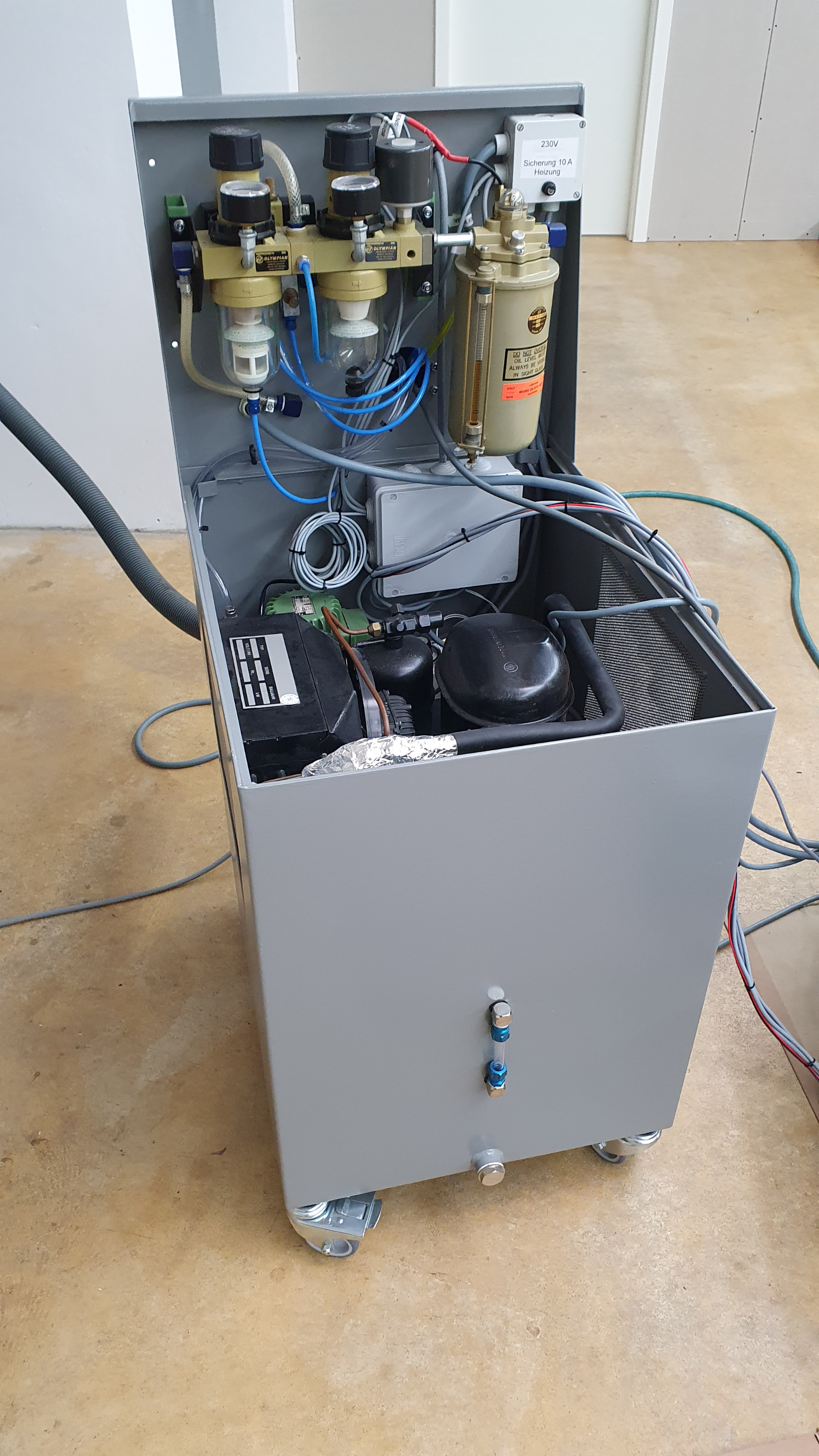

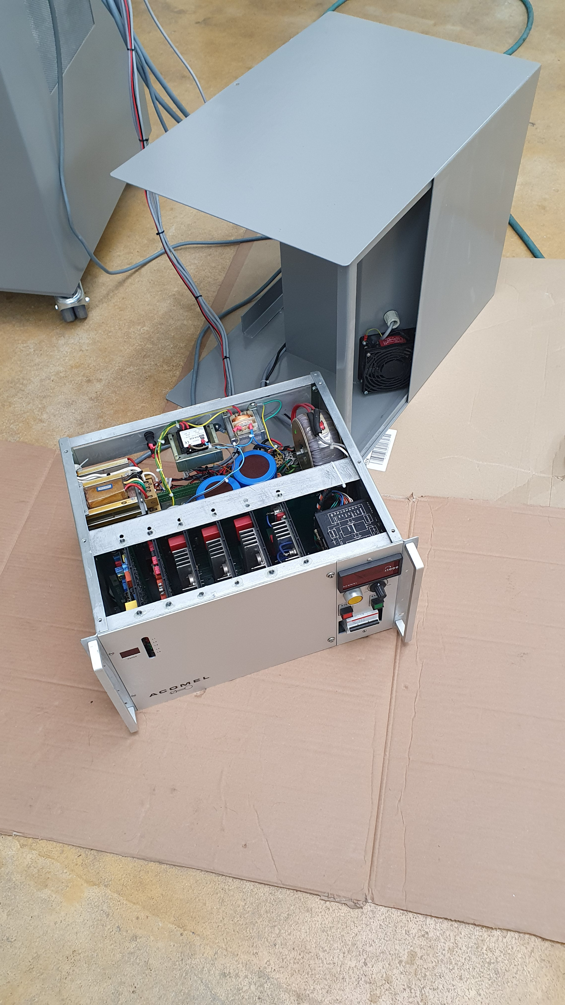

Hello,
yes - will post pictures next time i on the machine - the Spindle is a IBAG HF80 - with an Acomel VFD. Is a expensive one i have buy for an appel and egg - had to repair something like the Cooling-System and the VFD. But now is working all.
The mill is an EnderleCNC from 1999.

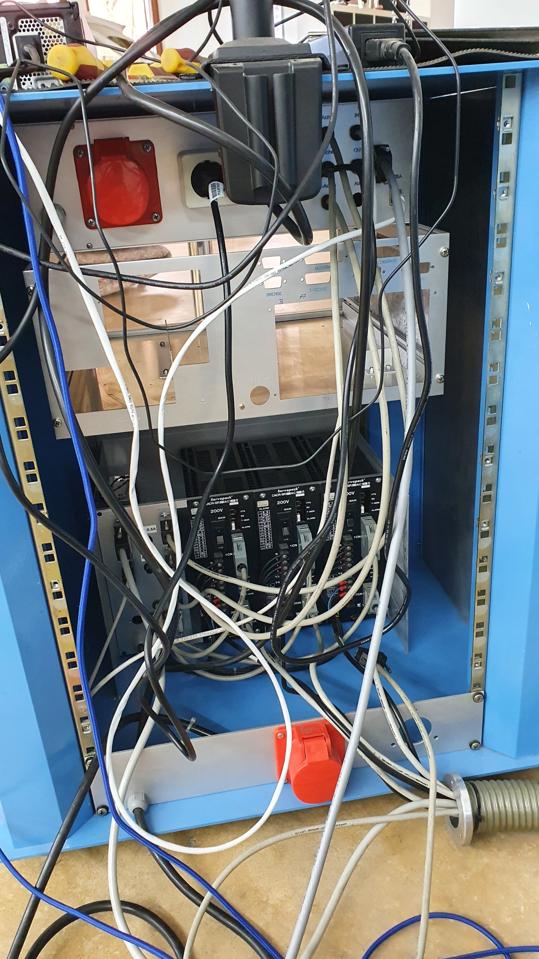

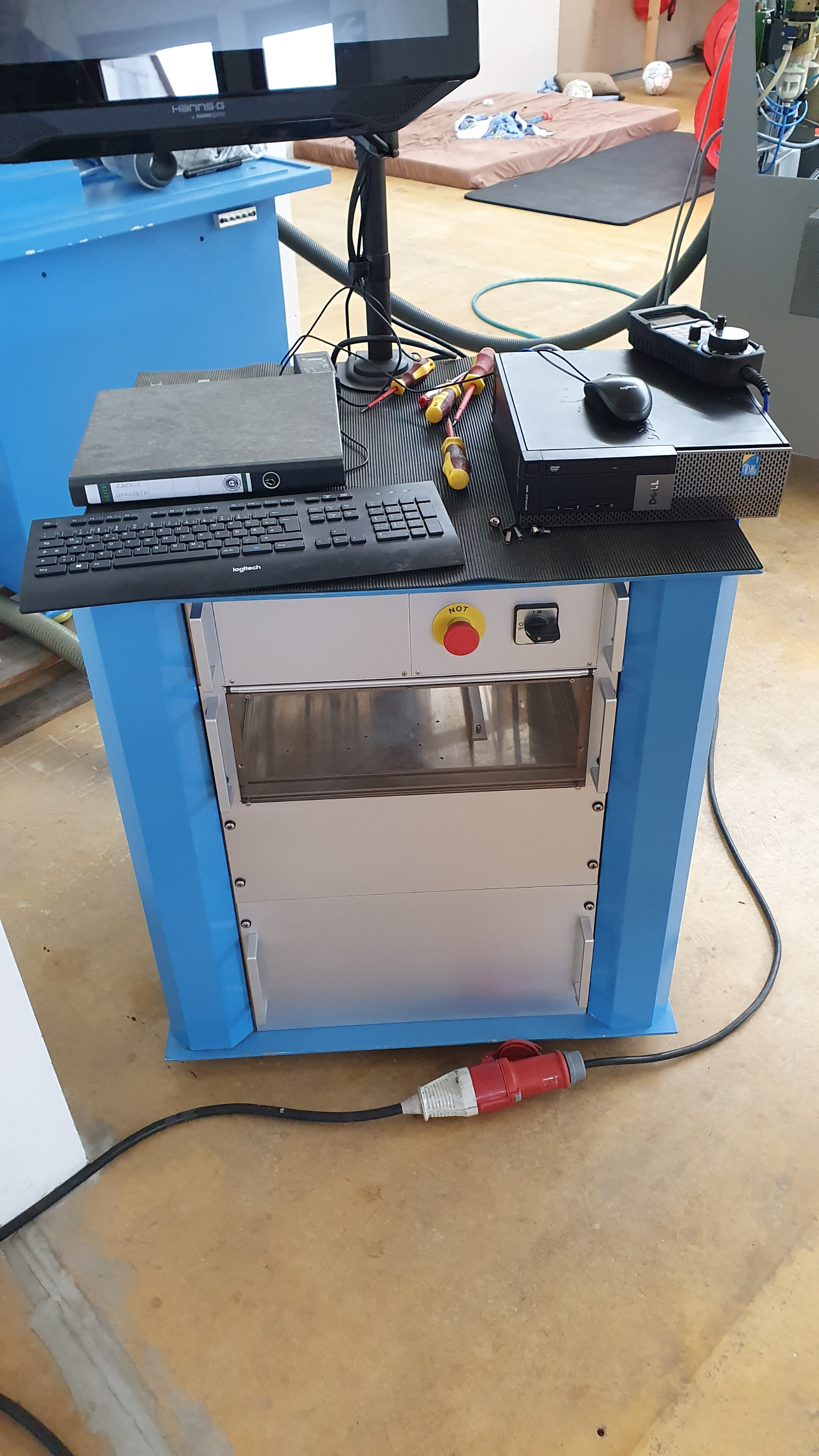

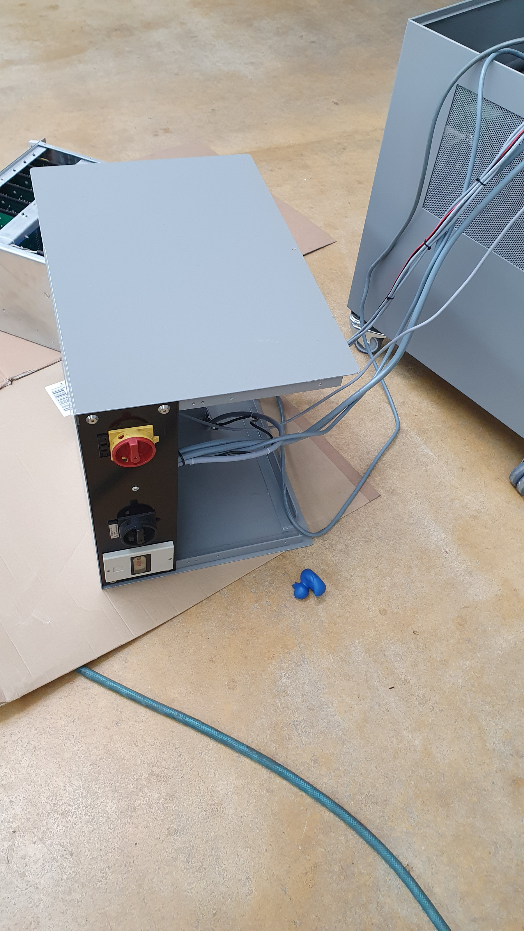

So here some pictures from my rebuild. Looks confusing - but you have seen it before
There was a nightmare.
Now all is working - new tubes new cable no logic and rebuild housing and cooling-system - my yaskawa drives with the AC-Servos now working also fine. But cable laying around because not finish - yesterday i have setup the optiplex-oc with an extra grafic-card to use the probe-basic gui... but step after step to the goal.
