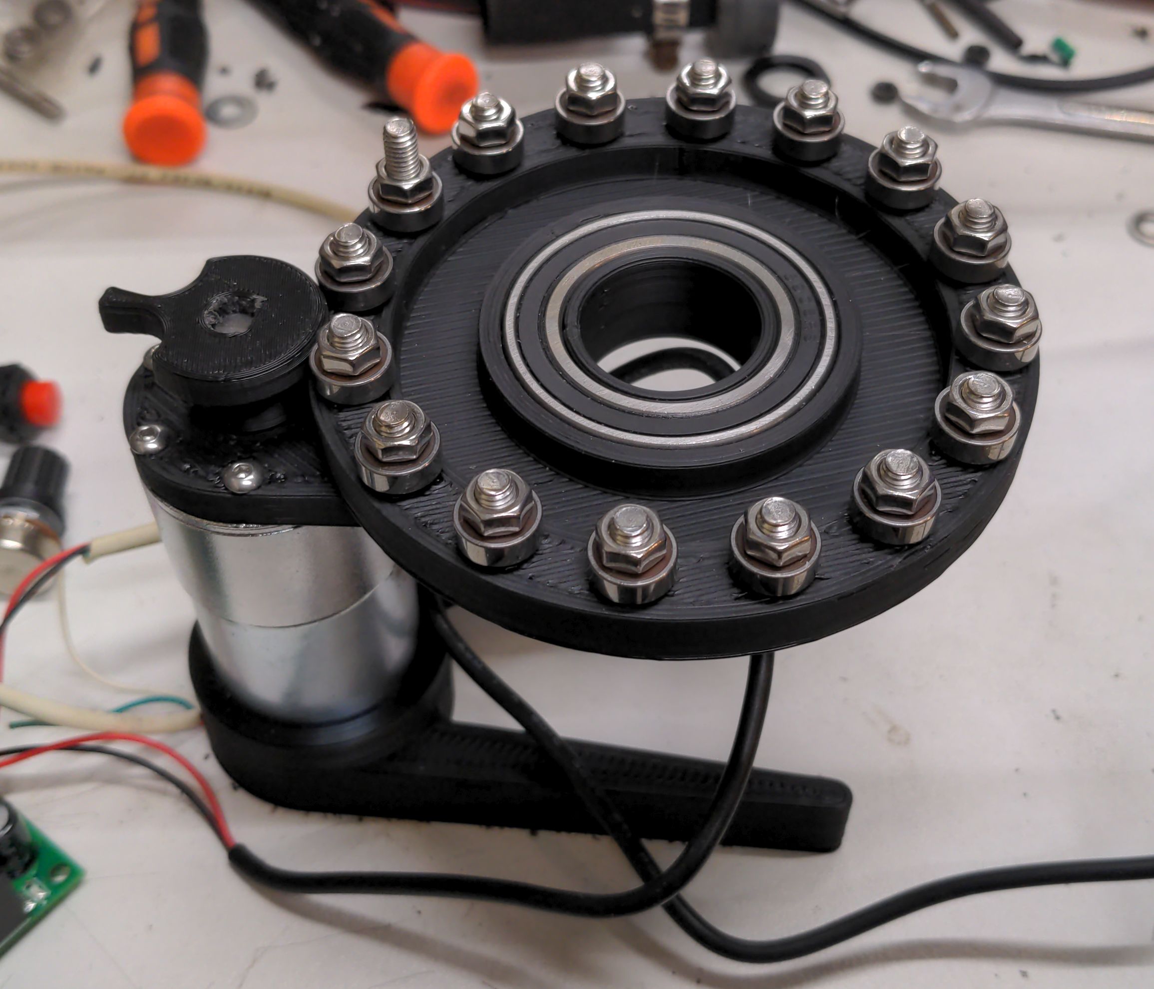

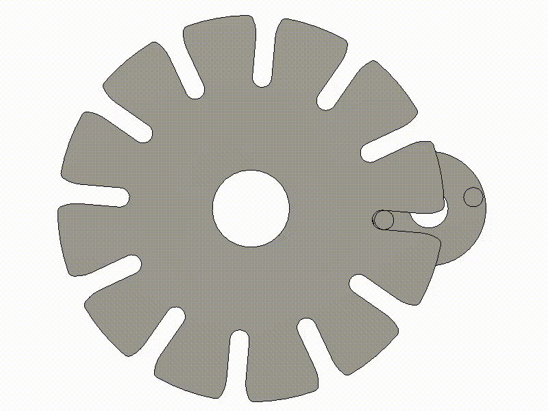

08 Apr 2023 02:59 #268579
by spumco
Replied by spumco on topic Probe_basic Toolchanger
I cooked up a live one.
Pros:
no sliding surfaces, no lubricant needed
fast
Very small driving wheel compared to driven wheel
Printed components not highly stressed
Cons
Requires double the number of bearings as pockets
Not very tolerant of bearing misalignment (printed holes need to be spot-on or it grumbles)
Really needs some sort of depthing adjustment to get the wheels locked up but not preloaded. Certainly a viable option, especially if you have a router and can make one.
Pros:
fast
Cons

08 Apr 2023 03:28 #268584
by spumco
You've got three geneva designs to play with. The one in your model looks good, especially where you have screws bolting the long 'arms' to the main platter.
The two I've thrown out there may be easier to live with long-term as they don't require any lubrication. My suggestion is to pick one of the three and build a prototype ATC that you can control using Probe Basic.
Things to work on
Count the number of inputs and outputs you need (sensors, stepper FWD/REV, etc.) and adjust your hal file digital-ins and outs:This line creates the digital ins/outs and anlog out you need to trigger/command everything through G-code. Look through the PB subroutines named 'toolchange.ngc' and m10 through m20-something. You'll see lots of lines that look like
M64 P1
or
M65 P8
The M64 and M65 lines turn on the hal pin associated with the 'P' number in that line. The other end of the connection is to the hal input or output item:
So in my config "M64 P1" turns on 7i76 output #3, which is the air valve to extend the carousel to the toolchange position.
For the sensors, you'll see lines like:
In my config, motion.digital-in-01 is the ATC extended sensor.
The "M66" line tells LCNC to wait for an input signal. In the above example, M64 P1 extends the carousel, and M66 tells LCNC to stop processing anything until the ATC-extended sensor is triggered. And if it takes too long (5 seconds in the example), shut off the extend solenoid and abort the toolchange process.
You'll be editing the PB files to match your specific digital in/out pins, so having a working copy separate from the 'stock' config is essential.

- CNC_ANDI
- Posts: 233
- Thank you received: 31
08 Apr 2023 12:02 #268602
by CNC_ANDI
Replied by CNC_ANDI on topic Probe_basic Toolchanger
How i have to wire the stepper?
Do i need the amplifier for the steppermotor with this geneva?
Do i need 3 or 2 sensors?
Pocket sensor with screw ok.
Holdersensor
But do i need a homing sensor too on the motor?
Holdersensor
- spumco
- Posts: 2180
- Thank you received: 905
08 Apr 2023 14:31 #268607
by spumco
- You wire the stepper the same way you wired your axis steppers:
- 7i78 connected to 7i76e
- Read the 7i78 manual to see if you need to flash new firmware
- Stepper drive/amplifier connected to 7i78
- Stepper motor connected to drive/amplifier
- Yes, you need the amplifier. There's no other way to make a stepper motor move.
- Sensors
- Bench test
- pocket sensor (triggers once per pocket)
- home sensor (triggers once per revolution)
- Optional
- Power drawbar up (maybe your ATC spindle has some sort of internal sensor?)
- Power drawbar down
- ATC slide in (assumes you want to have the ATC mounted on a sliding carriage to get it out of the working area)
- ATC slide out
- Real ATC
- All of the above, plus whatever I mentioned earlier
- Bench test
- Motor homing
- No, you don't need a sensor on the motor or an encoder. Even if you buy a closed-loop stepper & drive, they usually don't come with an index on the encoder.
- The ATC home sensor is all you need to home the system
- CNC_ANDI
- Posts: 233
09 Apr 2023 10:01 #268657
by CNC_ANDI
ok today i´m finished my Prototyp....
I´m included a Geneva Mechanism, Home Sensor, Pocket Sensor
Baseplate now 275mm to get no Problems with my 63mm Facemill...
So next step is to wire and configure my 7i78 with my 7i76e even that works i will wire my Prototyp to the 7i78
if i got this steps than i need much more help to configure this some ngc files....
