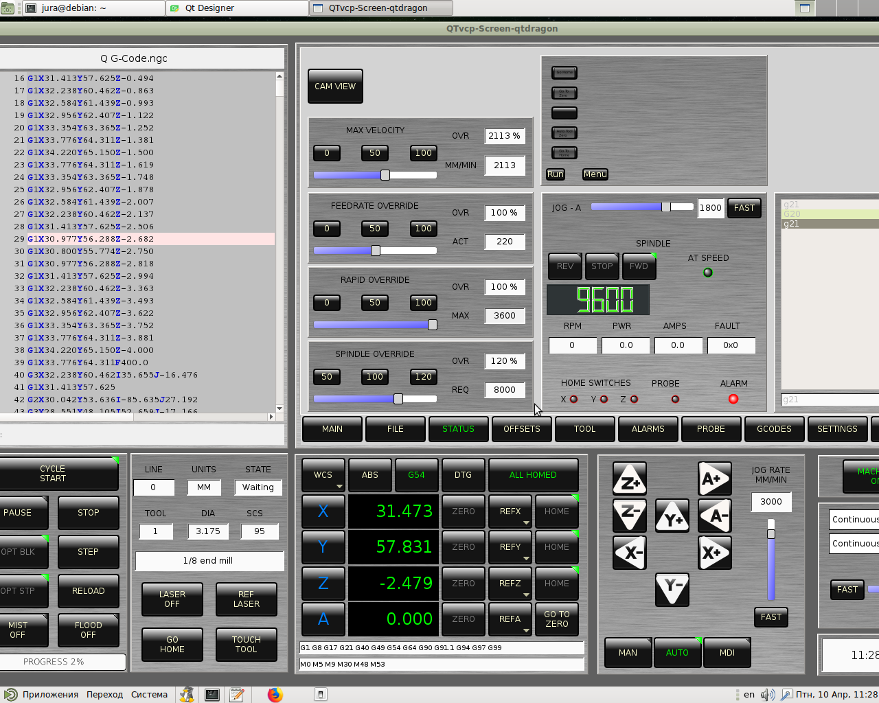

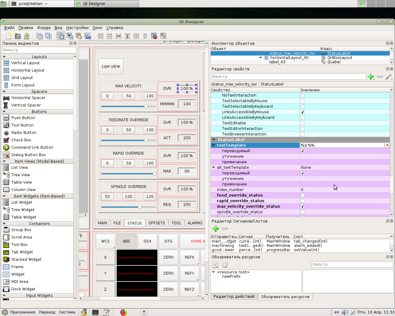

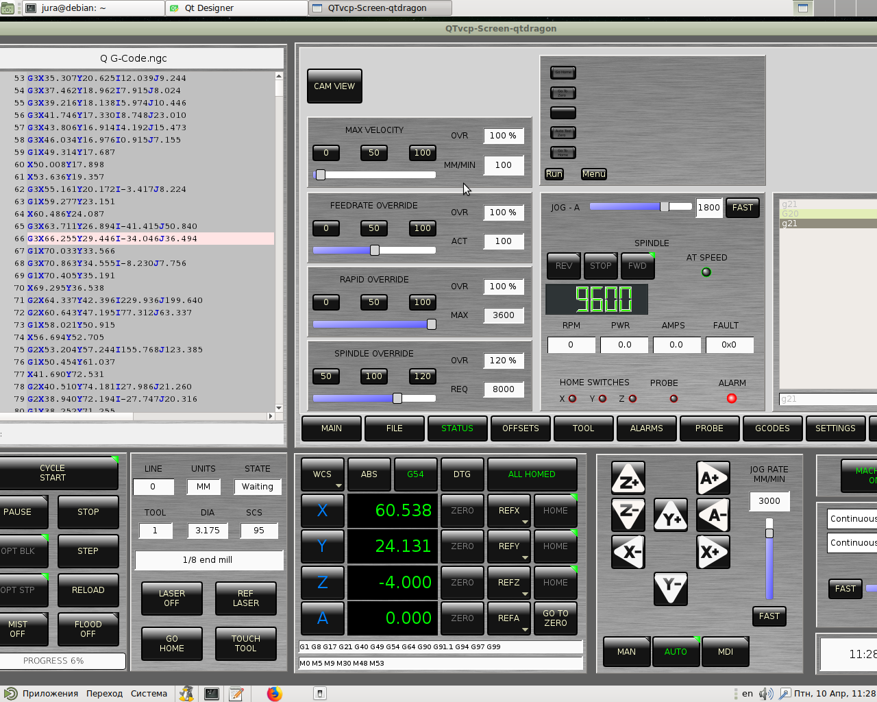

There is no Max_velocity_override adjustment in the Qtvcp interface. I added a panel. The slider adjusts the speed correctly, but I can’t adjust the percent. Status max_vel_ovr vibran.
Please tell me what is wrong.

In Qtvcp (and others screens), max velocity is in absolute units per minute, not percent.
You could build what you want but it would require python programming.

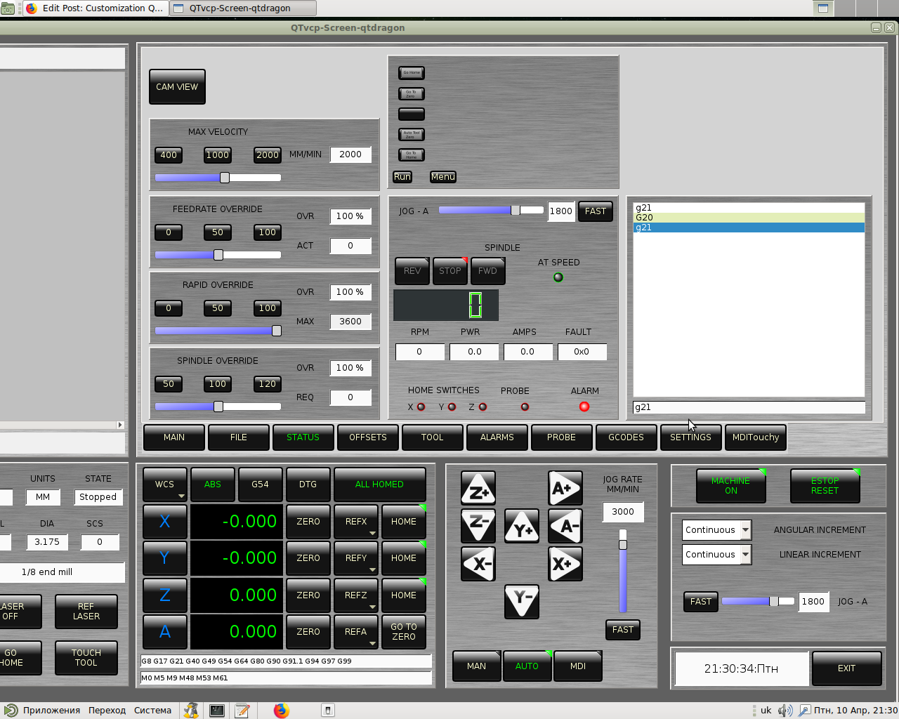

Can you do something with this? The question is closed. I assigned the necessary speeds to the buttons and everything works. Thanks for the consultation!

To add a max velocity slider.
add a QSlider with designer called 'mvPercent'
then in your handler file:
def initialized__(self):
self.w.mvPercent.setMaximum(100)
STAT.connect('max-velocity-override-changed', lambda w, data: self.w.mvPercent.setValue((data / INFO.MAX_TRAJ_VELOCITY)*100))
self.w.mvPercent.valueChanged.connect(self.setMVPercentValue)
# GENERAL FUNCTIONS #
def setMVPercentValue(self, value):
ACTION.SET_MAX_VELOCITY_RATE(INFO.MAX_TRAJ_VELOCITY * (value/100.0))

Thank you so much! Very good as a basic option. It’s more convenient for me
actual speed value on the button.

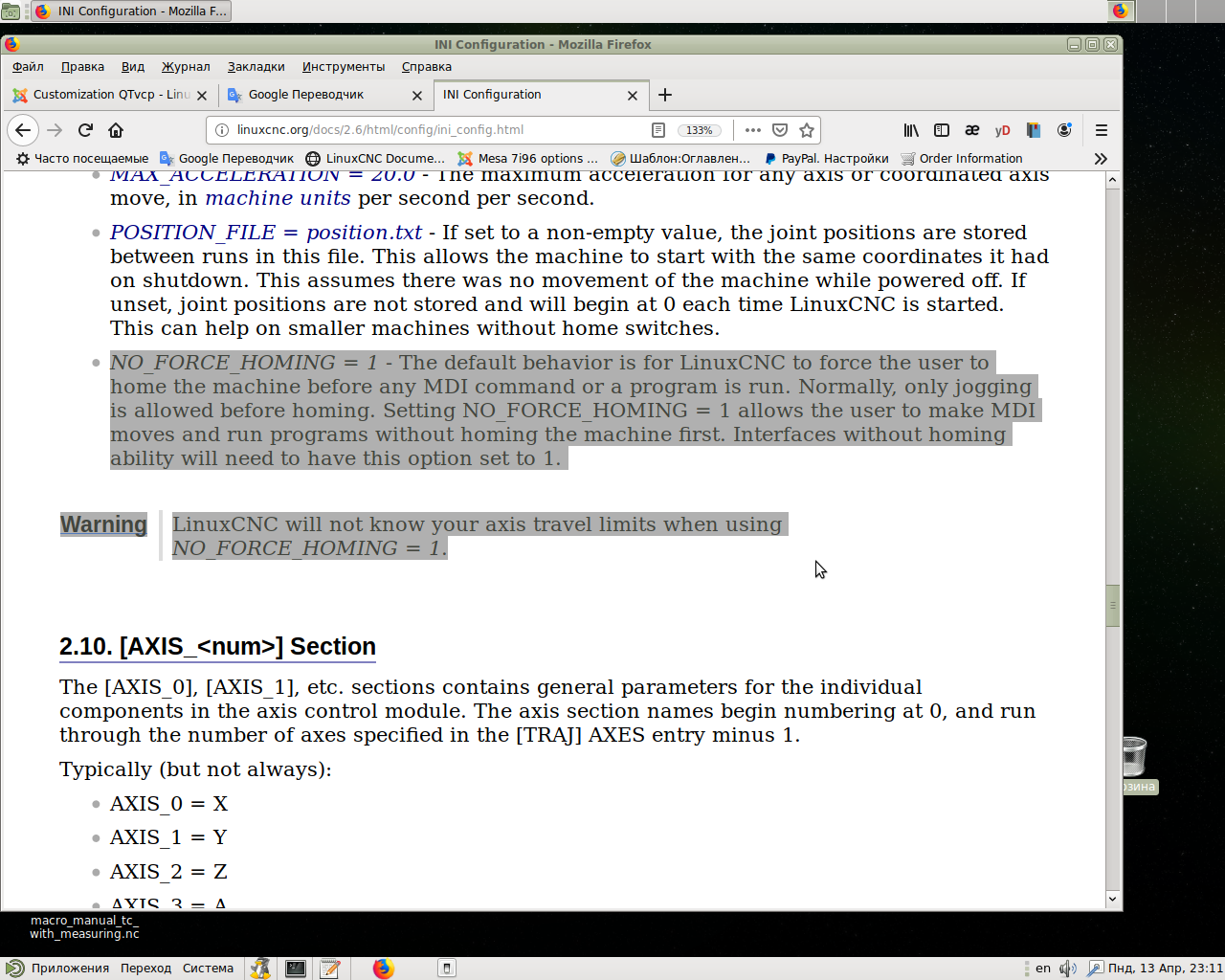

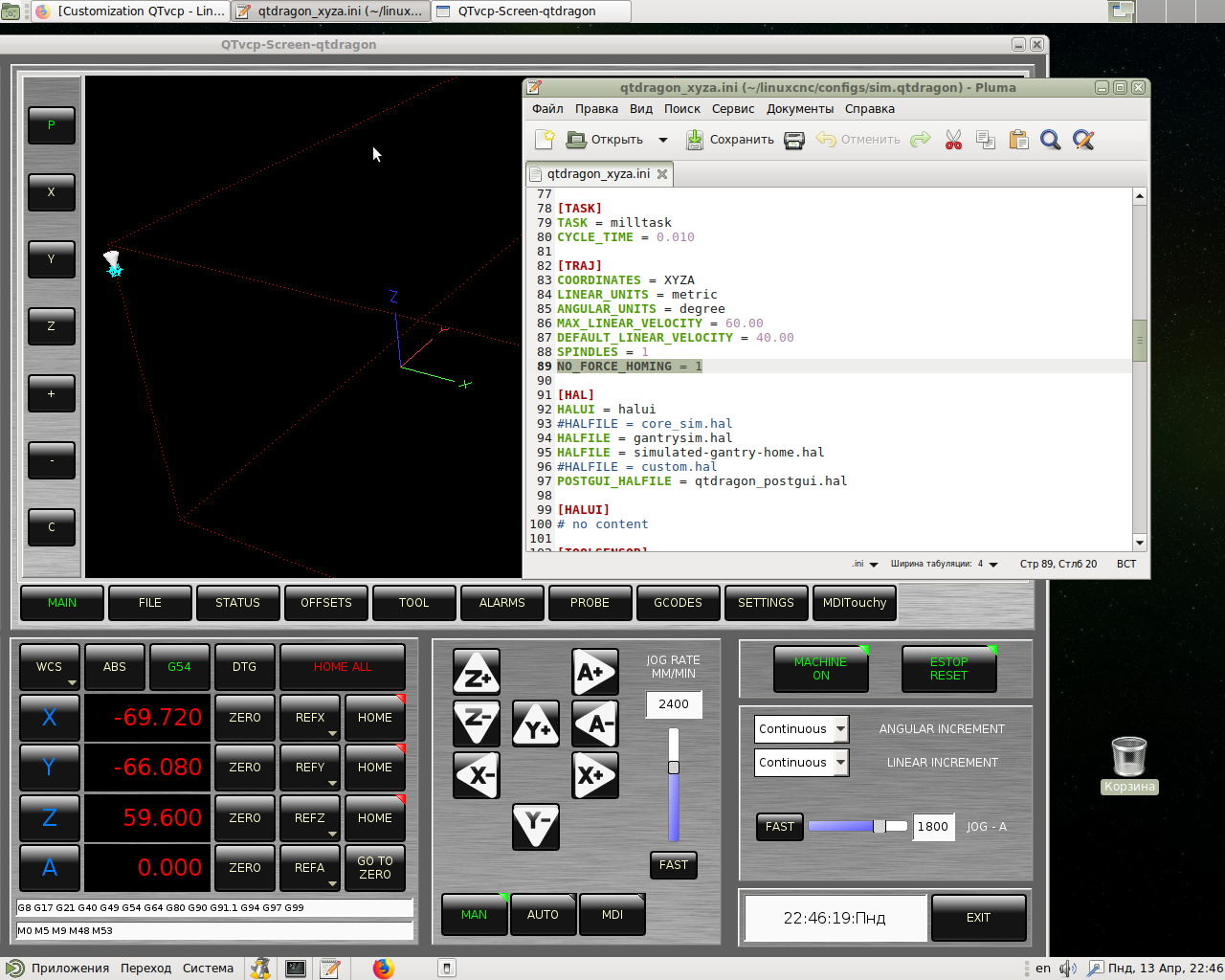

File ini / TRAJ - NO_FORCE_HOMING = 1. At start, the tool position is the same
as exit, Home_All button green, the interface is active but does not work like that. How to fix please tell me.

I'm looking into this. I see it complains when you select the MDI line, but I can't find the source of that complaint....

At start qtdragon G54 should beat X = 0, Y = 0, Z = 0. Button Home All = All Homed. Homing mode no. Can I do this?
