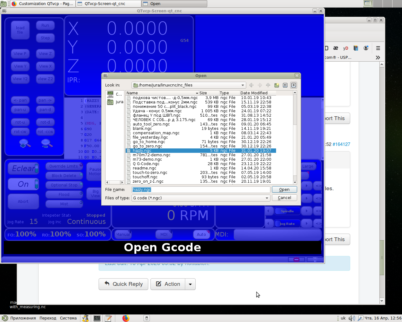

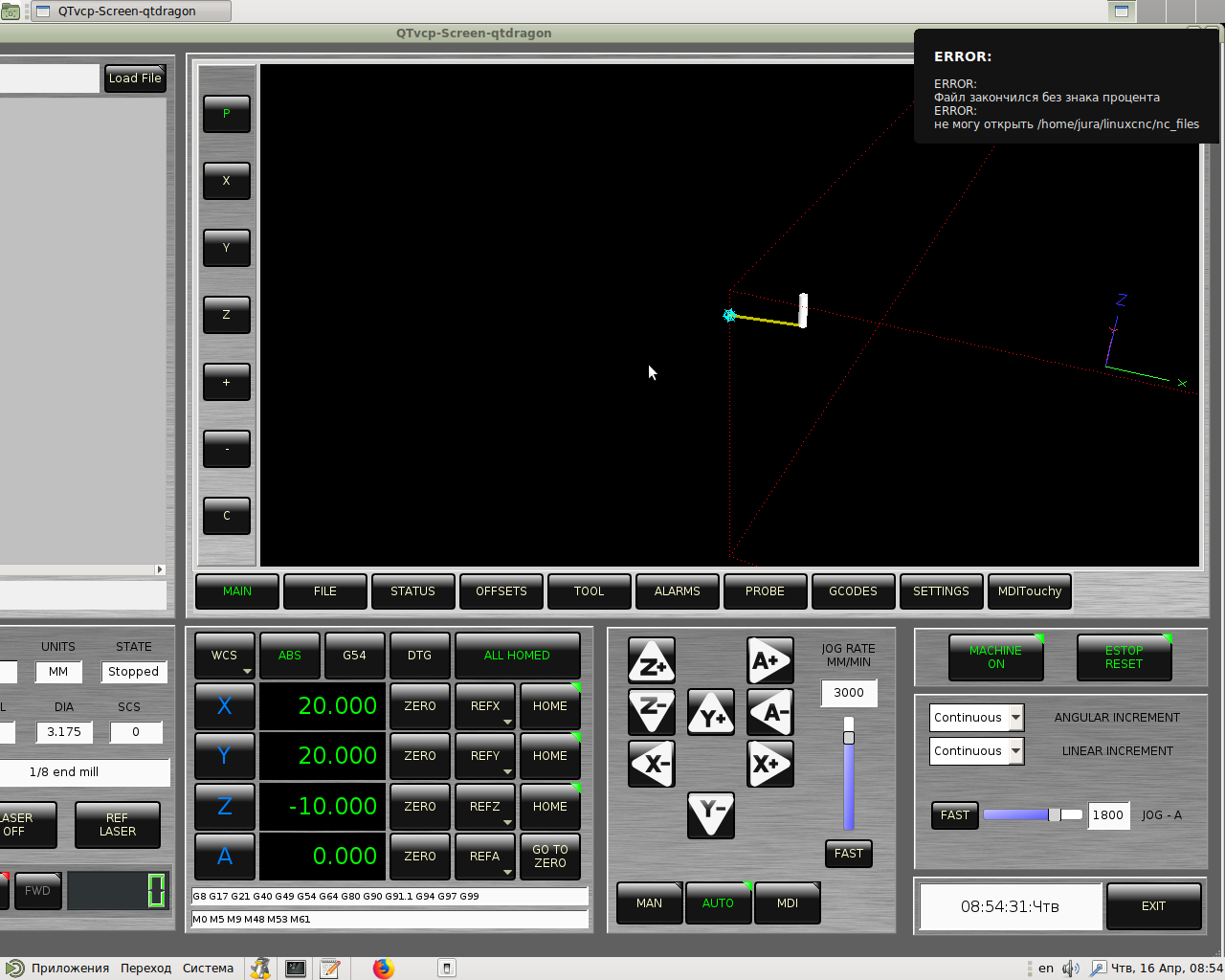

Load dialog action. Load file all OK. Exit. Start error: file ended without a percent sign. Maybe because there is still a file manager? File manager all OK.Please, your advice.

Gcode file needs % sign at the beginning and at the end.

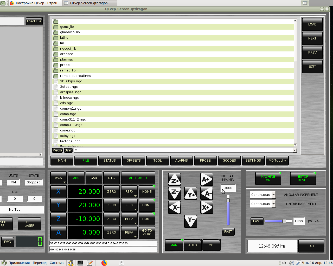

The same file downloaded through the file manager is OK.
In other Qtvcp interfaces, the Load dialog action does not display the error of the same files.
Typically, the file ends with M2.

i don't know where to start. I tried your hazzy program and it loads fine here.
When you load the file, does it the gcode look right?
Have you loaded a macro before loading the program?

I added action button load_dialog_action in qtdragon. When downloading a file through a pop-up window, I get an error. File Manager from the page
File uploads work well. Why is that? See post 164116, 164127.
Last edit: 16 Apr 2020 19:08 by hottabich.
