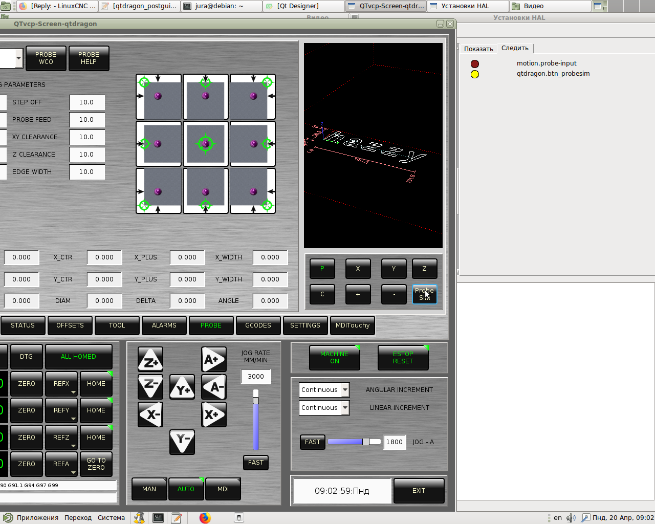

There is an interesting question. I added Plot to the Probe page. Why are two GcodeGraphics conflicting? And is there a possibility to add a button in Qtvcp
ProbeSim?
ProbeSim?

19 Apr 2020 06:07 #164595
Replied by cmorley on topic Сustomization QTvcp
plotting uses a fair amount of process power. There is a special widget to move other widgets from place to place. QtDefault demonstrates this with the 'big view' button. it cycles the display by moving widgets around.
This might be better way to do it - its a little complicated. I'll have to refresh my memory on the widget.
I have not tried two plotters so I don't know what the problem is.
add a button for what?

19 Apr 2020 06:17 - 19 Apr 2020 06:26 #164597
by hottabich
Replied by hottabich on topic Сustomization QTvcp
Launch my interface and switch the visualization p, x, y, z and also move
picture in the window. Everything is necessary for checking Probe in simulator. ProbeSim mimics
(probe in). (QtDefault demonstrates this with the 'big view' button. it cycles the display by moving widgets around.)
If so make it super!

19 Apr 2020 06:55 #164602
Get a button to call this function when pressed and released.
def SimProbeButton(self, state):
if state:
hal.set_P('motion.probe-input','1')
else:
hal.set_P('motion.probe-input','o')

19 Apr 2020 08:11 #164606
Here is proof of concept.
I modified qtdragon.ui and qtdragon_handler.py
When you switch tabs it automatically moves the plotter to the right spot by calling the function switch()
The special widget is called widgetswitcher.

20 Apr 2020 06:22 - 20 Apr 2020 10:13 #164774
by hottabich
(net btn_probesim motion.probe-input qtdragon.btn_probesim).
Created the btn_probesim button in qtdragon_postgui.hal added (net qtdragon.btn.0.probesim => motion.probe-input). Motion.probe-input does not work, qtdragon.btn_probesim works. Please tell me what's wrong? Excuse for troubling. The question is closed. Everything is working. In qtdragon_postgui.hal addedGet a button to call this function when pressed and released.
def SimProbeButton(self, state): if state: hal.set_P('motion.probe-input','1') else: hal.set_P('motion.probe-input','o')

- Posts: 7368
- Thank you received: 2181
20 Apr 2020 17:18 #164874
Ok if you use your solution then you don't need the'SimProbeButton' function I posted
Your probe tab looks good!
