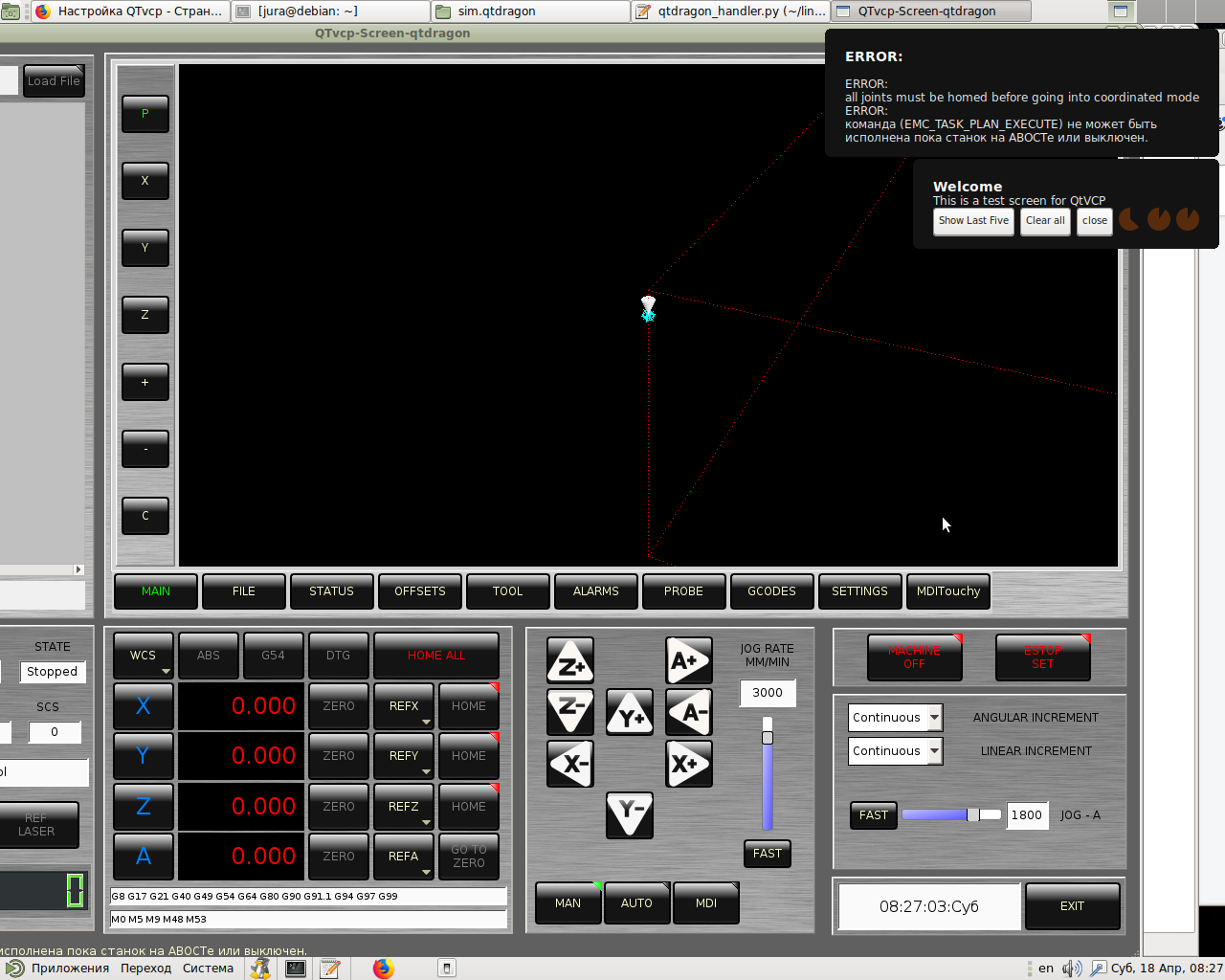

At the start of qtdragon. This is not a mistake; this is a warning, isn’t it.

Replied by hottabich on topic Сustomization QTvcp
You mentioned the widget, I realized that this applies toahh did you move or did it ask to move the QtTouchy config?
It can't find the file: ../check_constraints.hal file
It' s in the sim/qtvcp_screens folder by default
qtdragon.
- Posts: 7368
- Thank you received: 2181
18 Apr 2020 05:37 #164410
Replied by cmorley on topic Сustomization QTvcp
It's a error because qtdragon tried to do something that it cannot do.
How did you cause it?

I registered self.w.mditouchy.run_command () in qtdragon_handler. Section init_widgets (self):
- Posts: 7368
18 Apr 2020 05:55 #164412
yes no good.
you must call self.w.mditouchy.run_command () only when the MDI command is to be run.
To make the cycle start button run MDI, Try this (I didn't test it):
def btn_start_clicked(self):
if STATUS.is_mdi_mode():
self.w.mditouchy.run_command()
return
if self.w.main_tab_widget.currentIndex() != 0:
return
if not STATUS.is_auto_mode():
self.add_alarm("Must be in AUTO mode to run a program")
return
self.w.btn_start.setProperty('running', True)
self.w.btn_start.setStyle(self.w.btn_start.style())
start_line = int(self.w.lbl_start_line.text().encode('utf-8'))
self.add_alarm("Started program from line {}".format(start_line))
ACTION.RUN(start_line)

Thanks It works!! I’ll check in more detail later. Unsubscribe if something is wrong. Thanks again!!!
