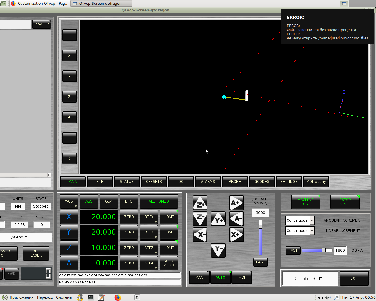

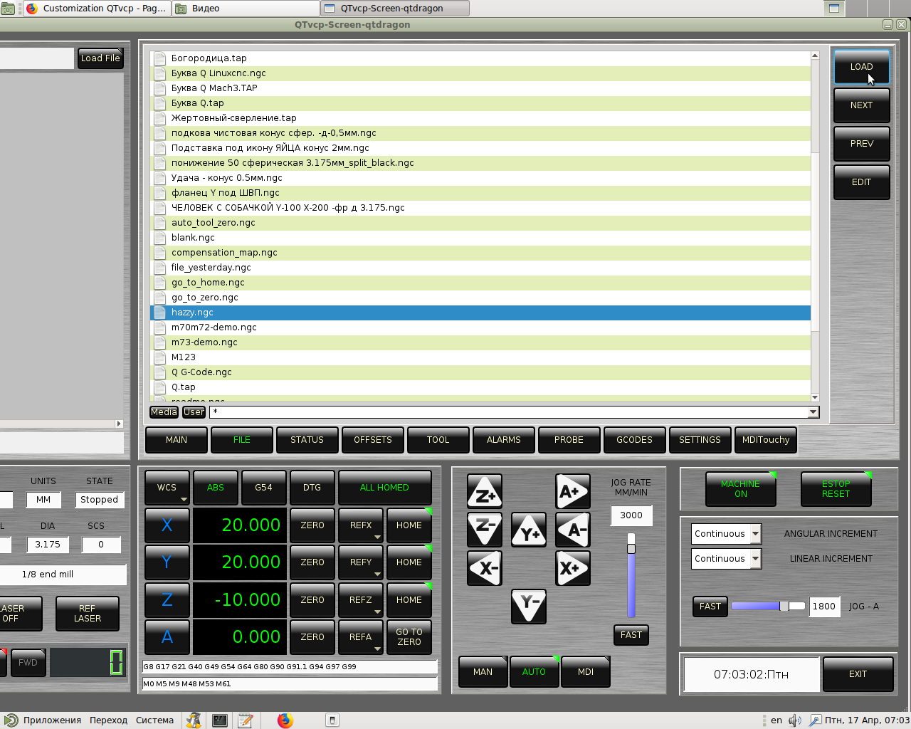

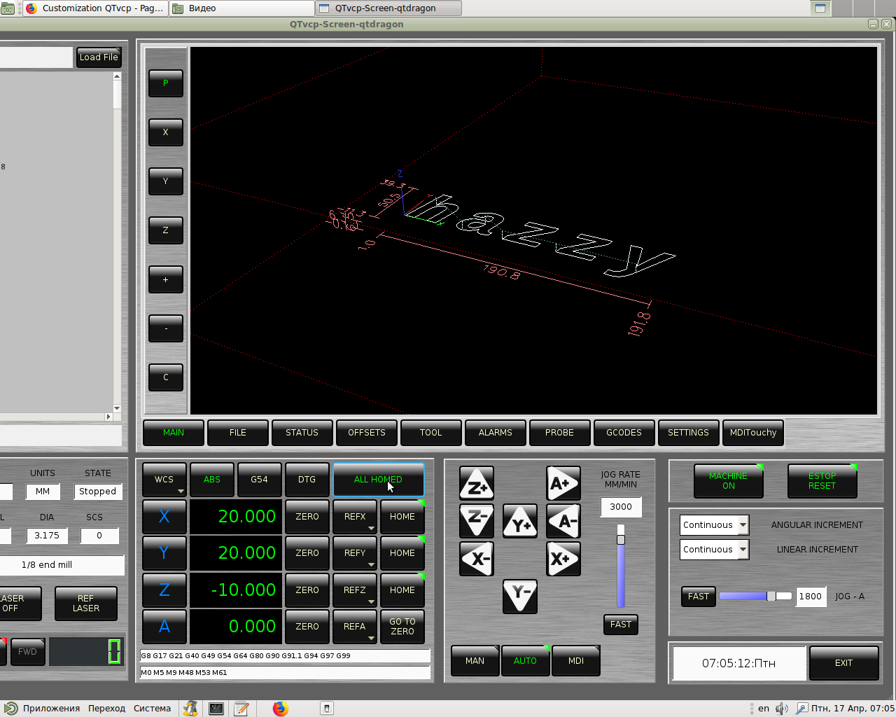

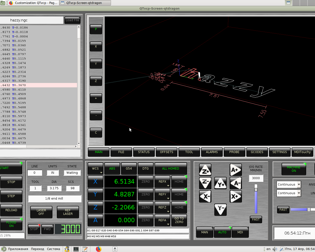

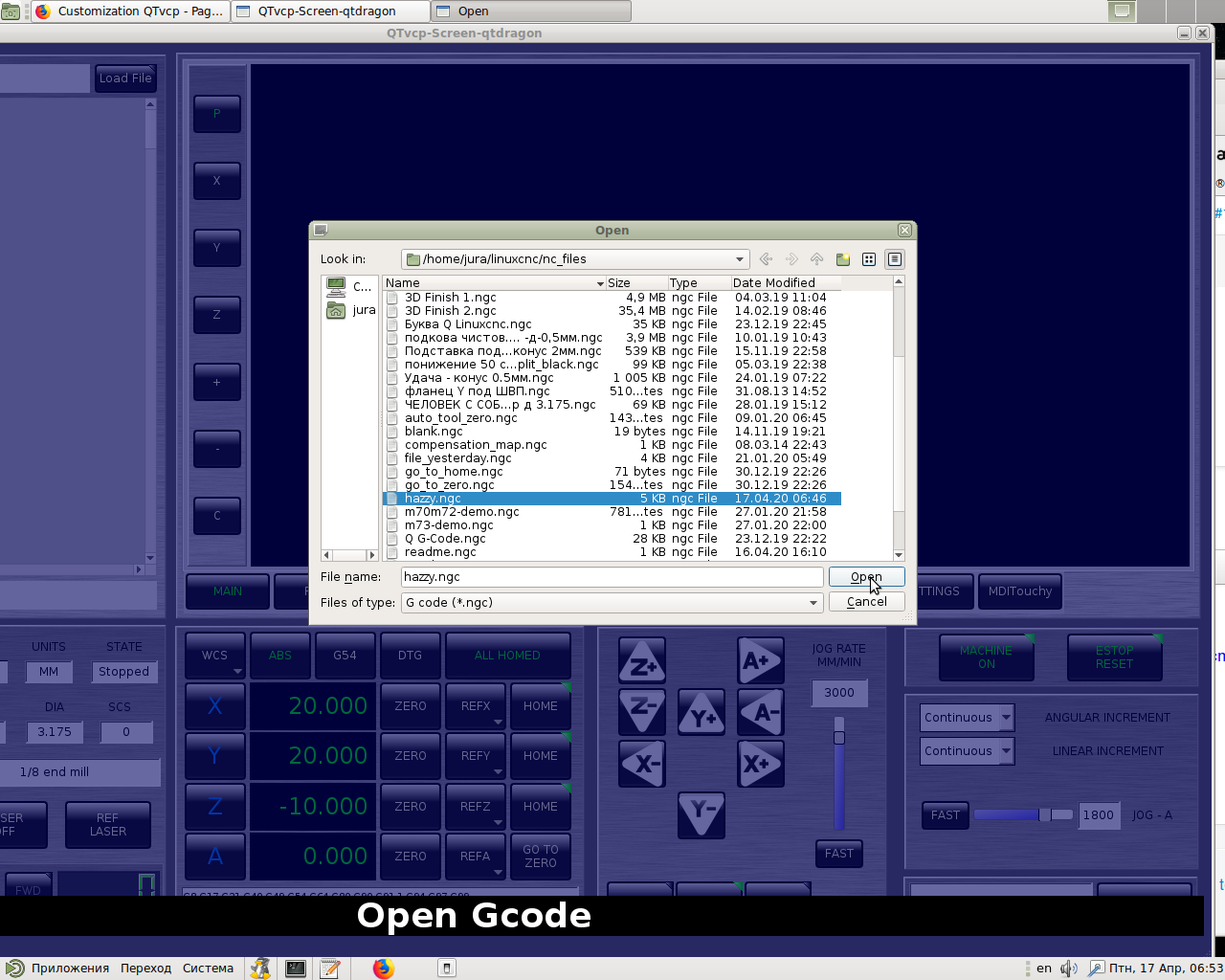

The hazzy.ngc file for an example with percent at the end of the file. This happens with all files. Start qtdragon, load_dialog_action, cycle start, all OK. Exit qtdragon,
start qtdragon, clicked Home All Error: file ends without a percent sign, but he is.
File manager, Load, all OK. See screenshot
Last edit: 17 Apr 2020 04:35 by hottabich.

Can you add -d to INI change :
[DISPLAY]
DISPLAY = qtvcp -d qtdragon
Start the screen load with button/dialog , shut down and post the log file:
dtdragon.log should be in the config directory.
Then do again loading with the tab file manager and then post the log file again.
Hopefully I can see a difference. It could be a language conversion problem - I wouldn't see that problem on my computer.
Chris

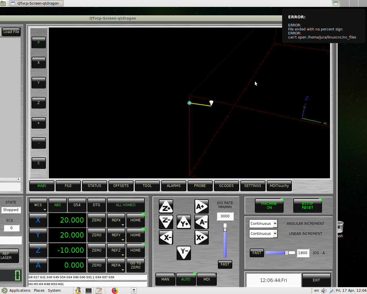

Here's what happened. Why is the mistake in Russian? Maybe translate the translator
to English? Or all Linux Debian to change the language. In english too Error.

Check what file it is trying to open on startup, it should be in the ini file as
open_file=xxxxxxx

Replied by tommylight on topic Сustomization QTvcp
I can read Russian quite good, so it is saying that it can not find the folder
/home/jura/linuxcnc/nc_files
Somewhere in the configuration files it has an entry for opening something from there, or might need adding / at the end of that line.

Correctly he searches for a sung path lies the hazzy file and all the rest.
OPEN_FILE = blank.ngc is ignored. And so that by default nothing is loaded, how can one do this in Qt axis?

The subroutine path is wrong in the ini.
remove ~ and add /home/jura
And why is it looking for probe_basic files there?
You are using QtVCP, not PyQtVCP.

Found where the error is. How are you Chris with this file, load_dialog_action save in
examples and then there he searches for the error too.
