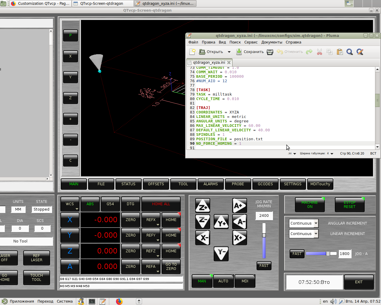

13 Apr 2020 20:32 #163899 by cmorley
Replied by cmorley on topic Сustomization QTvcp
All_homed button indicates if the machine is homed. If you don't home then it indicates this - there is no way around this.
You can use linuxcnc without homing, but it is not recommended.
starting with x0 y0 z0:
from documentation:
POSITION_FILE = position.txt - If set to a non-empty value, the joint positions are stored between runs in this file. This allows the machine to start with the same coordinates it had on shutdown. This assumes there was no movement of the machine while powered off. If unset, joint positions are not stored and will begin at 0 each time LinuxCNC is started. This can help on smaller machines without home switches. If using the Mesa resolver interface this file can be used to emulate absolute encoders and eliminate the need for homing (with no loss of accuracy). See the hostmot2 manpage for more details.
in [TRAJ] header remove POSITION_FILE=

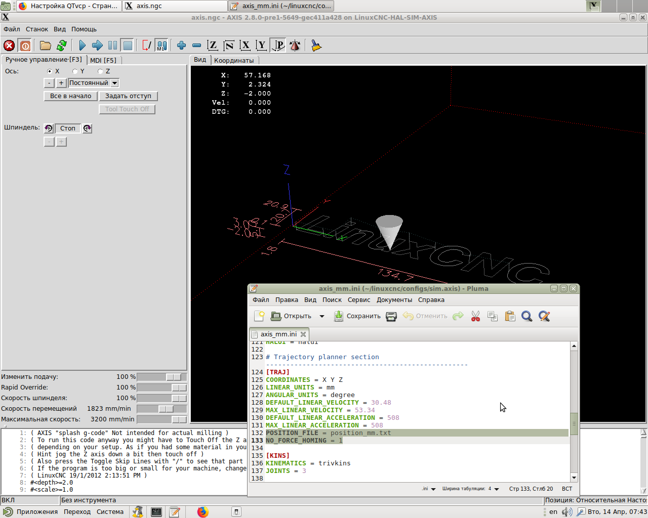

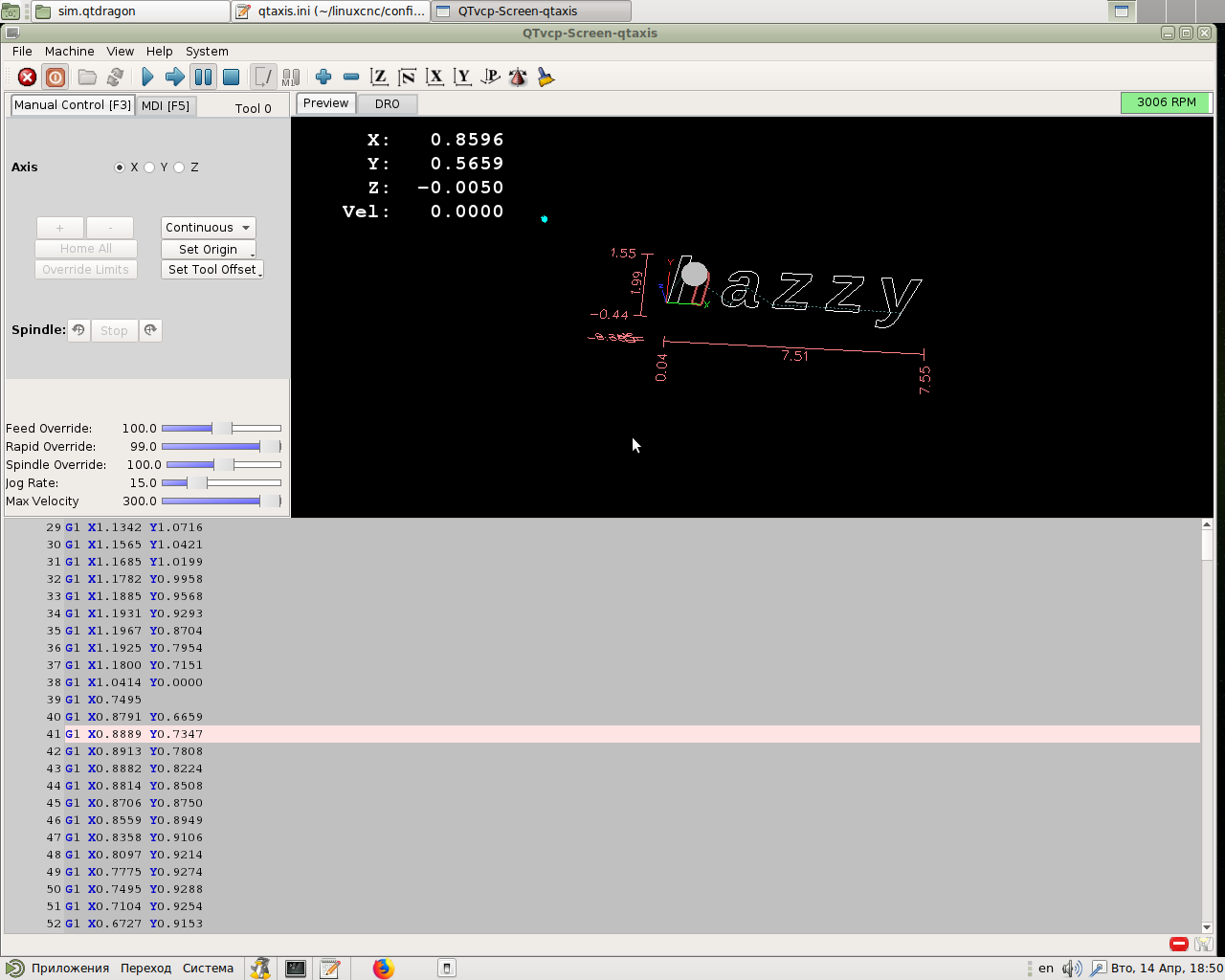

14 Apr 2020 04:58 - 14 Apr 2020 15:53 #163922 by hottabich
Replied by hottabich on topic Сustomization QTvcp
Axis keeps the position, I can continue the program. And QtDragon
no and the interface is locked. Qtaxis also works.

15 Apr 2020 04:00 #164017 by cmorley
change:
[KINS]
KINEMATICS = trivkins coordinates=XYZA kinstype=BOTH
to
[KINS]
KINEMATICS = trivkins coordinates=XYZA kinstype=1

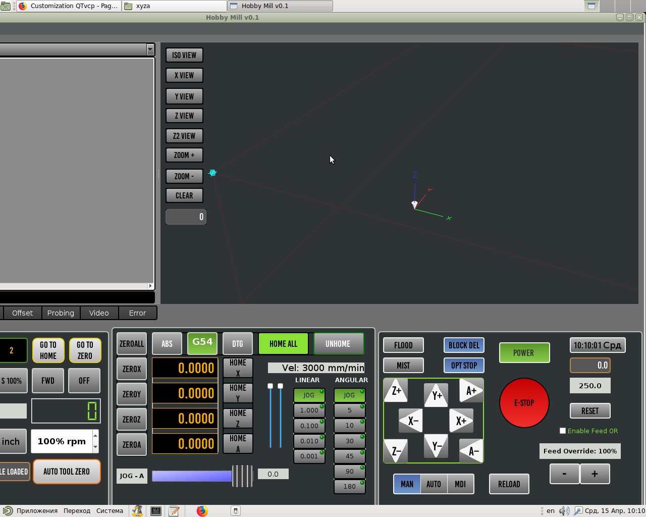

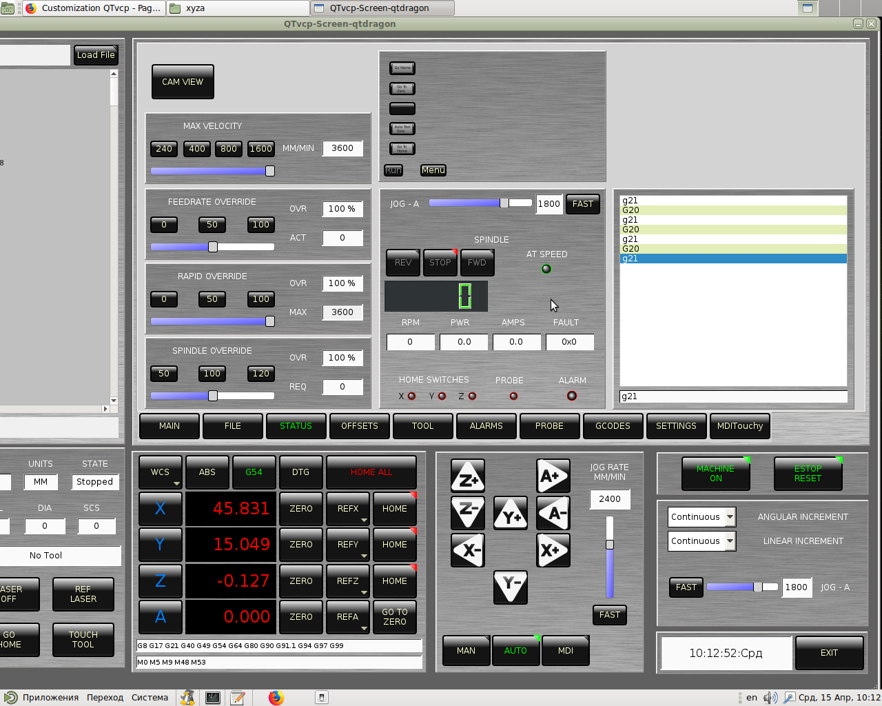

15 Apr 2020 07:23 - 15 Apr 2020 07:28 #164026 by hottabich
Thank you! Does not load the file, it needs reload, macrotab (run) does not work. Position saves. In the screenshot how it works in qtpyvcp.
Last edit: 15 Apr 2020 07:28 by hottabich.
15 Apr 2020 07:51 #164028 by cmorley
to stop position being saved:
#POSITION_FILE = position.txt
does not load the file:
I don't understand.
macrotab does not run:
Ok I'll test to see why.
15 Apr 2020 08:34 - 15 Apr 2020 08:40 #164035 by hottabich
All Homed is missing as in Qtpyvcp. All Homed will decide everything at startup.
