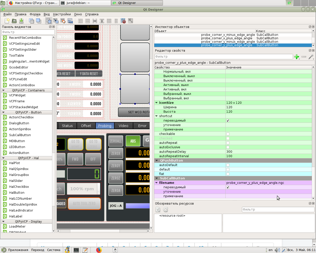

The name macros is assigned to the button in the designer. Here is my simulator config. Everything is simple and good. Thank! If you find time, you can watch my hobby_mill

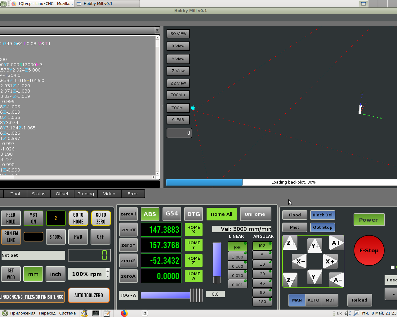

Hello! After updating Linuxcnc 2.8-pre. default spindle speed became 200 when the spindle started in man mode. Please tell me how to fix this? And another question, progress bar in is not enough gcode graphics when downloading large files. This can be added or please tell me how to do it in a particular case.

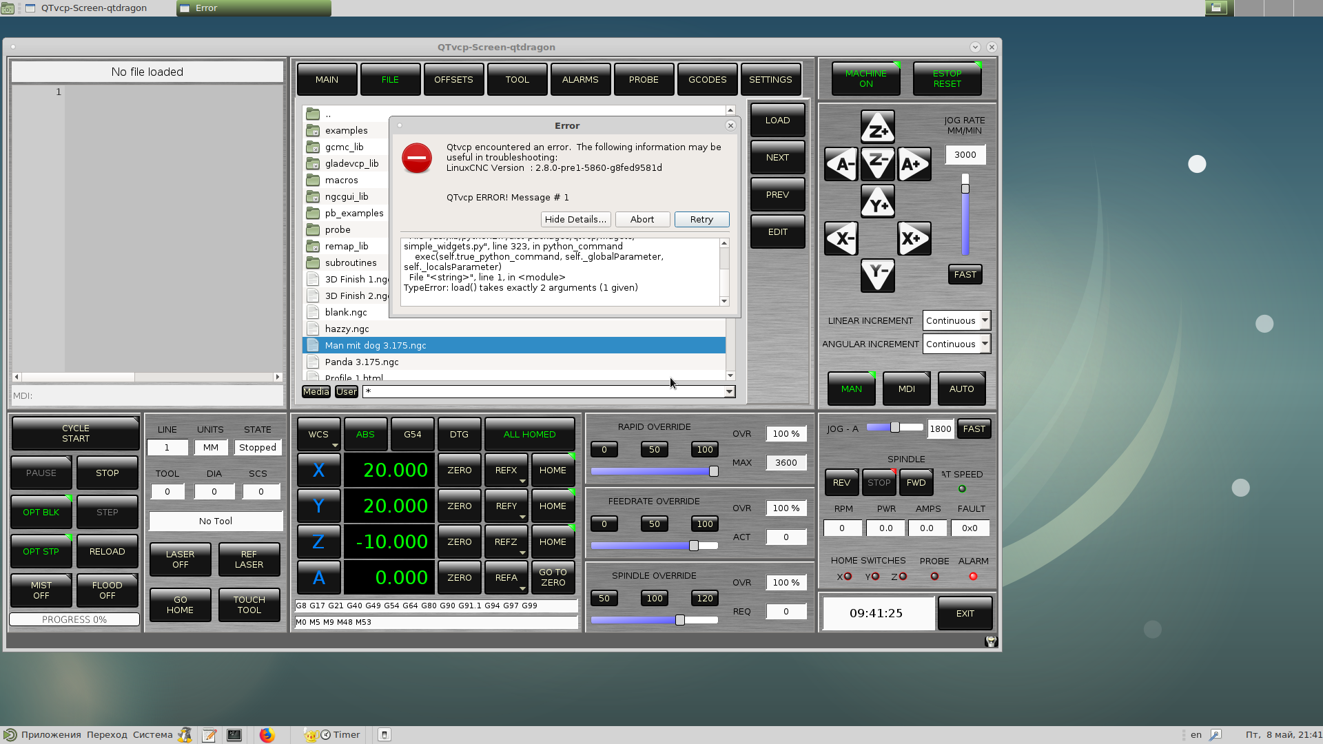

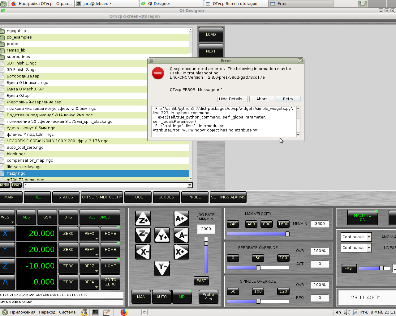

Thank! Is there no way to add a progress bar to gcode graphics? The above code is taken from gcode bakplot. Here is another error after updating when downloading a file. There is no error through the load dialog.

Do you have a button that uses python command (added in designer) for loading a selected file from file_manager?
The function used to be .load()
try changing it to:
INSTANCE.w.file_manager._getPathActivated()
Currently there is no way to get the progress of file loading.
try changing it to:

08 May 2020 15:13 - 08 May 2020 15:20 #167073
by hottabich
Replied by hottabich on topic Сustomization QTvcp

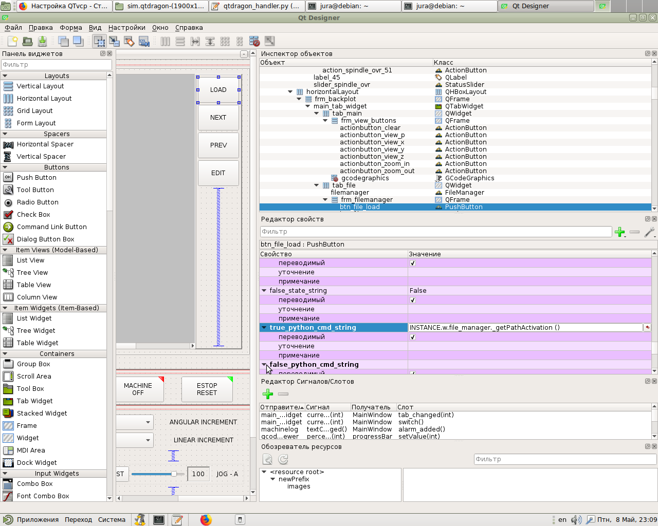

Does not work. If you remove (w) there is no manager.
Last edit: 08 May 2020 15:20 by hottabich.

08 May 2020 15:20 #167074
Replied by cmorley on topic Сustomization QTvcp
What did you have originally?
INSTANCE.file_manager.load() ?
what ever you had change the .load() to ._getPathActivated()
i will fix this problem soon but this will work around it for now.
Chris

08 May 2020 15:34 #167075
by hottabich
INSTANCE.filemanager.load() it beat like that. Thanks for watching, wait.

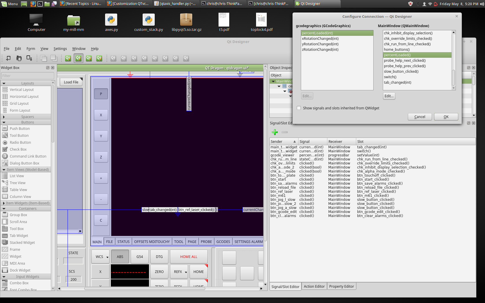

Ok I pushed some work that makes it possible to get a percent signal from the graphics display.
You must connect a signal in designer from the graphics display to the form.
The signal is called percentLoaded
Then make a function in the handler to update your progressbar.
qtaxis shows an example.
You may also connect the signal directly to a progressbar in designer but you will have less control that way.
