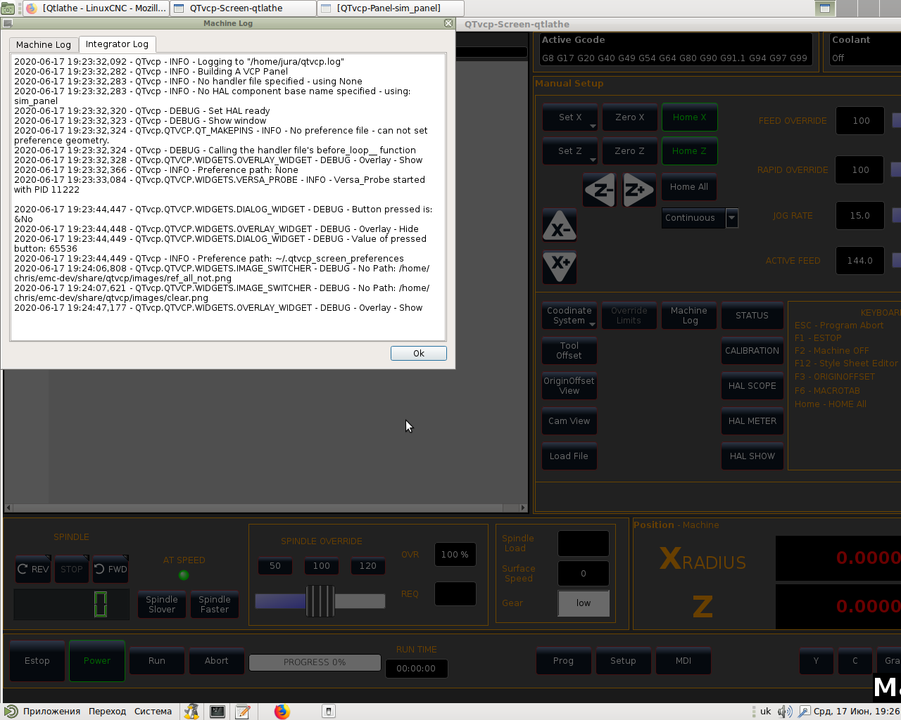

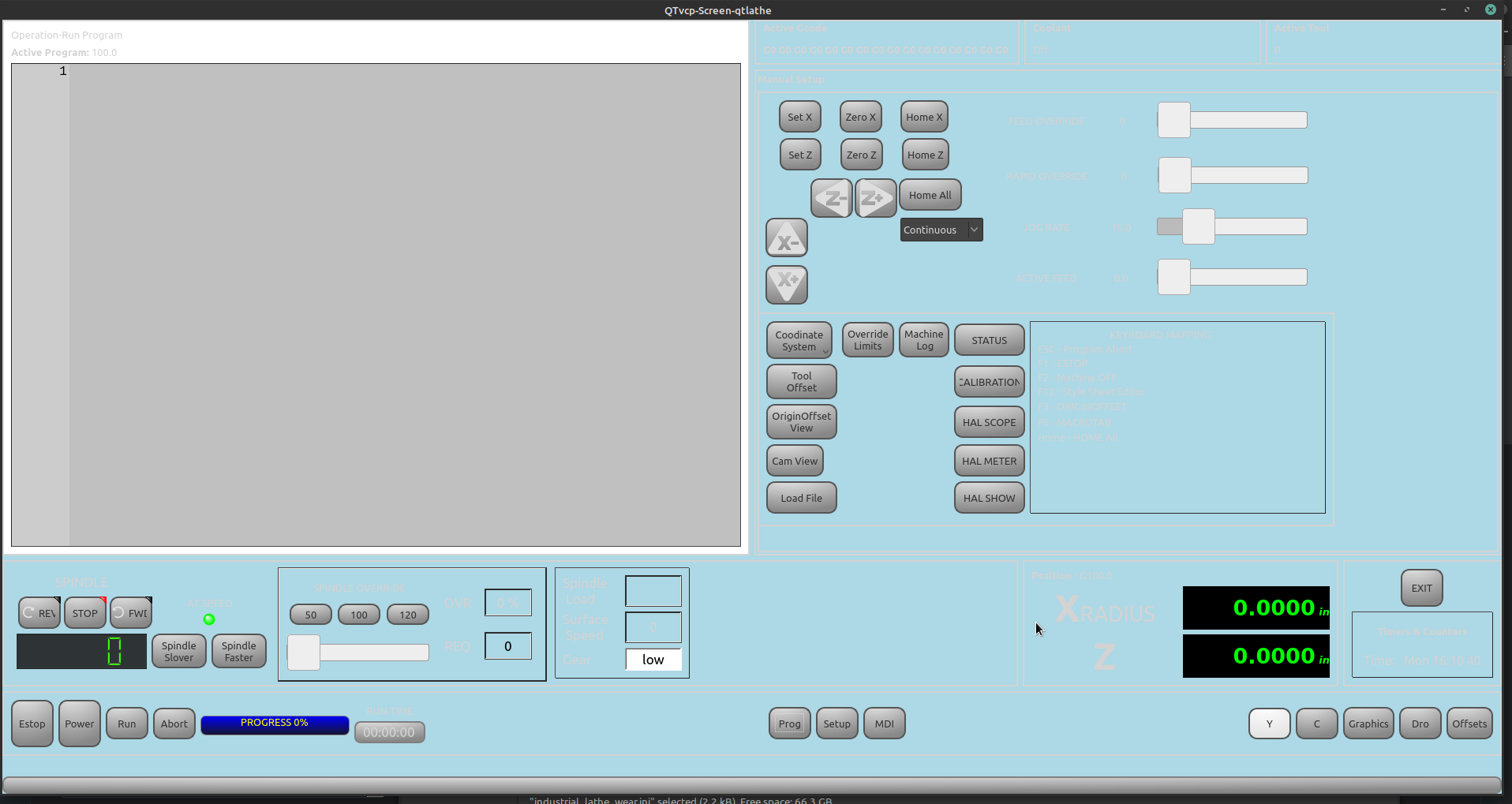

Hello! I really liked the idea of a separate interface for turners. When starting sim.qtvcp_screens.industrial_lathe_wear received an error.
Made his fantasies into the interface. Maybe something will suit you. Users are quite happy
axis with the plugin, but they lack the normal buttons. I did not touch the handler. Tell me please
What is Spindle Load?

15 Jun 2020 10:31 - 15 Jun 2020 10:34 #171749
by hottabich
Replied by hottabich on topic Qtlathe

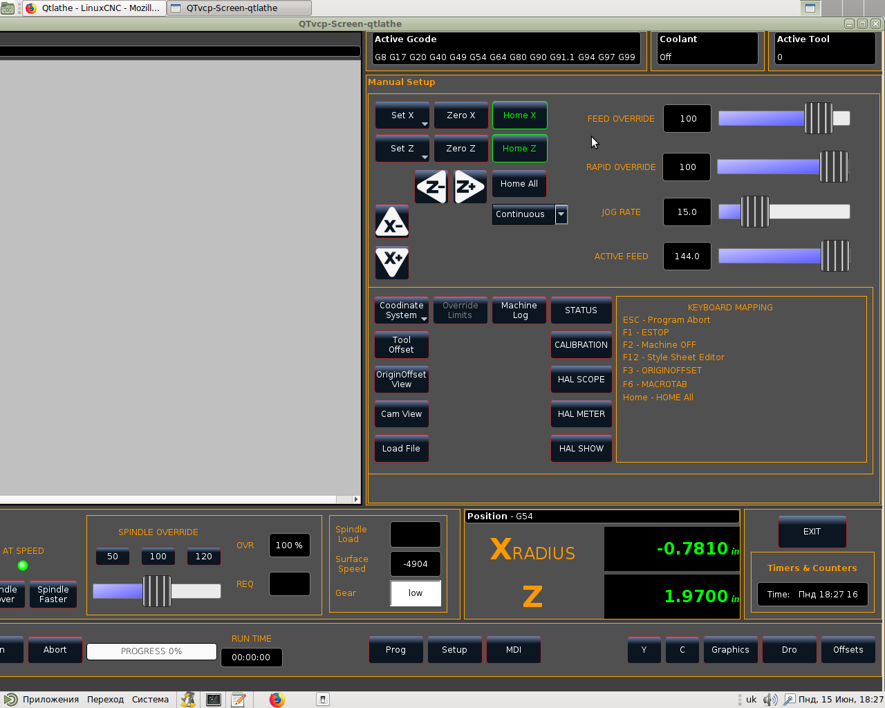

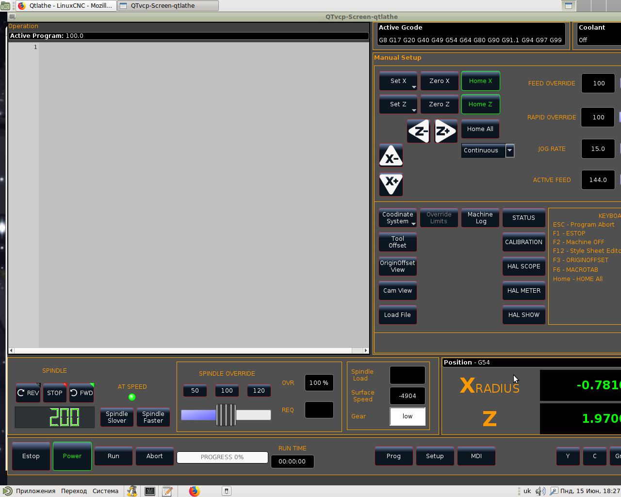

That's how it looks at me. The monitor is only small. Write the paths to the pictures and the macro. Why do I have a mistake?

Replied by cmorley on topic Qtlathe
I didn't realize I pushed the industrial_lathe screen - it was to be roughly patterned after HAAS screens but I got away from developing it.
The error has been fix - you just need to update.
spindle load is the current power the spindle is using

15 Jun 2020 20:39 #171805
That looks very good.
I don;t understand - what mistake?

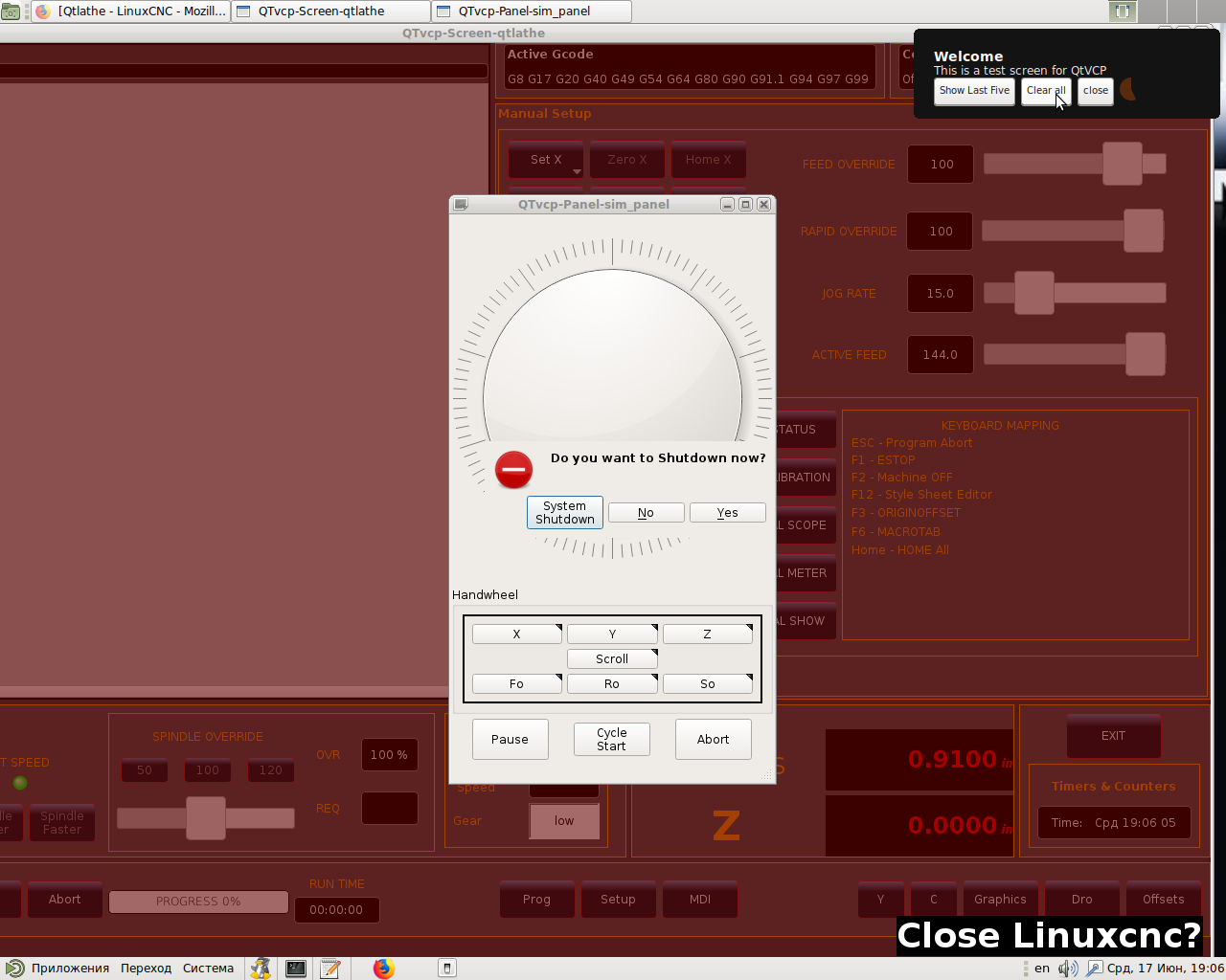

17 Jun 2020 11:18 - 17 Jun 2020 11:26 #171910
by hottabich
Hello! Thank you for the attention. I meant the error from the first post.

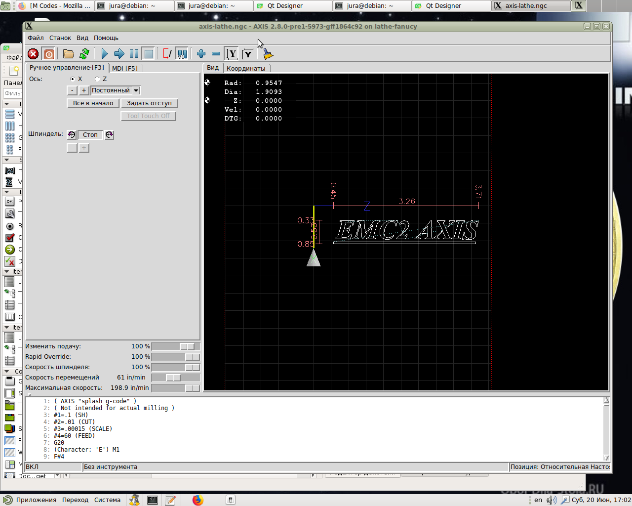

After the update, she was gone but a new one appeared. At startup, I see the following as in the screenshot. Functional I look at sim.axis.lathe-fanucy.
Please tell me how to add dro diametr? Are you developing industrial_lathe screen? I cannot handle the handler.

17 Jun 2020 21:30 #171963
That message is expected - when machine is estopped - it asks if you want to close.
Since the screen starts estopped that message is displayed. I know it's a bit odd, I just had not got around to fixing it.
The dro will automatically display diameter in X axis, when in G7 mode
If you want diameter display always displayed, then I would need to add that ability.

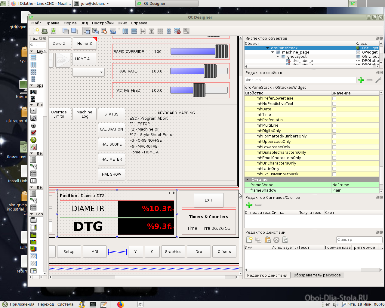

Thank. Good bi add tab dro: Position -Diametr, DTG.You can still add set-view Y -negative as in lathe-fanucy. I could not.In the designer, I added a table dro, but how to add it to the handler?

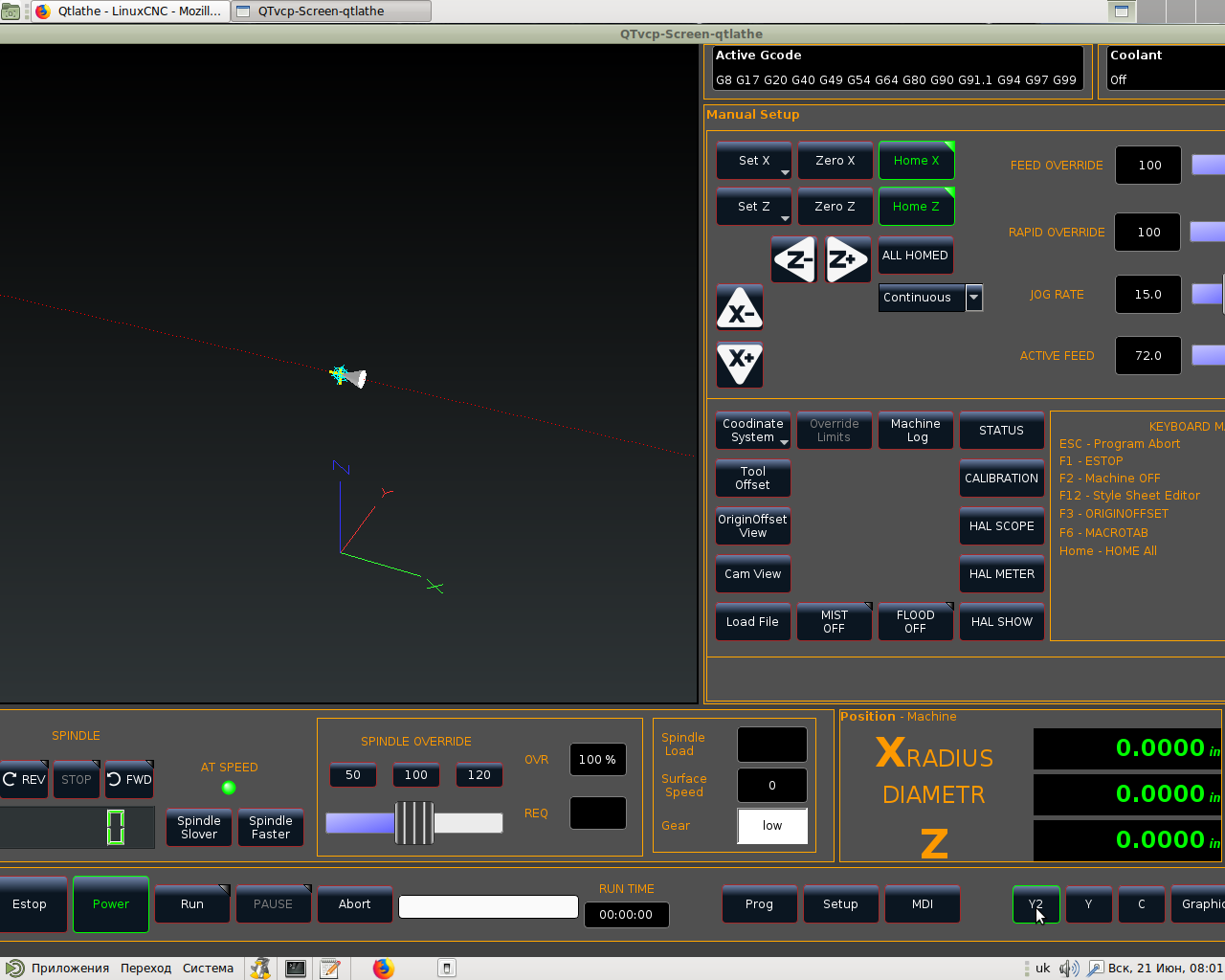

try y2 in designer, it requires [DISPLAY] LATHE = true in the INI
There is a new option in dro_widget: 'always_display_diameter'

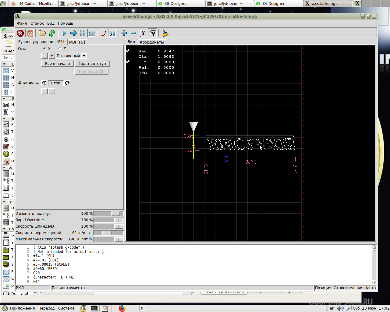

- hottabich
- Posts: 574
- Thank you received: 96
20 Jun 2020 23:58 - 21 Jun 2020 01:32 #172215
by hottabich
Thanks for the work you've done. Y2 does not work as it should. If you are satisfied then fork as a test version, the comments and wishes of the turners are very necessary.
