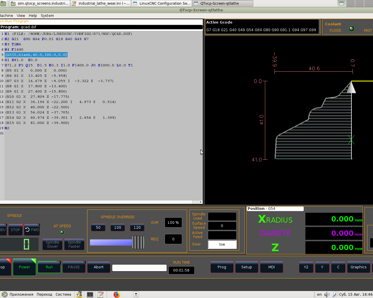

без ошибки. forum.linuxcnc.org/qtvcp/39341-qtlathe?start=80#178354 Download and please run. And you will see everything.
Replied by hottabich on topic Qtlathe
One ignore_m6 remap работаетLine 7 of your gcode doesn't look correct.

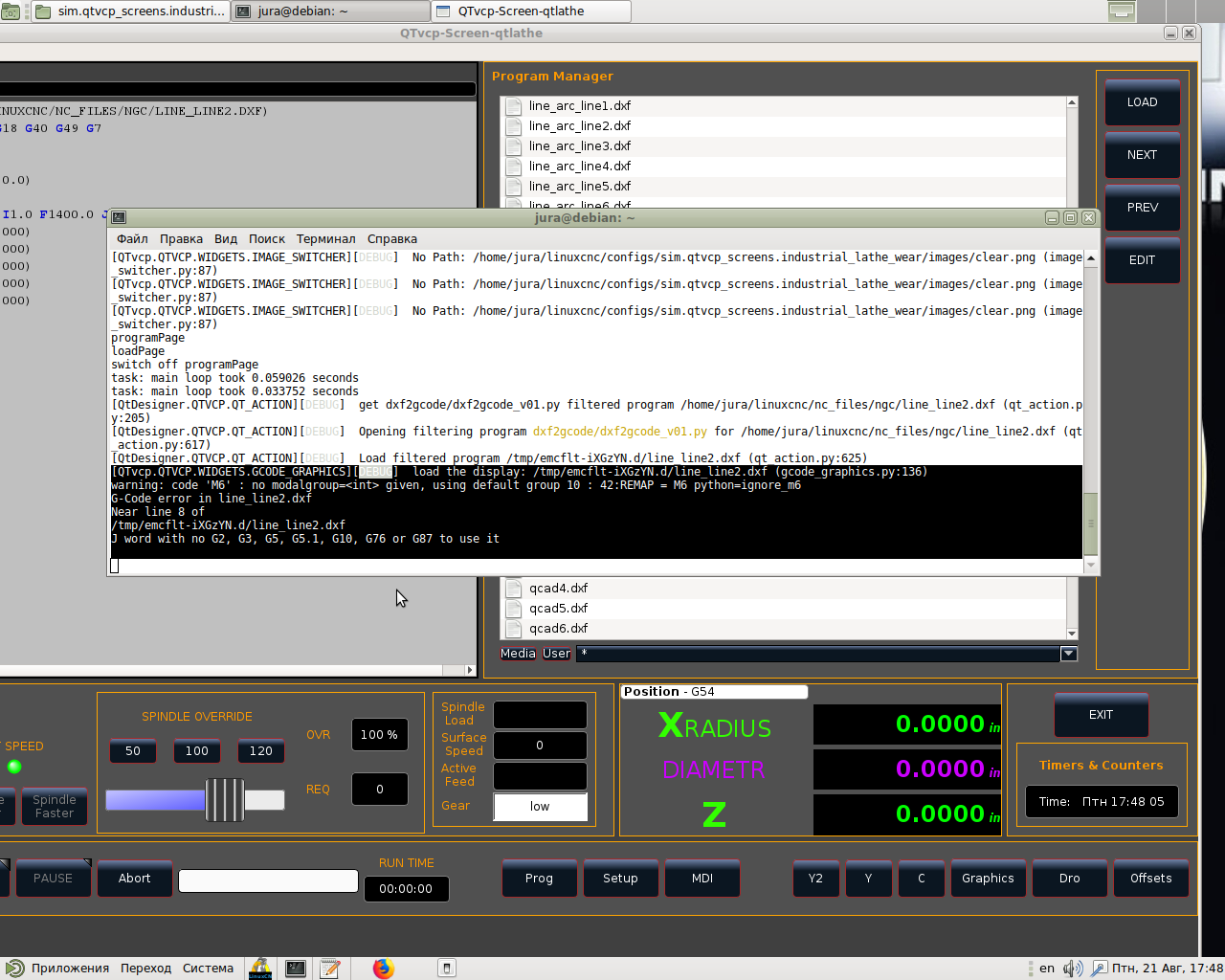

Here's a mistake.please change:
[PYTHON]
LOG_LEVEL = 100
Then see if anymore hints are printed.

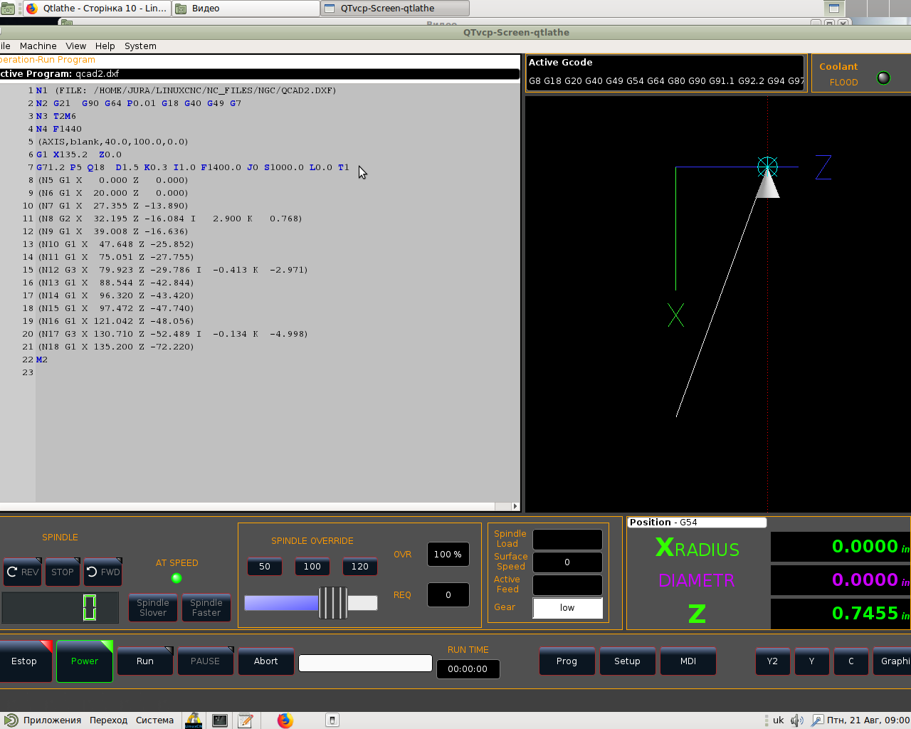

- Posts: 7368
- Thank you received: 2181
20 Aug 2020 23:48 - 20 Aug 2020 23:48 #178893
Replied by cmorley on topic Qtlathe
It's the T code embedded in the G71.2 code.
If you remove it the program runs for me (less the last tool change of course)

Do you mean T1 in line 7 of R_R.ngc? So it doesn't change anything. I cannot get the picture as in the second screenshot.

21 Aug 2020 07:27 #178919
I used your last posted sim files.
I had to fix the remap line for T code:
REMAP = T python=index_lathe_tool_with_wear
After that I get the visualization but it won't run.
When I remove the T1 from line 7 then it will run.
The error:
File "/usr/lib/python2.7/runpy.py", line 174, in _run_module_as_main
"__main__", fname, loader, pkg_name)
File "/usr/lib/python2.7/runpy.py", line 72, in _run_code
exec code in run_globals
File "/usr/lib/python2.7/dist-packages/PyQt5/pyrcc_main.py", line 23, in <module>
from .pyrcc import *
RuntimeError: the sip module implements API v11.0 to v11.3 but the module requires API v12.0
Is about the resource file and seems to be mismatched versions -try removing the resource file.
But that is a separate problem that only affects image files.
Chris
