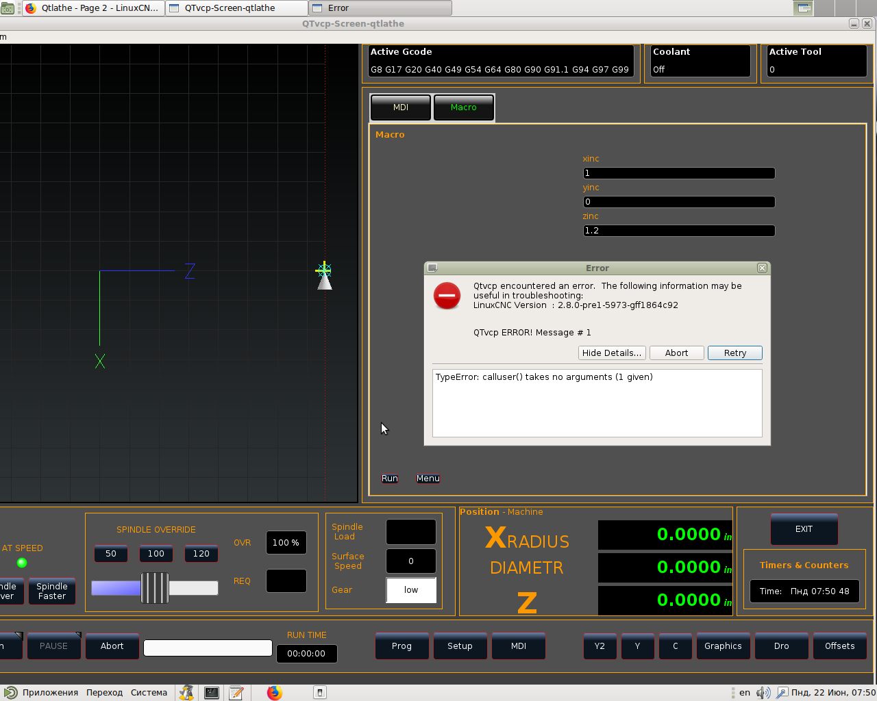

I have many questions, I will ask one by one. Here is the macro_tab error. And if you close the error, the interface closes.
- Posts: 7368
- Thank you received: 2181
22 Jun 2020 07:29 #172332
Replied by cmorley on topic Qtlathe
That is a strange bug. I guess I haven't tested the plain macro widget in a while. The dialog widget seems to work fine.
Working on it.
Working on it.

- Posts: 7368
22 Jun 2020 22:20 #172413
screenoptions: deselect the macrotab dialog.
Then the error goes away

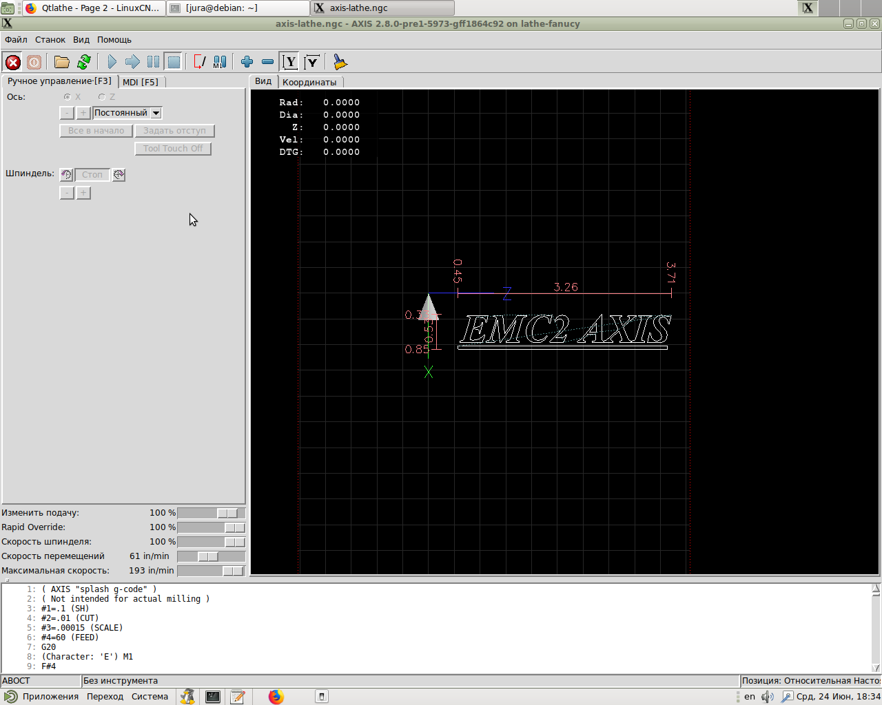

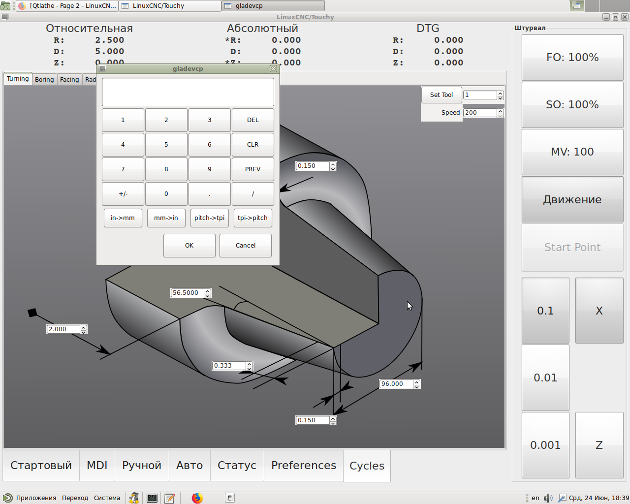

Thanks fixed. F5- removed. How to add mm / inс mapping with conversion of speed of movement.
Reload file do not need? Position DTG? It’s good to add to the mm / inc, inc / mm calculator.
Remove Shutdown at Start. Sim Panel for what?
