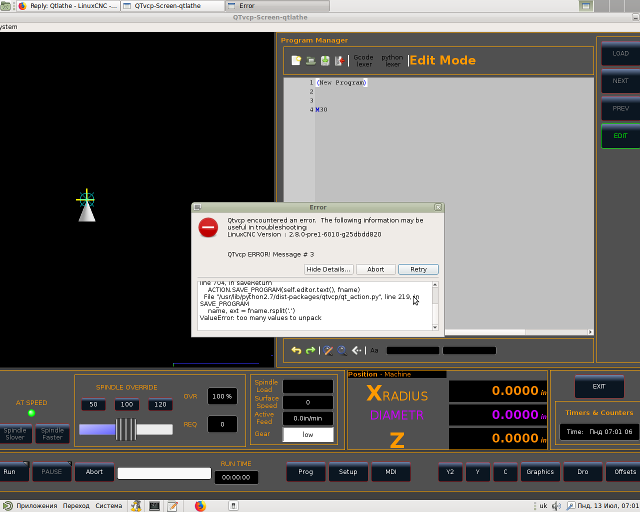

Replied by cmorley on topic Qtlathe

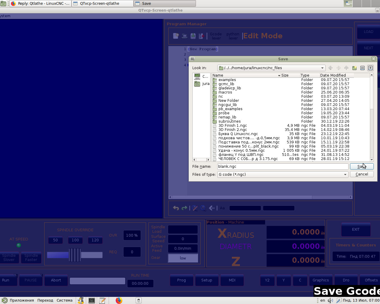

So looking at the code, it should pop up a save file path dialog.
Does it not pop this dialog?
- hottabich
- Posts: 574
- Thank you received: 96

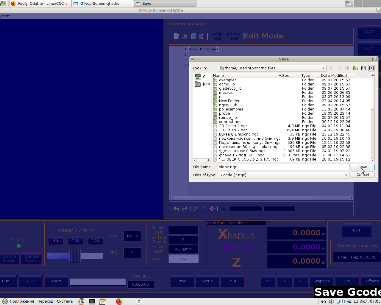

12 Jul 2020 23:12 - 12 Jul 2020 23:17 #174451
by hottabich
Replied by hottabich on topic Qtlathe

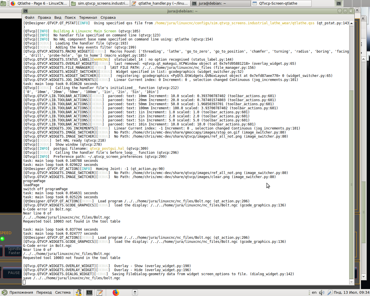

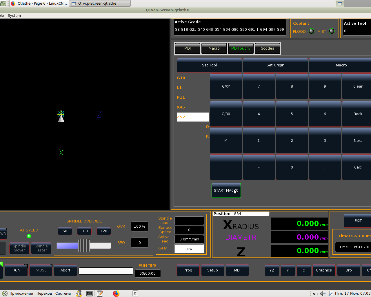

There is a path that is not correct as in the first screenshot and an error occurs — the second screenshot. It’s necessary as in the third screenshot. I have to edit the path in the dialog.
Last edit: 12 Jul 2020 23:17 by hottabich.

13 Jul 2020 00:52 #174461
add this to your handler file:
Then run from terminal and post what gets print when you save the file.
Chris

13 Jul 2020 01:42 #174471
by hottabich
Does not save.

13 Jul 2020 01:59 #174472
It wasn't supposed to save - it's only to give me information to debug.
Did you see there is a gcode error in your program?
tool 1003 is not in the tool table.
But the problem is the /../../ file path - I'll fix it tomorrow!
Chris

- Posts: 7368
- Thank you received: 2181
13 Jul 2020 22:35 #174575
I just push a change that should fix this problem.

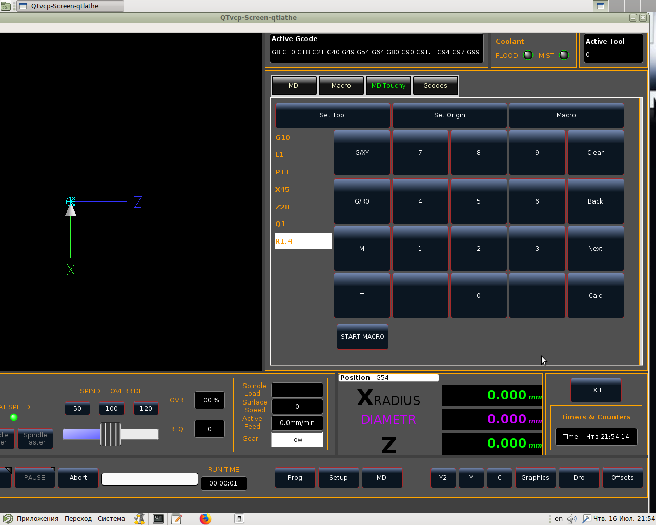

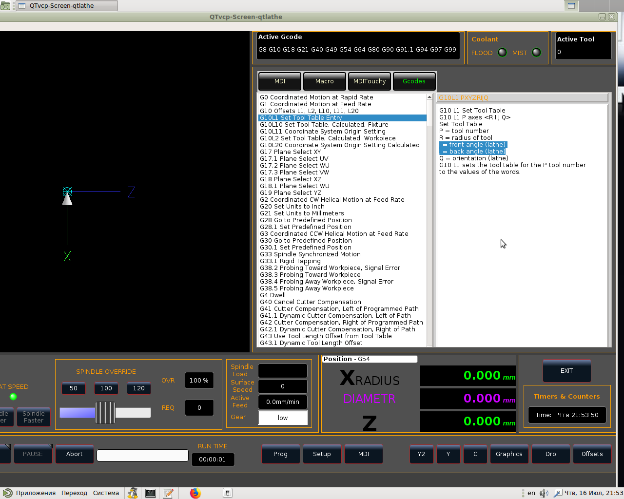

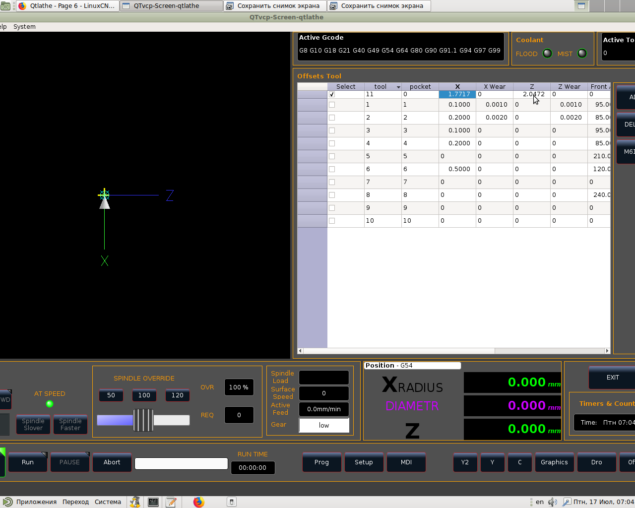

16 Jul 2020 14:05 - 16 Jul 2020 14:13 #174881
by hottabich
Thank! Gcode Editor Save. There was a question about Mdi Touchy. Set Tooll is not available for editing corners.The system is in metric units and edits in imperial units.
G10 L1 Set Tool Table
G10 L1 P axes <R I J Q>
Set Tool Table
P = tool number
R = radius of tool
I = front angle (lathe)
J = back angle (lathe)
Q = orientation (lathe)
G10 L1 sets the tool table for the P tool number
to the values of the words.
Last edit: 16 Jul 2020 14:13 by hottabich.
- Posts: 7368
16 Jul 2020 20:57 #174894
Ok IJ fixed.
Tell me more about the units problem please.
Chris

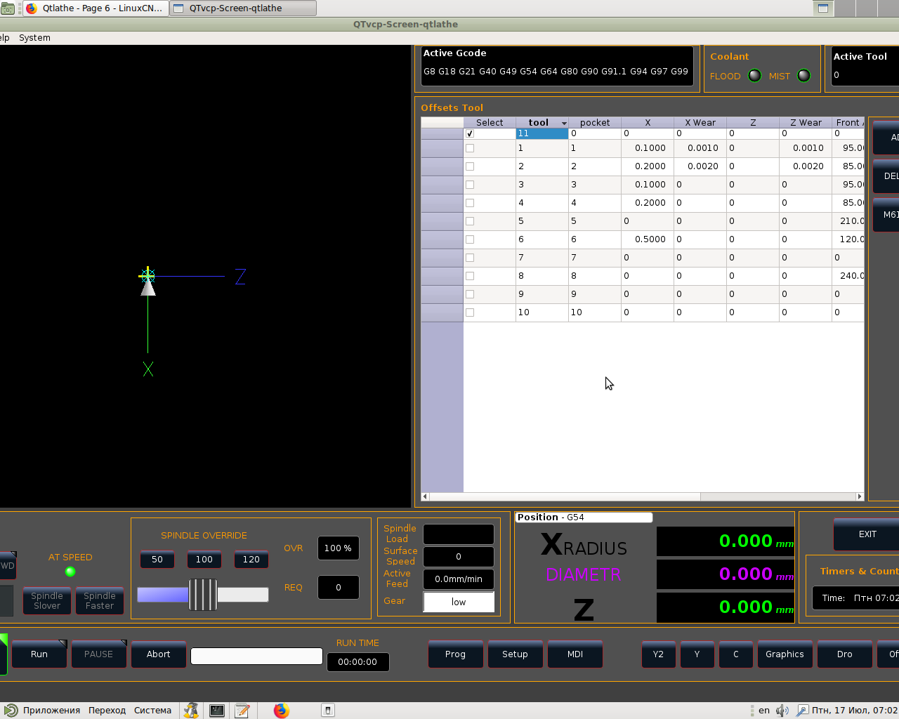

16 Jul 2020 23:14 - 16 Jul 2020 23:30 #174897
by hottabich
Thank. Set Origin displays conditional units works correctly. Set Tool mm => in converts mm to inches. Or maybe that's right?
Last edit: 16 Jul 2020 23:30 by hottabich.
- Posts: 7368
17 Jul 2020 01:24 #174901
Interestingly I looked at tool_offsetview.py and the code for metric mode change wasn't finished.
It always displays in machine units.
