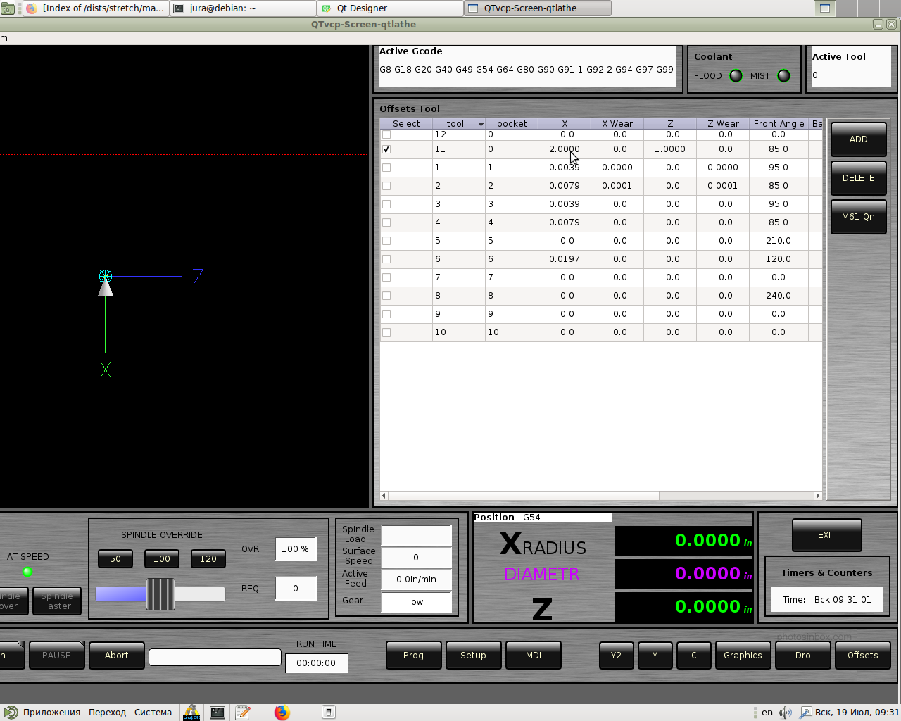

Ok I pushed a fix for tool_offsetview so it changes units displayed as per g20/21
I only pushed it to master so far as I like someone else to test it before I put it in 2.8

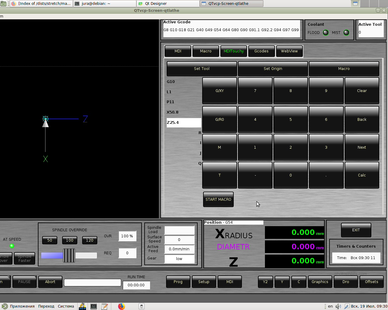

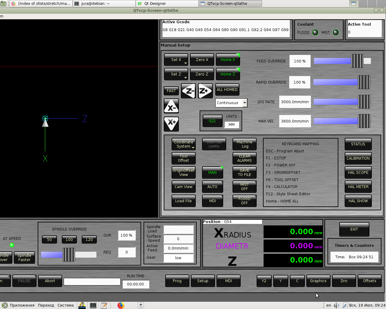

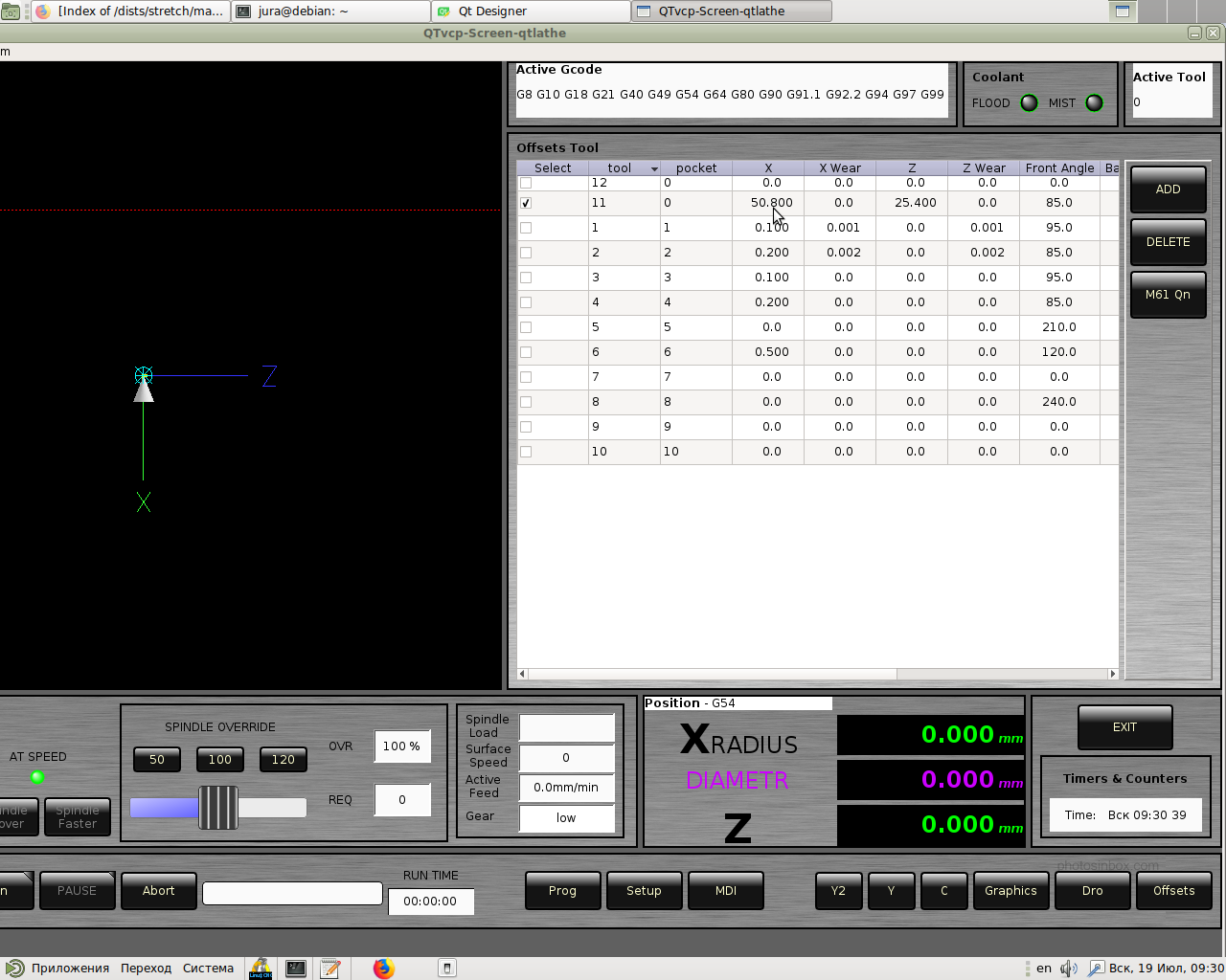

Thank! It works correctly. Checked in the metrics simulator. Offset Tool View is not displayed in the table radius. Here is the latest revision of the interface.

I will look into radius/diameter changes in tooloffsetview.
I suppose only X and X wear should change.
I probably should have an icon to show current mode.
Couple things I see on your screen:
active feed is in units per time - it should be units per revolution for lathes.
pick 'current-feedunit' in the status label (it's badly named)
There are two Icons for unhome X that display on the bottom left.
Chris

Thanks for the help. Should the icons at the bottom left with all homed be changed somehow? If yes what I am missing. I'm wrong about the radius. It seemed to me that in the offset tool, you can write the parameters of the new tool, and not just the offset. How can you create
new tool?
new tool?
- Posts: 7368
- Thank you received: 2181
20 Jul 2020 12:01 #175269
Replied by cmorley on topic Qtlathe
I have added the changes for radius/diameter for X tools.
It's in 2.8 but needs to be merged up to master but there are conflicts in unrelated code. Hopefully soon.
If you press the add tool button, a tool with number -99 pops up. Just edit that tool.
I think the icons on the bottom use a path only on my computer, so don;t show on your system. I'll see about what I can do there.

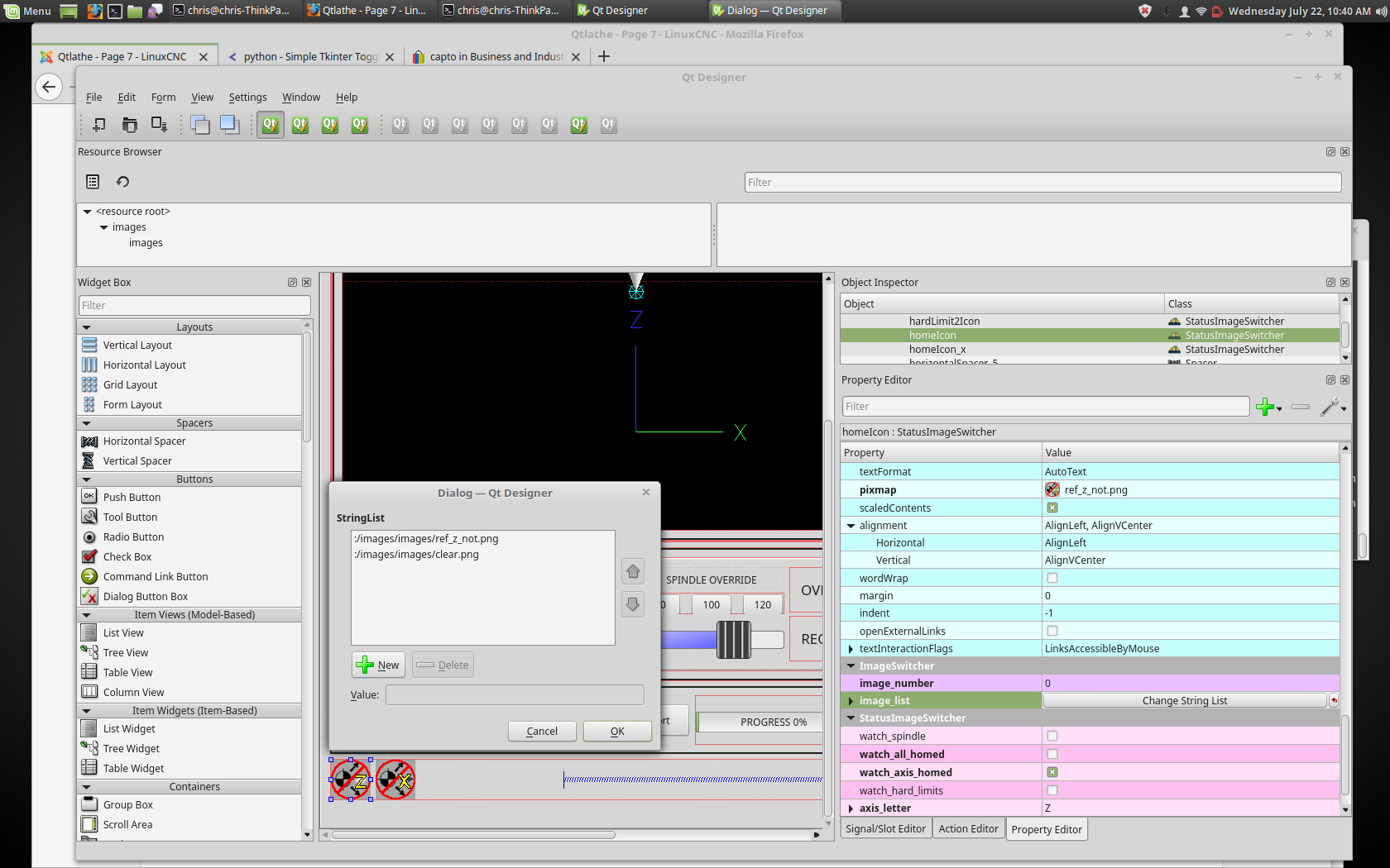

Status image switcher will switch between images based on linuxcnc states.
Here is an example:
In the properties section notice that:
'watch axis homed' is checked
'axis letter' is set to Z
if you double click the 'image list' a dialog will show and allow you to add image paths to.
if you have one image as an icon and one image as clear then that will look like it shows and hides the icon.
selecting image paths can be done by selecting the 'pixmap' property and selecting an image.
then right click the image name and you should see 'copy path'
click 'copy path'
now double click the 'image list' so the dialog shows.
click the new button
paste the image path in the entry box
Do that again for the next image.
You can test display the images from the image list by changing the 'image number' - in this case 0 is unhomed 1 would be homed
'watch spindle' would toggle between 3 images ( stop, fwd, revs)
'watch all homed' would toggle between 2 images ( not all homed, all homed)
'watch hard limits' would toggle between 2 images or one per joint
Here is an example:
click 'copy path'

Thanks for the detailed instructions. Works well now. I realized my mistake. I made one entry in the list of images, but the picture did not disappear. I changed a bit, added pictures instead of clean.png.
