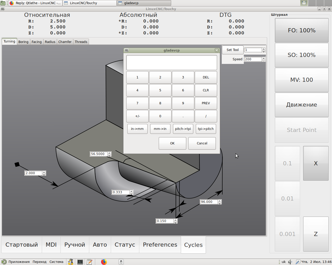

Thanks, it works! But the percent buttons (50. 100) override became inactive. Here is the keyboard code with unit conversion in the handler for Glade. Maybe it will help you in creating something similar in Qtvcp.

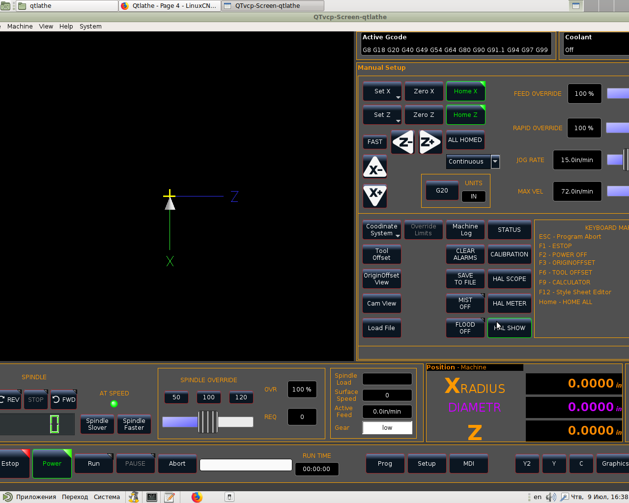

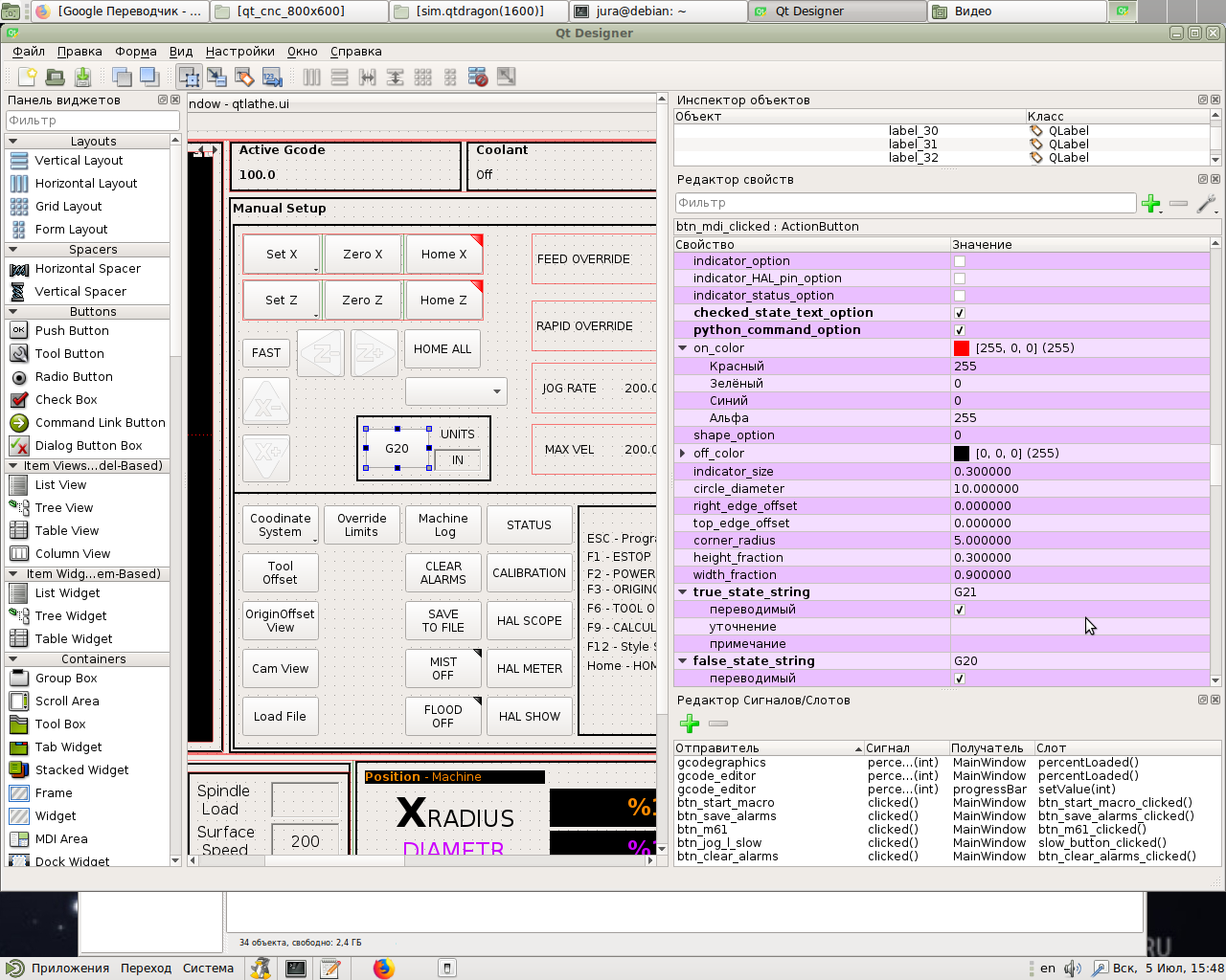

Hello! I apologize for the concern, but a question arose. I really want the G20 in G21 switch.
One button is like in the screenshot. If it's possible. Thank.

yes.
add a hal push button, set checked_state_text option true and set text for true and false state.
call it 'pushbutton_metric'
in the handler under _init_
under initialized__(self):
then add:
STATUS.connect("metric-mode-changed", lambda w, d: self.mode_changed(d))
STATUS.connect('state-off', lambda w: self.w.pushbutton_metric.setEnabled(False))
STATUS.connect('state-estop', lambda w: self.w.pushbutton_metric.setEnabled(False))
STATUS.connect('interp-idle', lambda w: self.w.pushbutton_metric.setEnabled(self.homed_on_test()))
STATUS.connect('interp-run', lambda w: self.w.pushbutton_metric.setEnabled(False))
STATUS.connect('all-homed', lambda w: self.w.pushbutton_metric.setEnabled(True))
STATUS.connect('not-all-homed', lambda w, data: self.w.pushbutton_metric.setEnabled(False))
self._block_signal = Falseunder initialized__(self):
self.w.pushbutton_metric.clicked[bool].connect(self.change_mode)then add:
# general functions #
def mode_changed(self,data):
self._block_signal = True
self.w.pushbutton_metric.setChecked(data)
# if using state labels option update the labels
if self.w.pushbutton_metric._state_text:
self.w.pushbutton_metric.setText(None)
def change_mode(self, data):
if self._block_signal: return
if data:
ACTION.CALL_MDI('G21')
else:
ACTION.CALL_MDI('G20')
def homed_on_test(self):
return (STATUS.machine_is_on()
and (STATUS.is_all_homed() or INFO.NO_HOME_REQUIRED))Please Log in or Create an account to join the conversation.

Thank! Everything works great. You are a real serpent tamer. Here is the interface with the latest improvements.

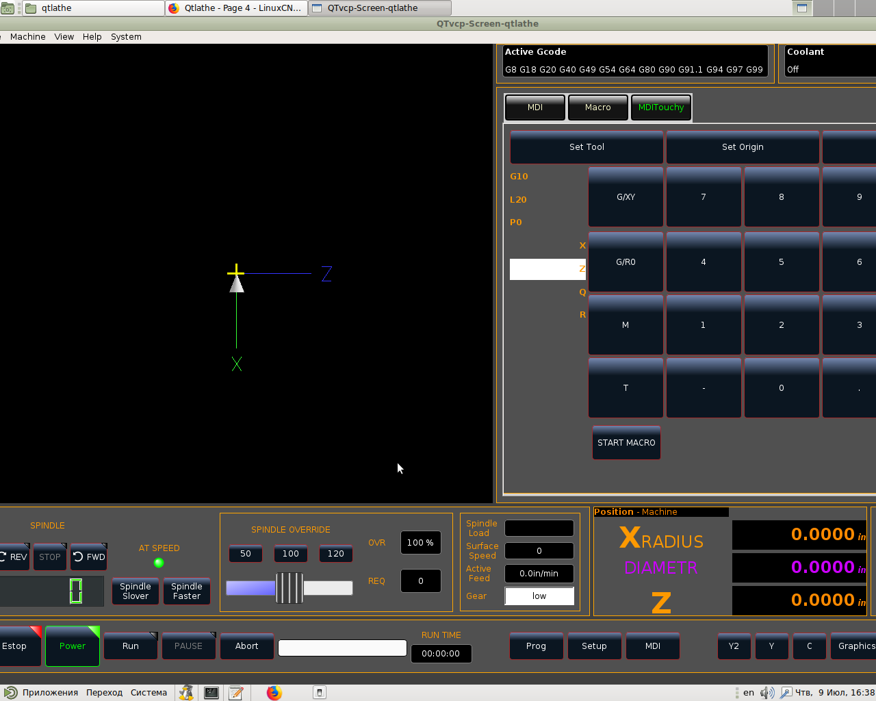

Thank. I wanted to bi comments and suggestions turners. Did you use the latest edition? I edited several times. Wee removed Active Feed and Mdi Touchy seems so prettier to me. But your right as you wish.How to fix
when switching G21-Coolant on, G20-Coolant off so that it does not change?

Thanks and so good. With the pictures it seems to be enough, but with the macros some questions. By default, none work. But I have to learn this. It will take a lot of time. I think the macro should work both in the metric system and in the imperial system. Also be able to edit gcod in the gcode editor or write manually.
