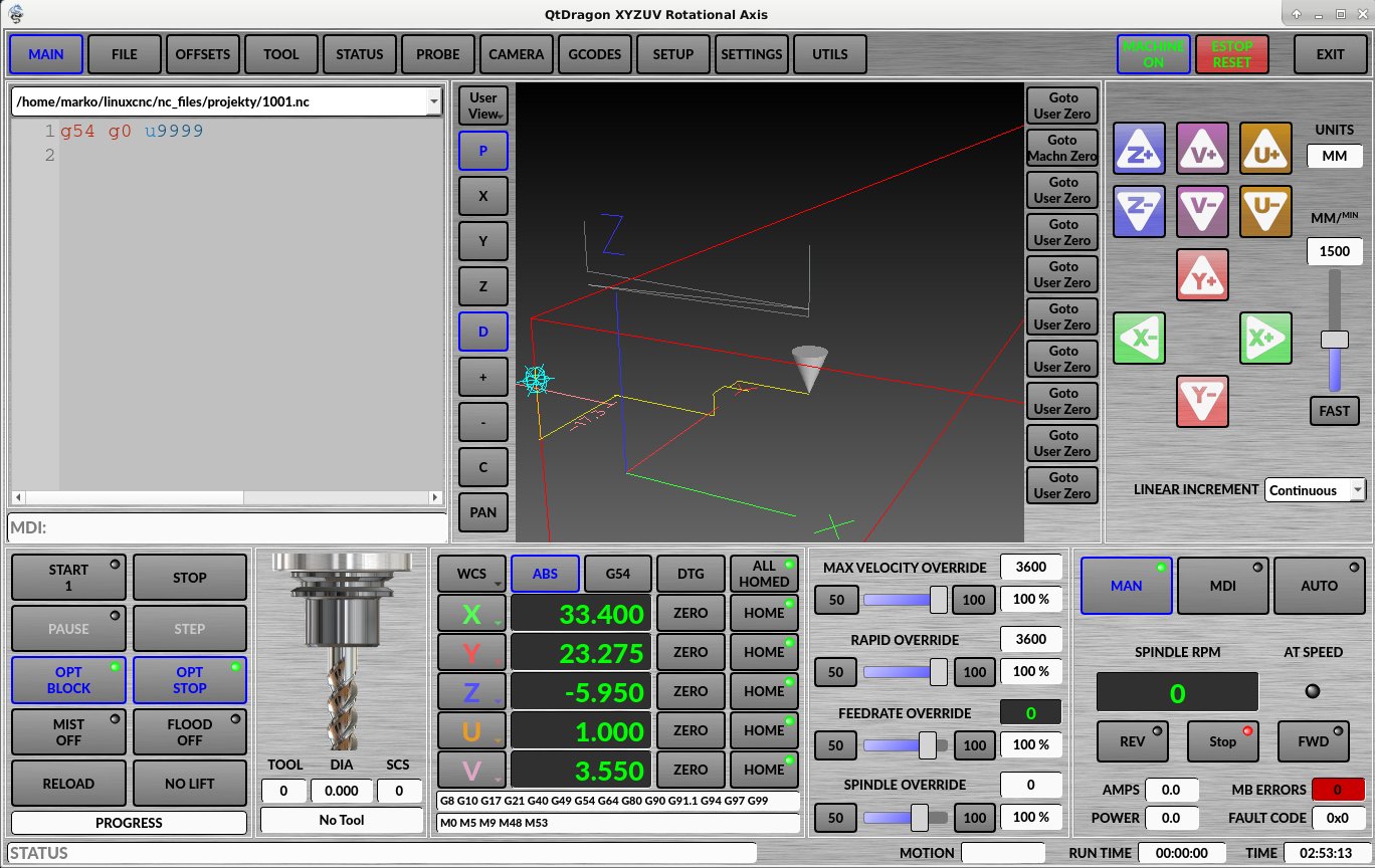

20 Apr 2024 13:10 #298724
by MarkoPolo
Replied by MarkoPolo on topic Error in tool_offsetview.py
QtDragon reworked, improved.Everything seems to be working properly, but test it again.Marek

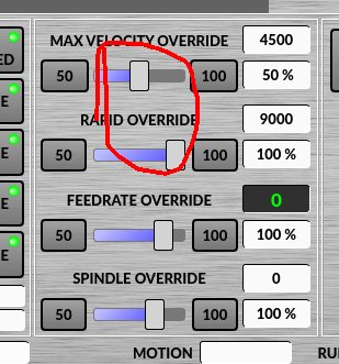

- MarkoPolo
- Posts: 319
- Thank you received: 90
24 Apr 2024 11:51 #298988
by MarkoPolo
It's nice that the changes are good.
I don't have MPG in my machine, but if I need to test something, my brother has it in his machine, I can borrow it.
If similar changes need to be made to qtdragon_hd, I can do so, just let me know.
Another thing is whether you could add the default settings for the "max velocity overide" and "rapid override" sliders to the ini. I would like them not to set to 100% after starting (as in the screenshot).
I added "self.w.slider_maxv_ovr.setValue("4500")" to the support file in the machine directory, as you usually suggest in similar cases. This works fine for me, but it would be nice if it could be set from the ini file.

Replied by cmorley on topic Error in tool_offsetview.py
When you pick up the last pushed work (your layout) then let me know I'll post some files to try.
I can add INI defaults for rapid and max override.

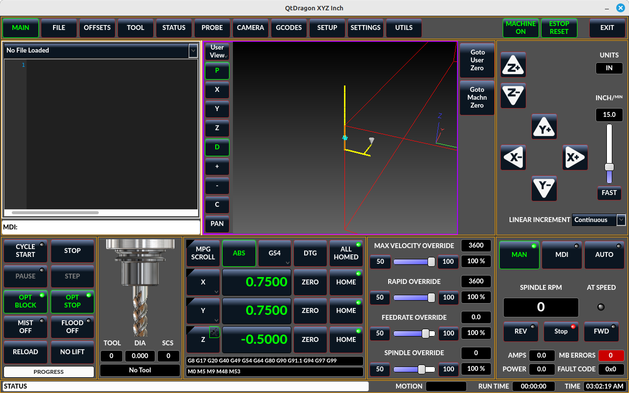

- Posts: 7368
- Thank you received: 2181
25 Apr 2024 08:59 #299053
Ok here is a rough test. Put this qtdragon folder in your configfolder/qtvcp/screens/
There will be a new HAL pin 'qtdragon.mpg-in' connect that to an MPG S32 output pin.
Set the styleesheet for the _local_ 'qtdragon.qss' or ''brushed_metal_color.qss'
They have been modified a bit for some added hints.
Notice there is a new button near the AXIS buttons to select 'scrolling'
Now click on the gcode editor, gcode display, file managers, or override sliders.
Should get a colored border that moves to each selected (listed above) object.
If the scroll button is selected then moving the MPG will scroll/move the selected object.
In the gcode display you can select pan or rotate with the existing button.
Still rough but let me know what you think.
also interested in your opinion of the axis buttons menu buttons.
X Y and user coordinates use the press and hold
Z use a little icon for the menu.
Chris
Chris
