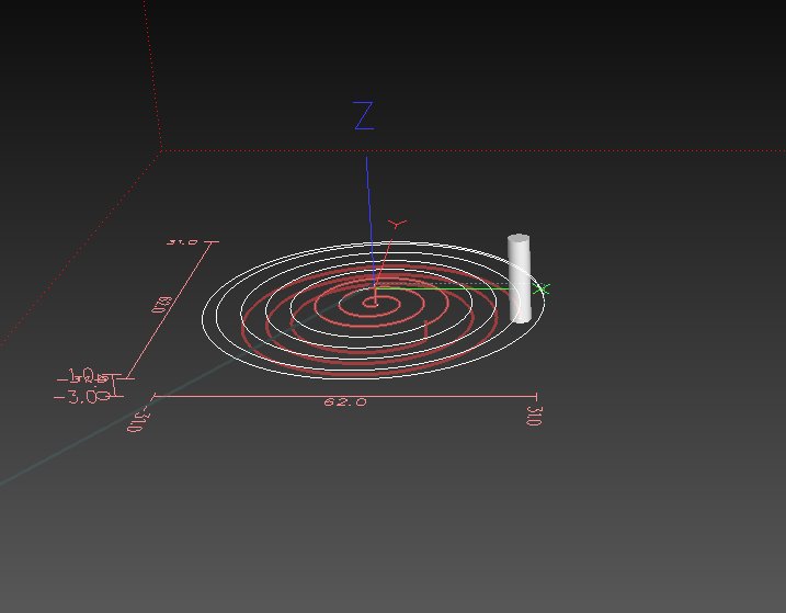

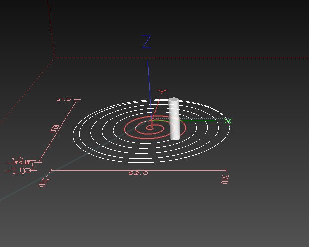

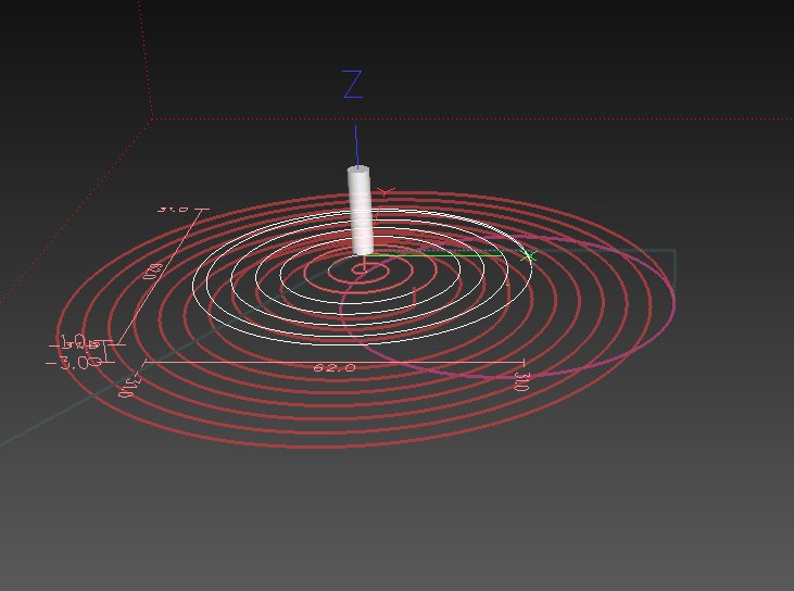

I don't know enough about gcode to give any advice, but it's as if the X0 Y0 lines were skipped.In the first picture is what it is supposed to do, stop, start, and it makes holes bigger and bigger because it doesn't start at x0 y0
(pictures should be in reverse order)

I see the problem G91 is left over if you abort (if you don't have abort automatically reset G90.
It seems to work reliably if I add G90 in the beginning.

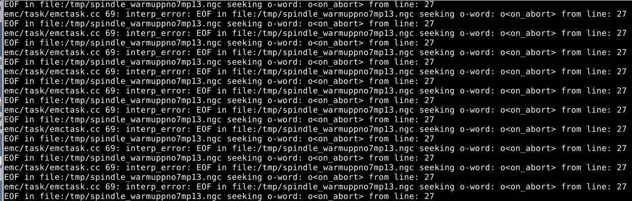

If it stops working on the stop button, I see a log in the console, as in the screenshot. I suppose it's nothing important.

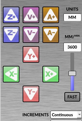

I also reworked the icons for the A axis, I think it will be better for the consistency of the appearance of the buttons
