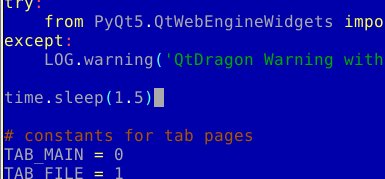

After the last changes, the error does not appear, but the speed sliders are set to zero.
The only solution I have found so far is to delay the launch of qtdragon. A delay of 1.5 seconds solves the problem.
The only downside is that qtdragon takes 1.5 seconds longer to start, but it's not a big problem.
I think it could be used as a temporary solution.

Yes, I use master. This solution using time.sleep(1.5) works very well. Maybe it will be useful to someone until the problem you are reporting on is resolved.

I just pushed a commit that should take care of this race condition. Feel free to remove the sleeps you've added to the handler, etc. and give it a try. Let me know if you see any issues.

Yes, now after updating to the latest version it works properly, without the need to delay GUI loading.
