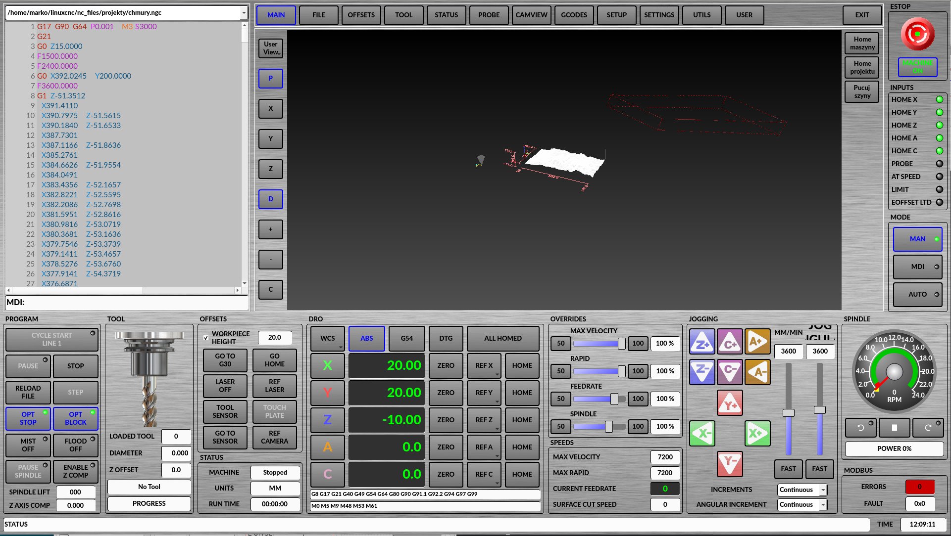

It's a lot of work, but if there is interest, I can of course work on it.
Meanwhile, I made a new status bar to make it look good, this required minor modifications to the handler file. I tested it, everything works, but it will be nice if someone else tests it on a full HD screen.

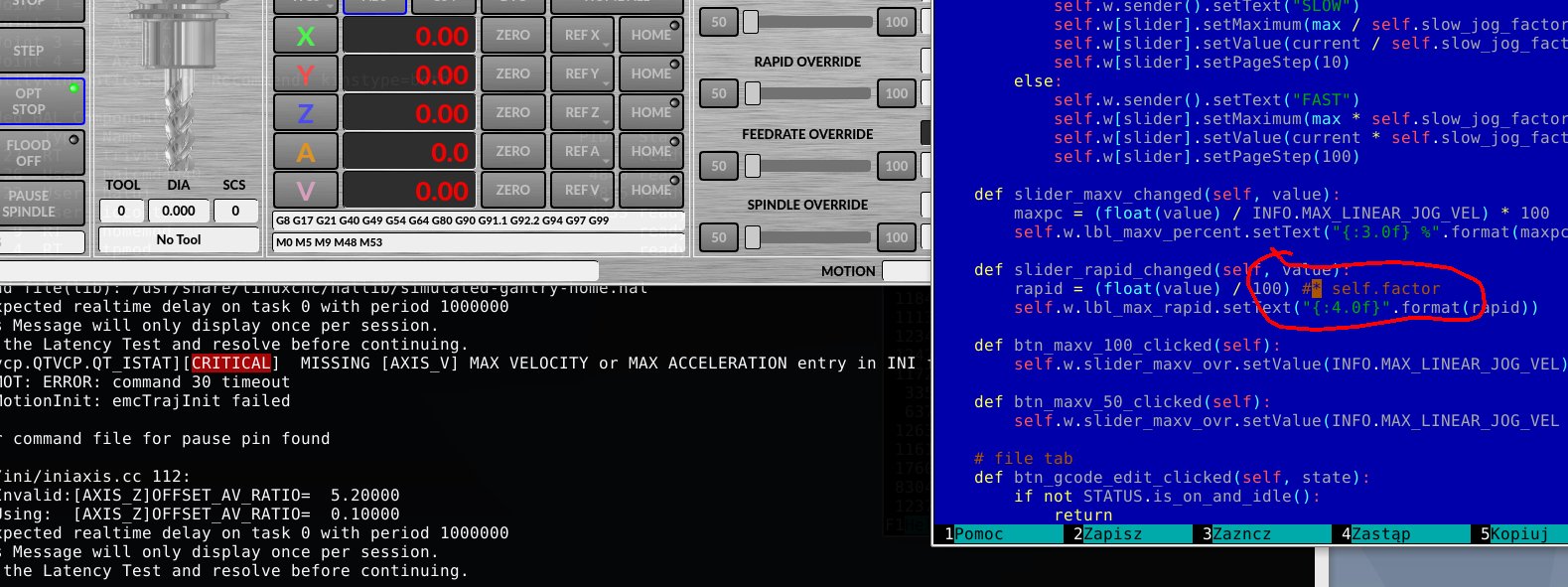

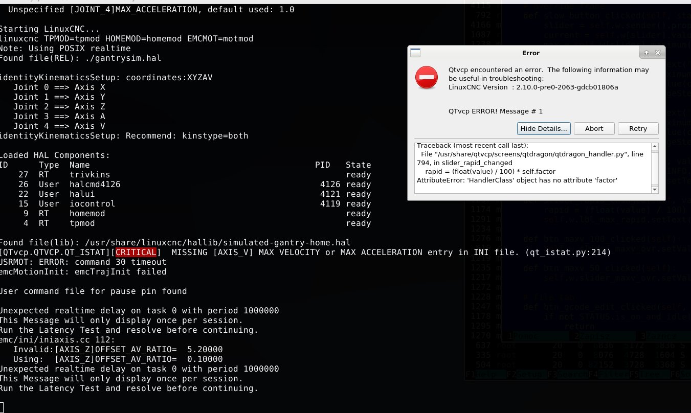

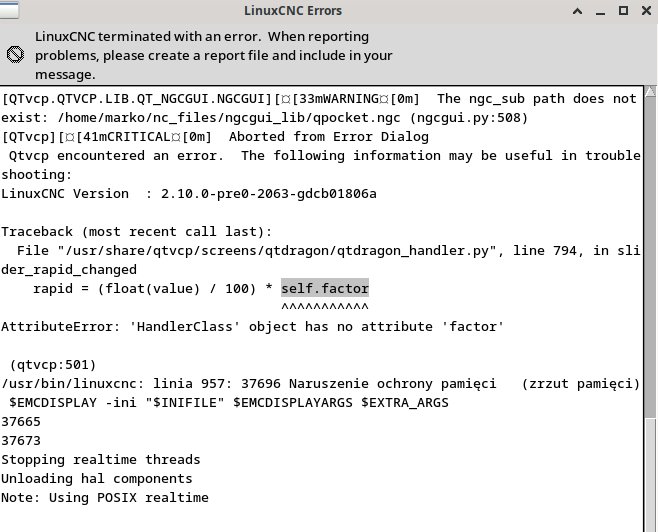

01 Oct 2023 11:48 #281978
by MarkoPolo
Replied by MarkoPolo on topic Error in tool_offsetview.py
- Posts: 7368
- Thank you received: 2181
01 Oct 2023 16:34 #281997
Replied by cmorley on topic Error in tool_offsetview.py
Can you run from a terminal and see if there is other info. That's not the true error.
- MarkoPolo
- Posts: 319
- Thank you received: 90
01 Oct 2023 20:10 #282020
by MarkoPolo

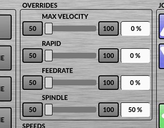

If I comment out self.factor, qtdragon will start normally, but then of course the "rapid iverride" value is displayed incorrectly.
Another change I noticed is that after starting qtdragon, all speed setting sliders are set to zero.
- Posts: 7368
01 Oct 2023 23:25 #282036
I promise, the self.factor is not the real problem.
Looks like emc motion module failed to load.
Master had some work pushed lately that creates race conditions.
I bet this is related.
I believe Rene has got a tested fix.
github.com/LinuxCNC/linuxcnc/commit/7ebe...mitcomment-128862189

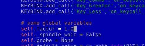

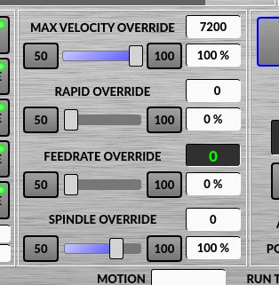

Someone asked for it from the forum, so I corrected the qtdragon_hd themes because the 4th and 5th axis looked bad. I also enlarged the macro buttons vertically and made minor corrections to the status bar at the bottom of the window.
As for the error I wrote about in the previous post, I agree that it is not qtdragon's problem, when I press "retry", qtdragon starts, apparently it lacks access to some pins and needs a little delay. In qtdragon_hd this error does not occur because the service file has the declared value "self.factor = 1.0" at the beginning, but after running all 4 sliders are set to zero, in qtdragon only 2 sliders are set to zero, as in the screenshot .
