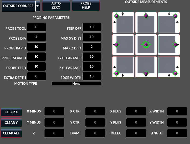

29 May 2023 06:19 #272402
by grey_goat
Replied by grey_goat on topic qt_dragon_hd - manual tool change and remap
I've tried tapping it as quickly as I physically can. It immediately triggers, "probe tripped in non-probe move." I don't know why the errors changed, but they did when I changed the settings.
Can you please explain further, "You can use the motion type label in the probe tab to know when to touch the probe." Right now I'm pressing it once the spindle has gone to the tool setter position and starts to move in the negative z direction. I've tried at multiple points during the descent.
Is this something to do with the remap? I'm just following the documentation here:
linuxcnc.org/docs/devel/html/gui/qtdragon.html
- Posts: 7368
- Thank you received: 2181
29 May 2023 06:42 #272405
Replied by cmorley on topic qt_dragon_hd - manual tool change and remap
depending on how old of a version you have there is a label on the probe screen 'motion type'
It will say 'probe' when linuxcnc is expecting a probe signal.
You can also load a similar temporary display panel by adding to the INI:
Just don't try to use the button on that panel as you have already connected the motion.probe-in pin to something else, but it will display the motion type.

This is really weird. I don't believe I changed anything besides adding that [HAL]
POSTGUI_HALCMD = loadusr qtvcp test_probe into the INI file.
Now I no longer get movement to the toolsetter position or movement in the negative z direction where the tool setter is supposed to sit. Instead I get, "Auto Tool probe disabled," and the machine ceases to move.
Just as a side note, when I press the probe the green light in the probe window lights up. Also, the version of LinuxCNC I'm using is 2.9.0~pre1.787.g913733ff1

When heading towards the toolsetter in the negative z the motion type is, "feed."
