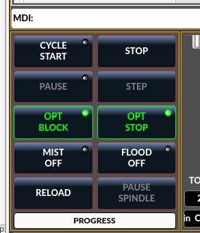

Is there a guide on how to use the step through feature in the MDI window? I'm wondering if I have to put in special comments or something.

What do you mean by step through in MDI?

By stepping through the MDI, I'm probably naming things wrong...
I meant in this part of the interface, it looks like I should be able, after I load a file from disk with g-code or ngc code, etc, to press Cycle Start but have some control to prevent it from immediately processing all the way to the end...
IE, those 'greyed out' Pause and Step buttons... how do I use them?
