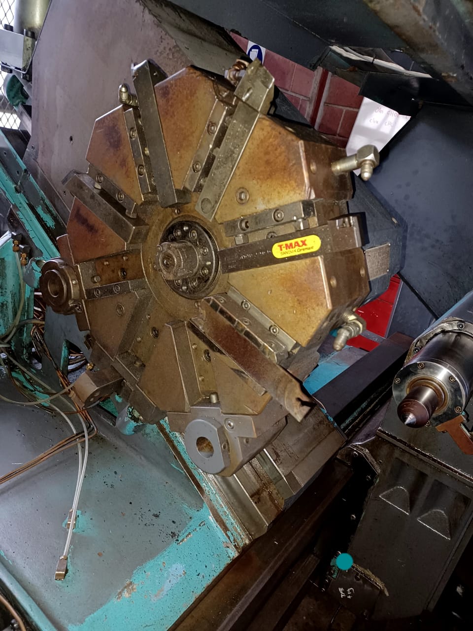

I am almost done with the machine .I am currently stuck on the automatic tool changer . It has an 8 tool drum turret that uses pneumatics to clamp and unclamp and an ac motor that turns the turret in both directions .It also uses 3 proximity sensors on an encoder wheel to detect the 8 different tool positions .
At this stage I have connected all of the original inputs and outputs associated with the ATC.

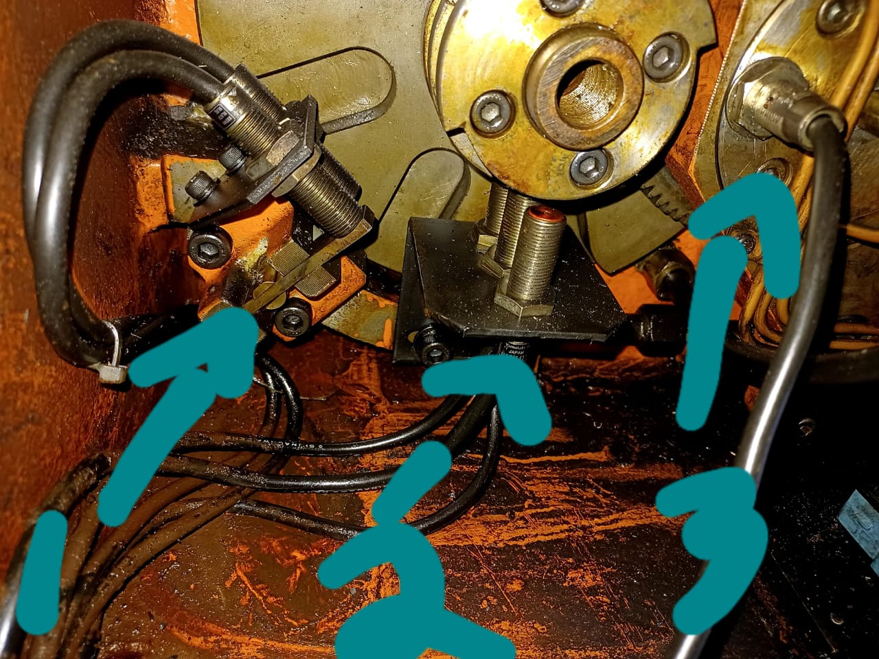

I have made 8 Classicladder outputs that work with the tool position sensors as inputs and managed to get all 8 tool position signals to work .I have manually tested each input and output with Hal component and everything works individually. I am not sure what to do next .I saw you used the Emcochanger component . Will that work on my machine ? If so ,what do I need to do to implement it on the machine . What inputs and outputs do I need to use and where do I do this ? I don't have much knowledge or experience with Hal or Classicladder .
I attached images of the ATC mechanism.
The subscripts are as follows:
1-Tool clamp and unclamp position sensors.
2-Tool position sensors 1-3
3-Index sensor
3-Index sensor

Have you looked at
emcochanger.comp
and
emcochanger.hal
attached in the second post on this topic?
It can be edited to most toolchangers, it is very simple and never fails.
Or have a look at carousel component included with LinuxCNC, might be even easier as there is no compiling.
emcochanger.comp
and
emcochanger.hal
